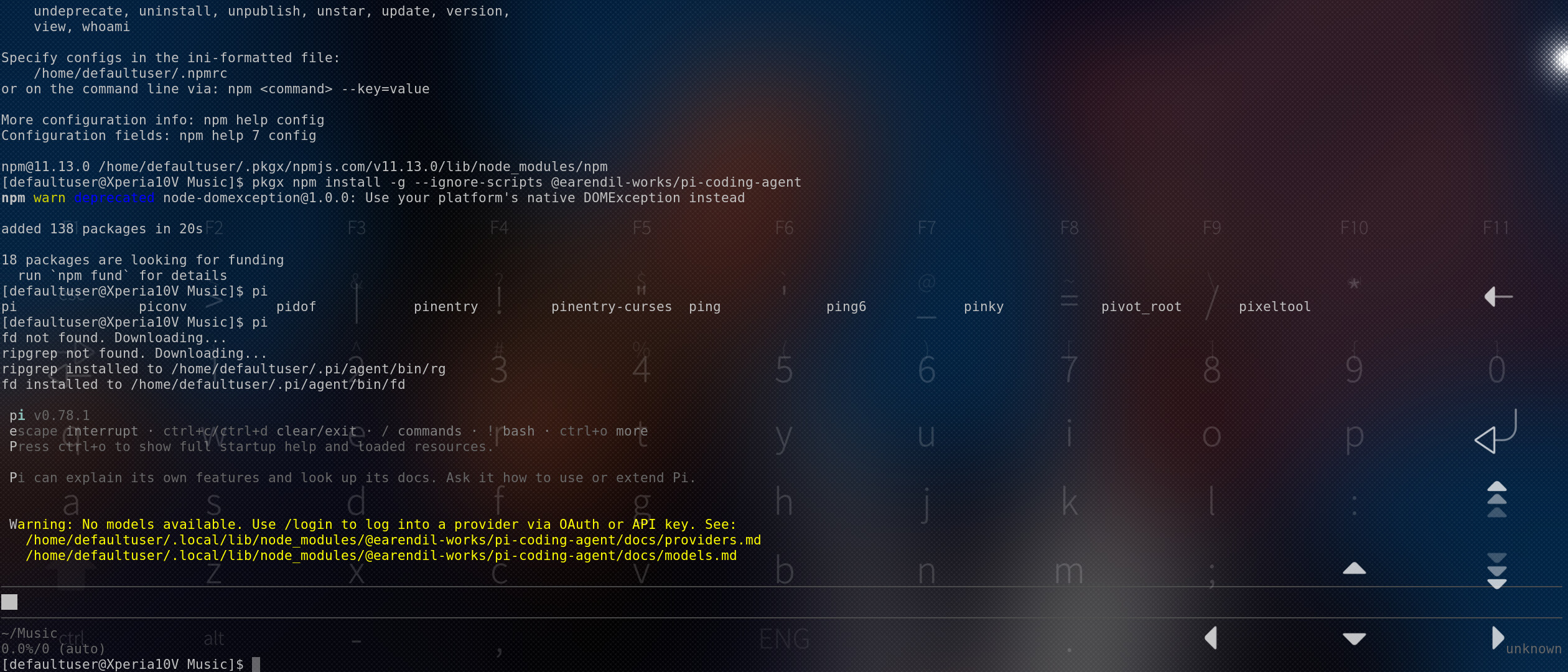

And pi does work on phone, so you can have ‘local’ (on your desktop/laptop) glm4.7-flash and serve it over wlan to have agent go wild on your phone, sms sending skill should be easy, why buy mac mini for open claw when you can get same thing natively on sfos

Edit2: I had pi create two skills for itself based on silica reference documentation, it wrestled with curl and grep for a bit but did create something that looks useful, will paste later, maybe can be useful for others, or might be worth giving that task to a sota model, but with pi running on device a much simpler skill would be to just grep /usr/share/harbour* for actual examples of how each silica component is used in real life and go from there
edit3: sailfish-silica skill.md it cooked
