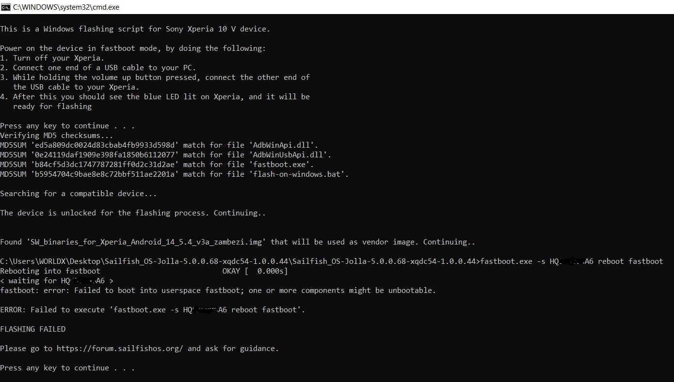

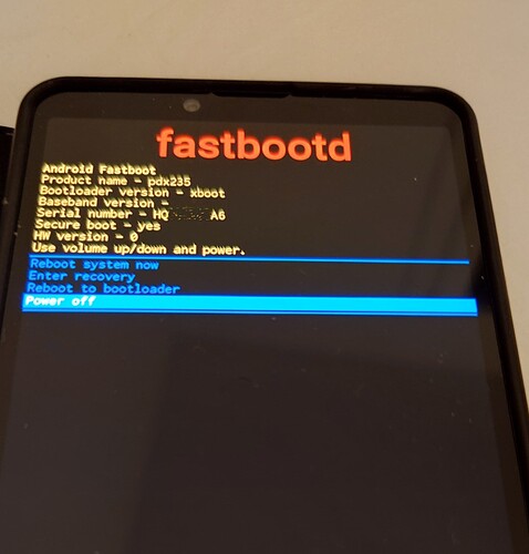

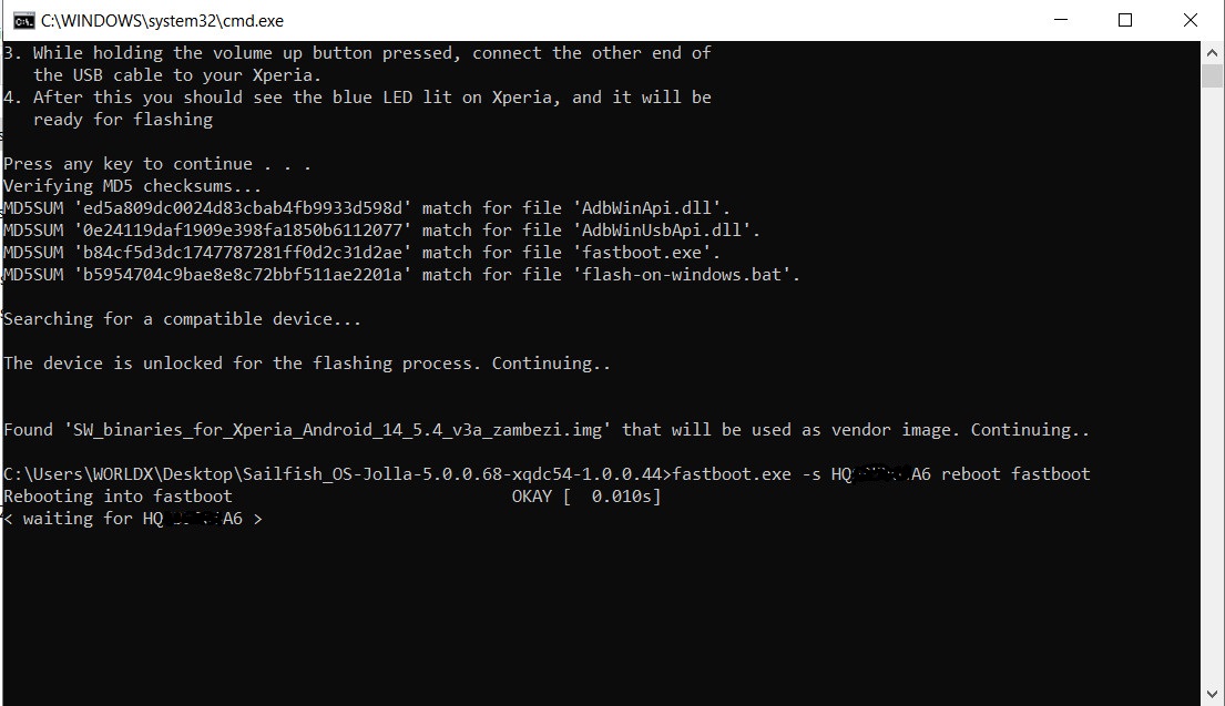

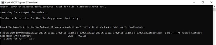

My attempt at flashing Sailfish 5.0 on Sony Xperia 10 V model pdx235 with an unlocked bootloader failed. The flashing process hangs at the stage “waiting for HQ…” ; the serial identification of the phone. Waiting for the flashing to proceed, the blue led turns off and the fastbootd menu is displayed on the phone with the option “reboot system now” highlighted. Waiting longer without executing any function automatically boots the phone into Android. If I try to switch off the phone, unplug it and then re-plug it with the blue led back on, the following message is displayed:
fastboot: error: Failed to boot into userspace fastboot; one or more components might be unbootable
Error: Failed to execute ‘fastboot.exe -s HQ…A6 reboot fastboot’
Flashing Failed

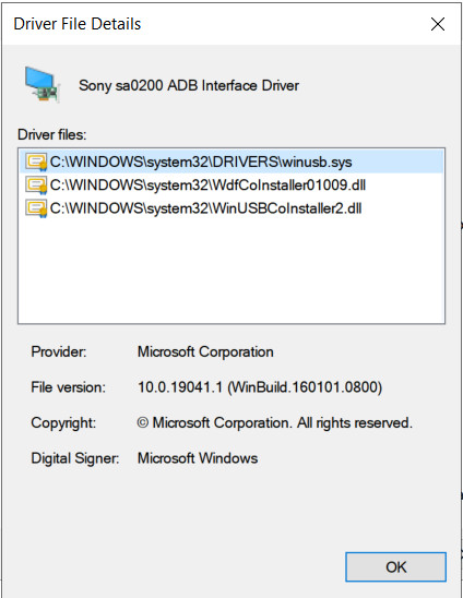

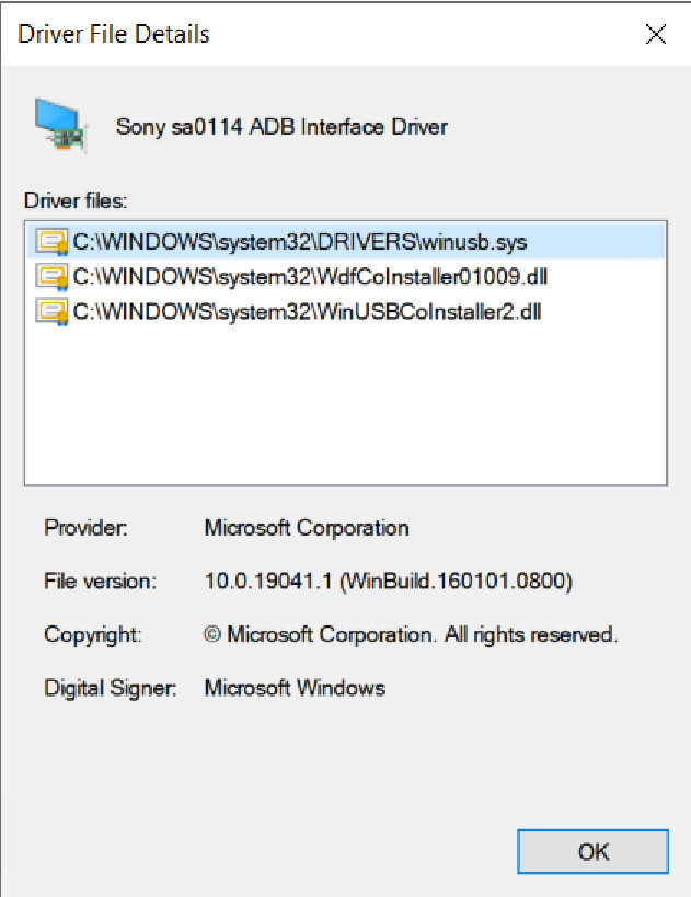

Update its driver to sa0200 or sa0114; the USB driver you originally installed for Sony Xperia 10 V
The flashing with Sailfish will resume. Special thanks to “rgrnetalk” for this solution.
