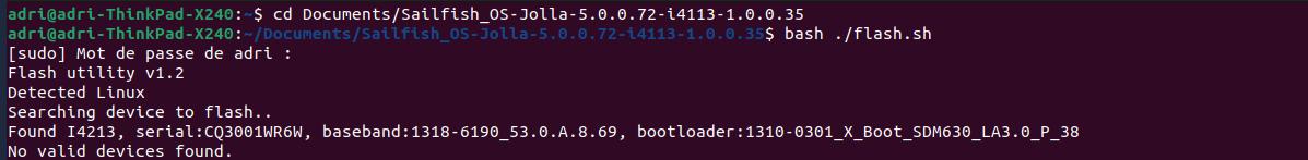

Finally, when I plugged the phone (with the blue light activated) and wrote the formula to flash Sailfish X in the Terminal, it didn’t work (picture 3).
I don’t understand what I did wrong, but maybe I forgot something… Can somebody help?

It’s a common error :frowning:
Try with an USB 2.0 port
Thank you very much for your super fast reply. I tried on both ports of my computer, without success… By USB Port, you mean a cable or another computer?
Oh, both. Some USB cable do only charging. Did you try with a USB-hub ?
I tried with the cable I got from the phone. I’ll try! And let you know.
Thank you again!

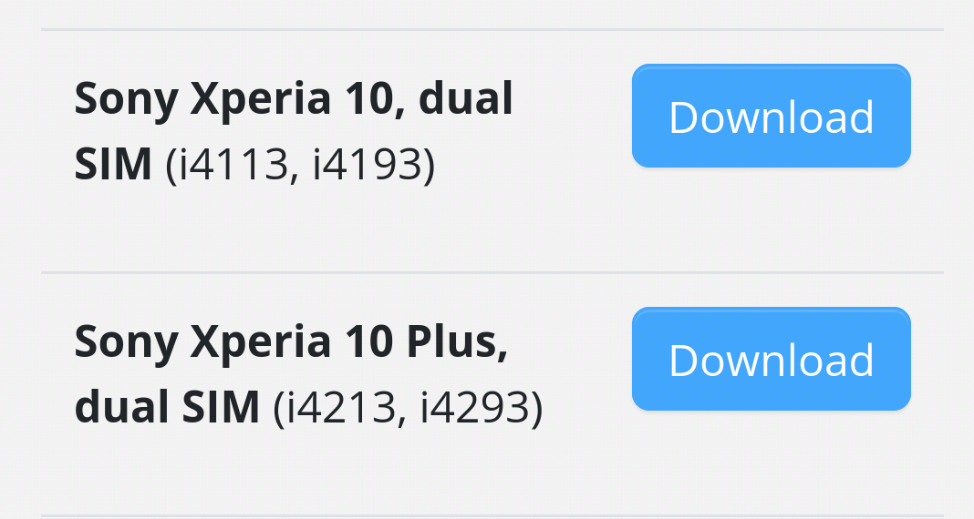

You have an i4213.

Argh! I knew there should something like this. Thank you very much for your observation!
This may work much better. :slight_smile:
