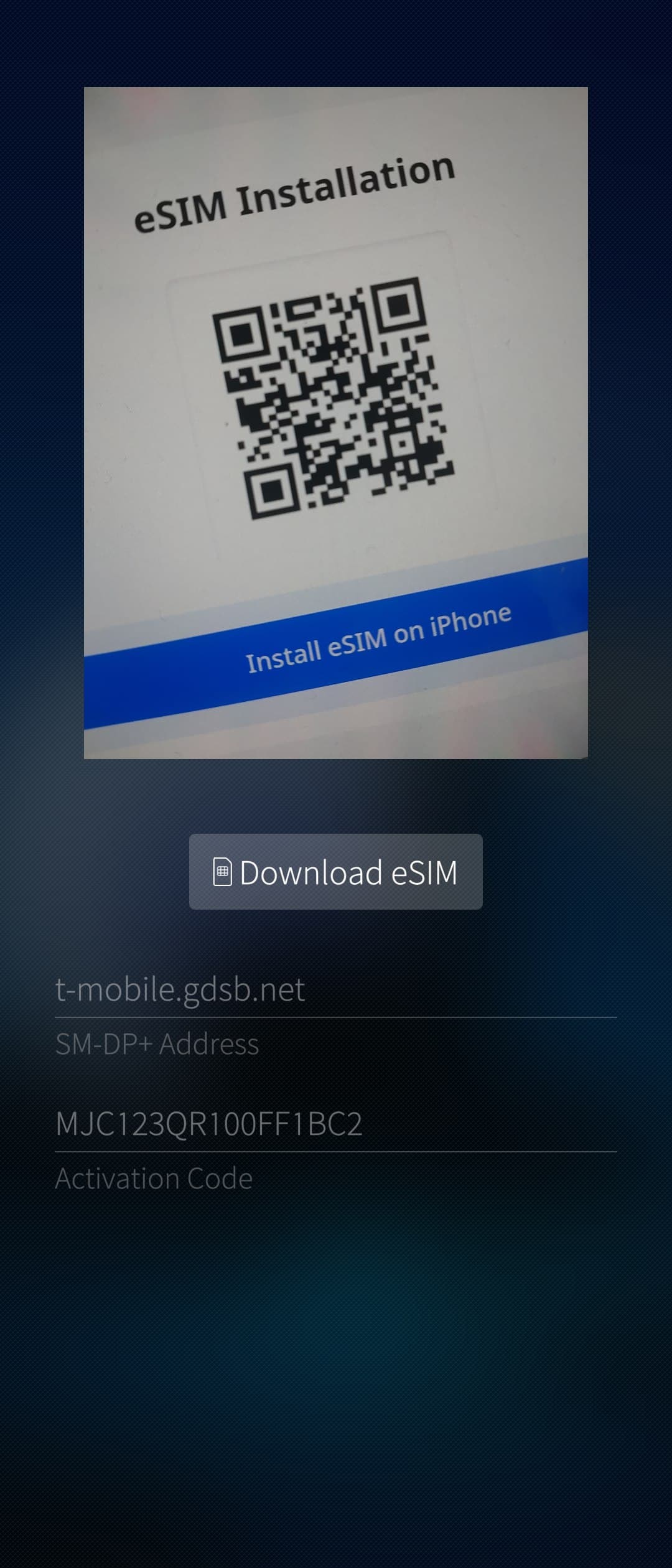

I’ve bought a 30 day eSIM for testing and successfully downloaded a profile.
After a reboot the phone was able to use it like a normal SIM card.
Thank you again for providing the binary!
Now I have 30 days to write a SIM-Manager app before the card runs out :slight_smile:

Great! I was able to test it with https://www.firsty.app/es, which offers a “free” service, and it also worked well, in case anyone wants to test it without having to purchase a service.
you can get a free esim profile anytime on ‘better roaming’

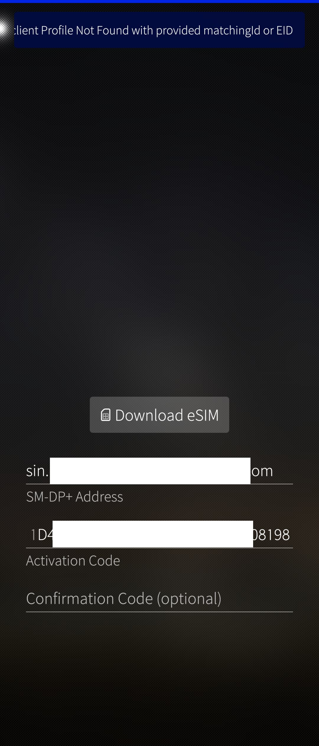

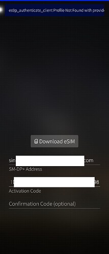

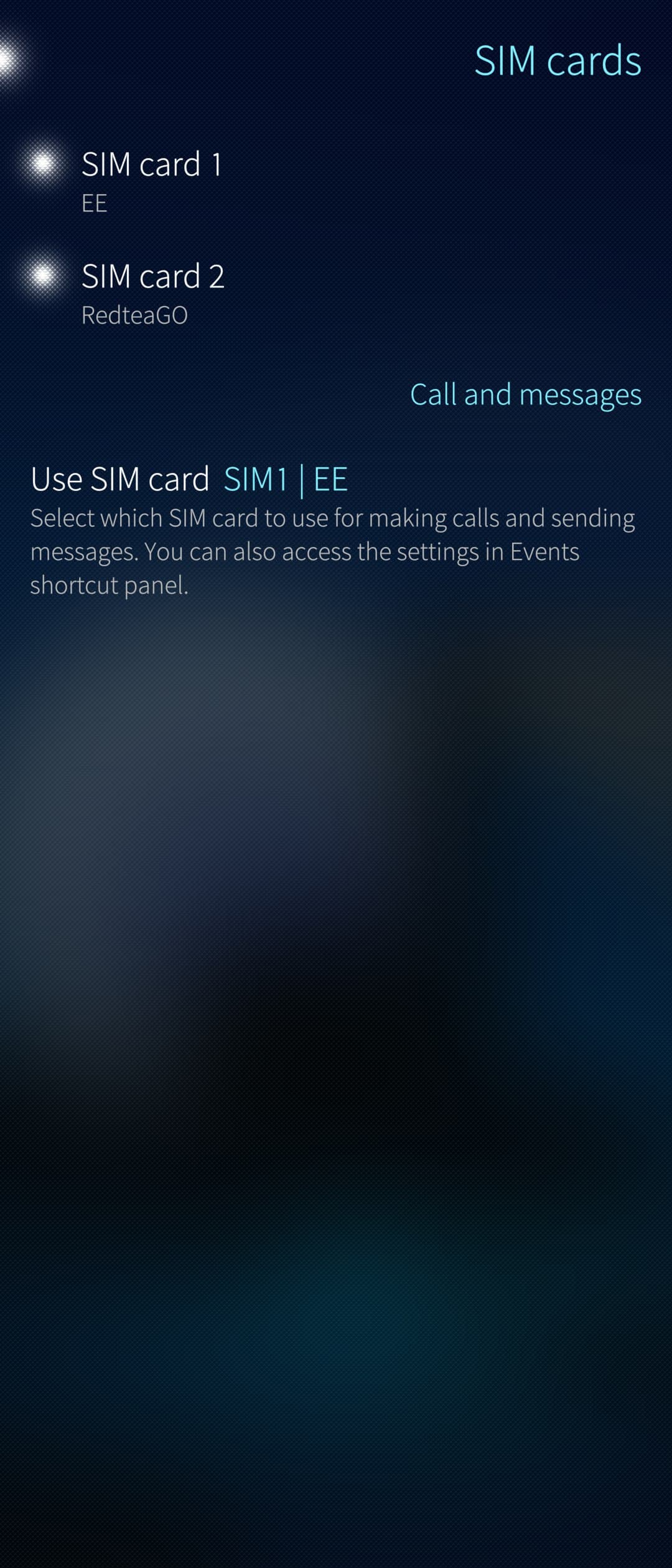

Good job I bought an esim on the web for Morocco. but failed to download it. On Xperia 10 v. It’s an esim for the holidays I would try in another country. The next time
if I understood correctly the app can be installed on a 10 III
I gave my Xperia 10 V away, so I can’t test whether it also works with the internal eSIM chip.
The Xperia 10 III has no built-in eSIM chip, so you have to use an external eSIM adapter.
I’ve tested it on the Xperia 10 III with this one:
I tried OpenRepos SimPro to manually download Eskimo eSIM Now that you received your 9esim card, treat yourself to some free data – 9eSIM (We all know about the problems with the Xperia 10 V camera in Sailfish not working.), but I get an error:
From command-line I can dowload it fine:

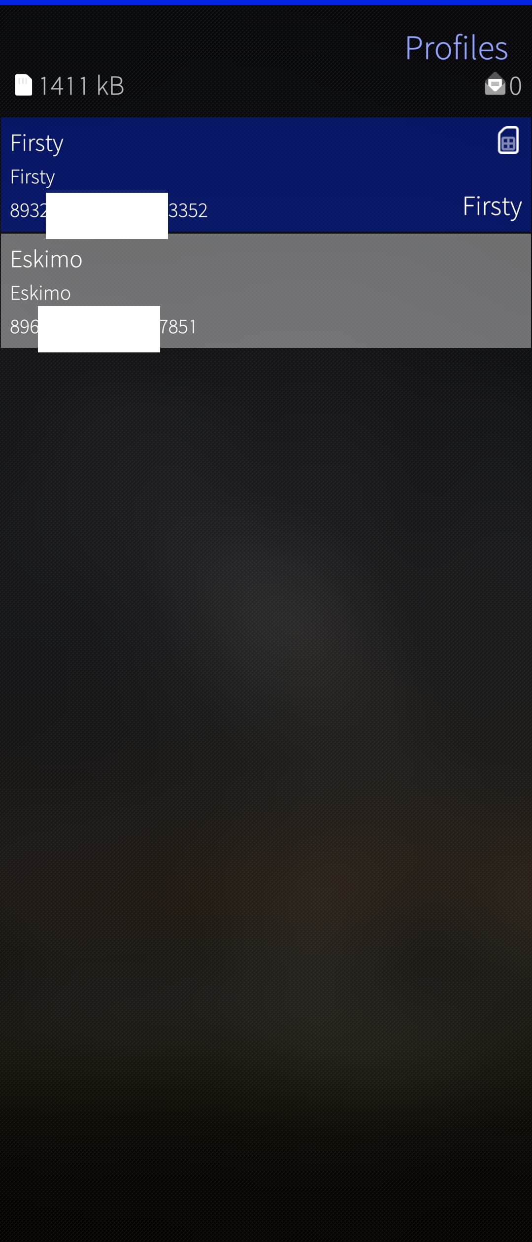

[15:59:17] defaultuser@Xperia10V:~ ☭LPAC_APDU=gbinder lpac profile list | jq .

Then I can see them correctly in SimPro. To activate it, it works fine from the edit menu, but it doesn’t activate from the drop-down menu.
Download and activation should be fixed in version 0.2.
I’ve tested it with two new manually added profiles, it seems to work fine now.
Out of curiosity, does the 9esim adapter work as on the 2nd sim slot? So that you could have your main sim at slot 1 and esim adapter at slot 2 which you could then get plan when you go abroad etc?
Yes, it does. I have one in my second SIM slot of an Xperia 10 III right now.
