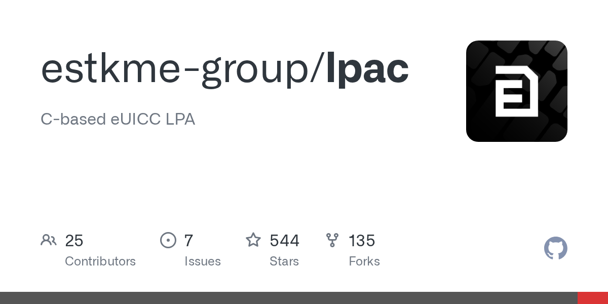

I wonder if one could compile lpac for Sailfish:

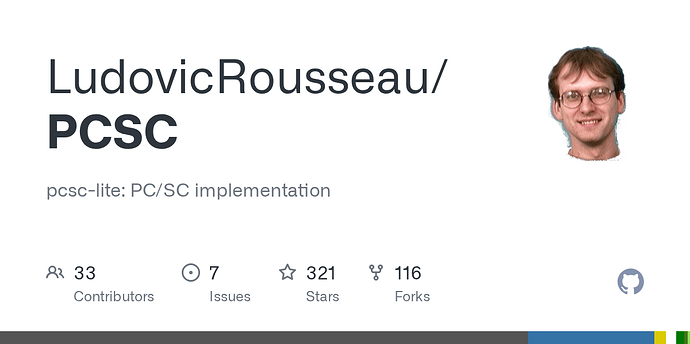

PCSC Lite, one of the dependencies of lpac, seems to be already available for Sailfish:
 libpcsclite1-1.8.10-1.1.1.bso.aarch64  PC/SC Smart Card Library
 pcsc-lite-1.8.10-1.1.1.bso.aarch64     PC/SC Smart Cards Library
Someone already did: eSIM and Sailfish OS - #36 by tvall
Thank you. It was a bit hard to find but I eventually downloaded the binary.
It’s currently thowing an error, though:
No APDU driver found
