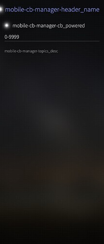

Today, an alert was launched in my area due to weather warnings, but it did not appear on my Xperia 10 V with SailfishOS 5.0.0.72. I tried turning on an old Android device, which received the alert as soon as it picked up a signal.
I had codes 0 to 9999 activated for some time with @nephros mobile-cb-manager, but it seems that it has not worked in this case.
Neither does it work in Sony Xperia 10 III last SailfishOS version, Spain.
Nothing on my Xperia 10ii either, nor the last time this was announced here.
Nor in the UK on Xperia 10 iii and .72. Either this functionality is broken, or it was never fully implemented. I believe a few have received alerts across different countries, but not many.
