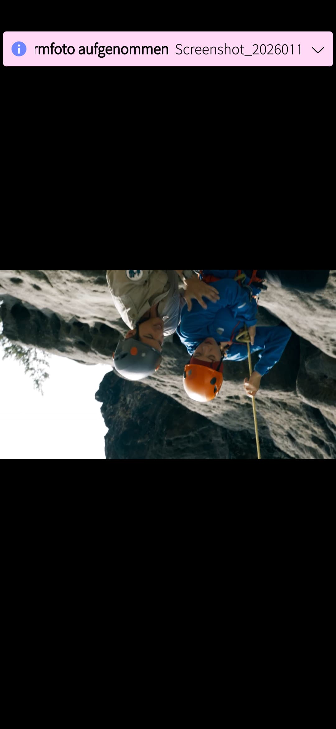

with above command rotation is either via bottom swipe (some scaling is applied) or double tap (only downscales if e.g. portrait video is rotated to landscape but not vice versa, remove multigesture if you dont need this. Also keyboard support is removed/commented, undo if you need this [but uncomment mouse stuff])
Also touch controls stay the same (portrait), if you want to switch if landscape is used you have to add/change this yourself (shouldnt be complicated)

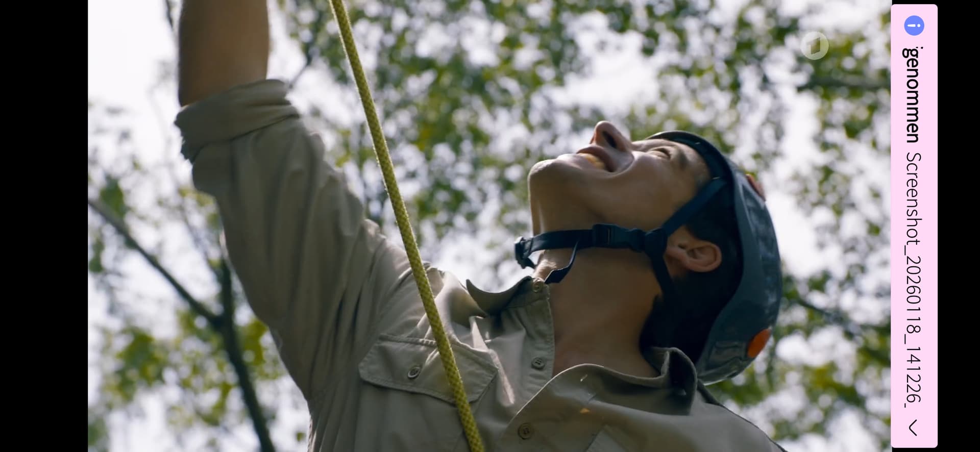

BTW, any idea how to make ffplay respect screen dimensions, i.e. scale the video to screen size, possibly also in landscape mode, or detect rotation?
video can be scaled with scale filter (this allows something like e.g. -1:1080 or 1280:720), check online examples. (something like .e.g -vf “transpose=1,scale=w:h” https://trac.ffmpeg.org/wiki/Scaling
dont know how to add autorotation, thats why I added the manual rotation (if you applied patch dont use double tap, use filter change with bottom swipe)

This way its possible to get display orientation, so autorotation should be doable
case SDL_DISPLAYEVENT: {
    SDL_DisplayEvent devt;
    SDL_DisplayOrientation dori;
    dori = SDL_GetDisplayOrientation(devt.display);
    av_log(NULL,AV_LOG_INFO,"\nEVENT Display %u\n", devt.display);
    av_log(NULL, AV_LOG_INFO, "Display Orientiation %d\n", dori);
    break;
Display Orientiation 3

patch that adds touch controls and autorotation (use with unchanged ffmpeg source)
patch_add_some_touch_control_and_rotation.targz (5.3 KB)
autorotation:
best start ffplay with video filters, else only image will be rotated
