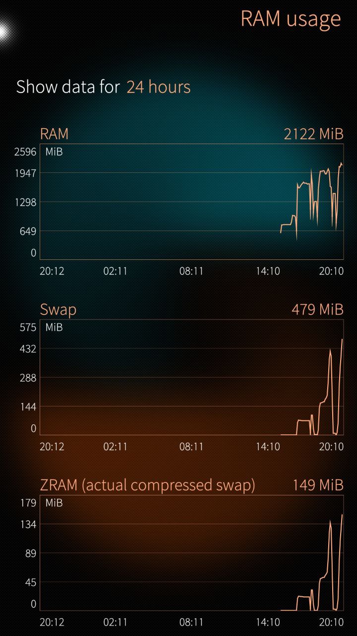

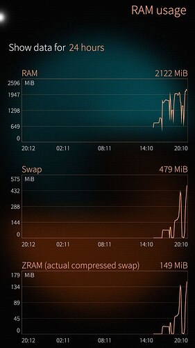

I’ve already added 1gig swapfile too.
The first results do show that now I am capable of doing stuff, which were not possible before - literally:
2 heavy sites in FF heavy loaded with plug-ins, NewPipe running a youtube-video in the background, while having f-droid, sysmon and couple if other systools running.
Impressive. (:
edit: I will run my XA2 for a couple of days and then report more.

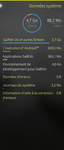

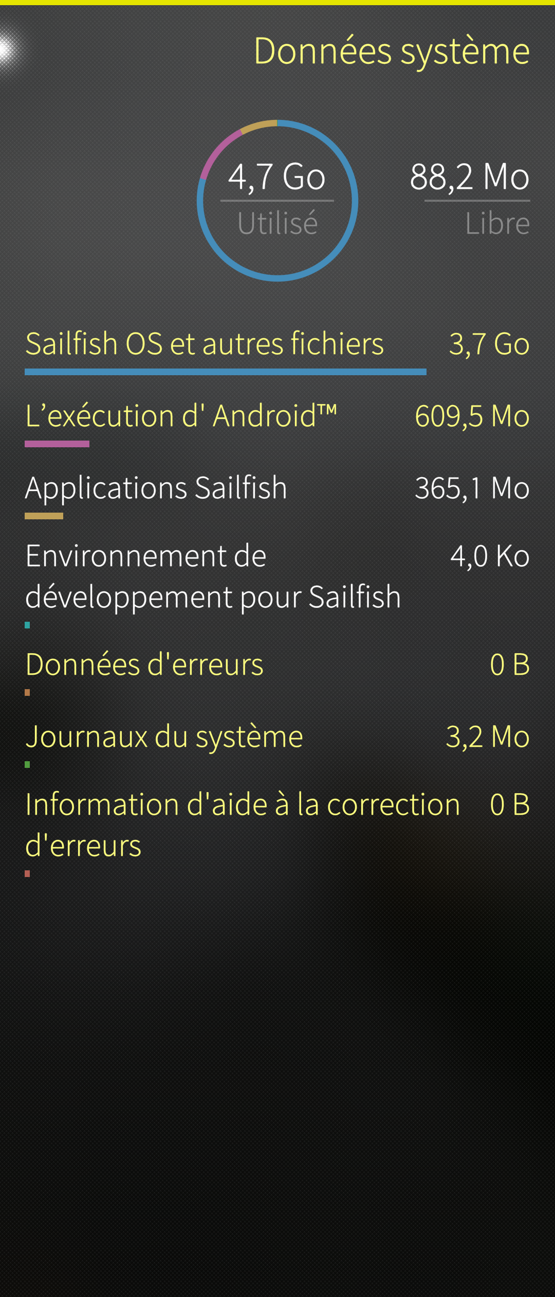

Only that question : after created 1Go swap file, the system partition is full. Is it a problem (for next SFOS update for example(?
Really good trick :slight_smile: No OOM with Pure Maps, and ny 10ii is now working very smoothly. Thanks a lot !
I think is better if swapfile is created in home in your case.
First of all, delete the swapfile:
  1. Modify /etc/fstab and comment (#) the line with /swapfile;
  2. Reboot your smartphone;
  3. Delete the swapfile with sudo rm /swapfile (if you prefer you can use devel-su instead of sudo).
