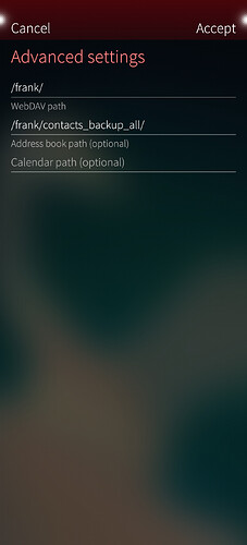

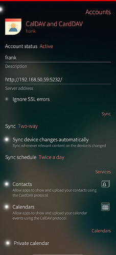

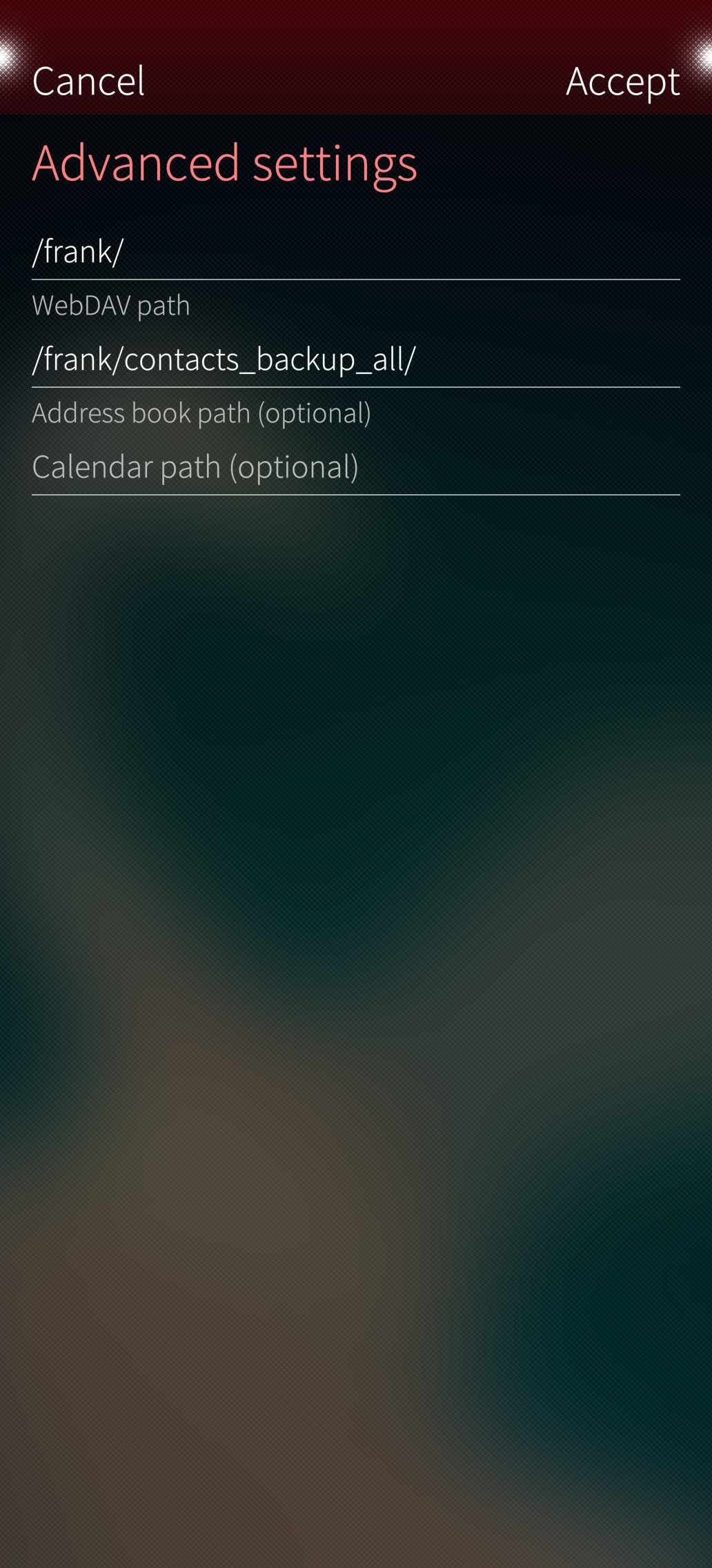

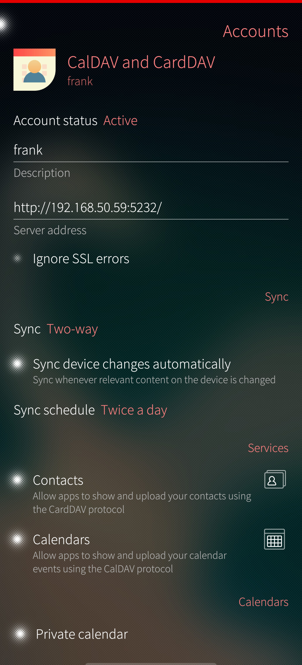

Well I have a radicale server running and i can sync my contacts as also the calendar. Just remember that probably the account on your phone wants https…so you have to add http://yourradicale:5232 as server if it’s not on https. Also look at the logging from radicale, it shows which paths you have to use.
And for your calendar make sure you use the right calendar ‘Manage Calendars’.

Thx for the info but I did all that the way you discribed. Calendar sync works well. Contacts added on the phone get to thunderbird (sometimes doubled) but new contact or changes from thunderbird don’t get to the phone. But thx for your answer.

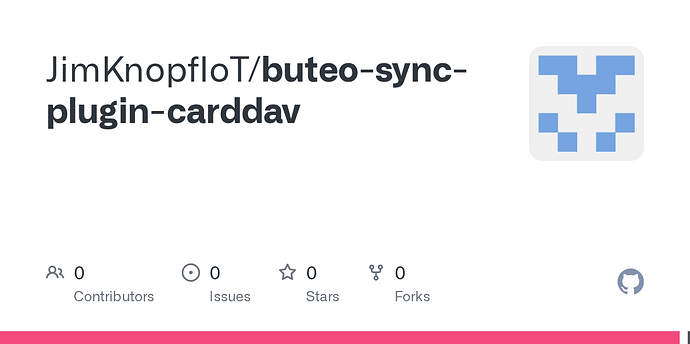

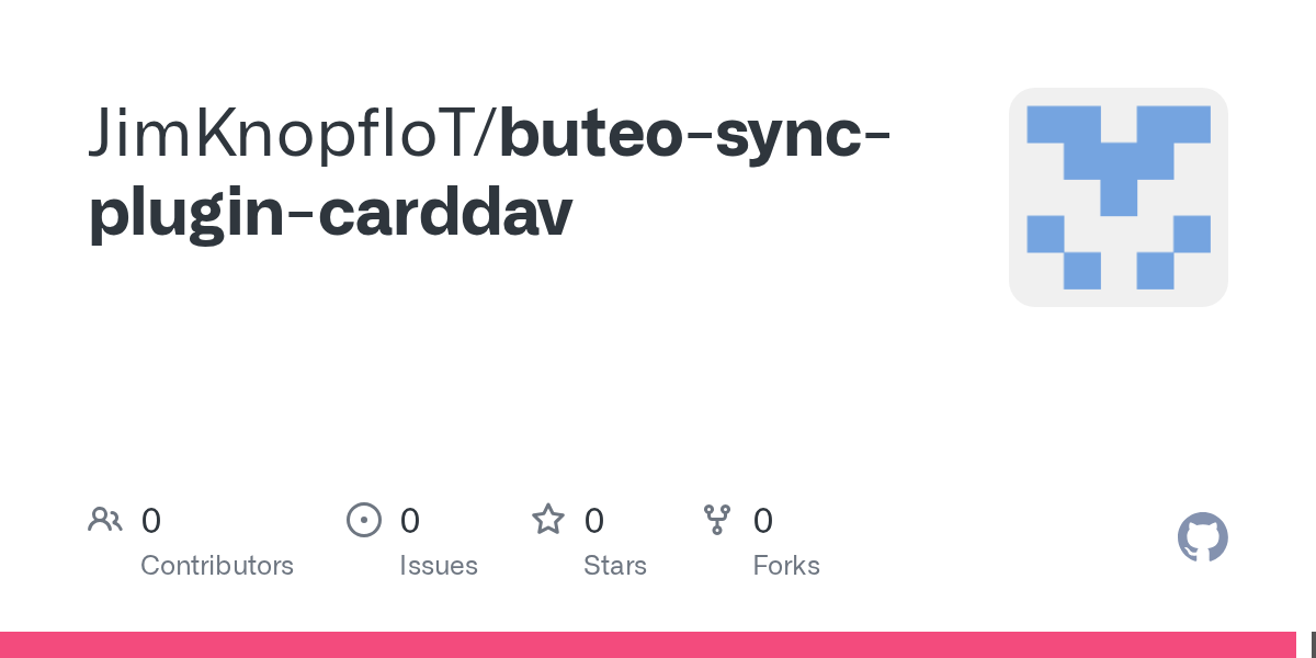

I can confirm this bug!
Jolla should have got a PR for this, time to accept it and roll out the fixed libcarddav-client.so.
