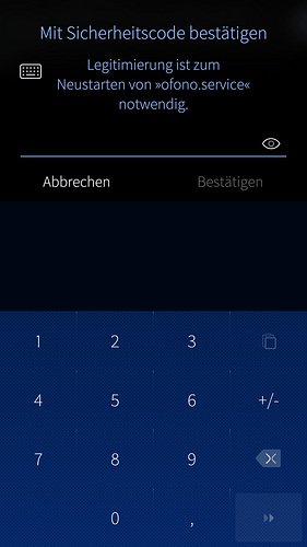

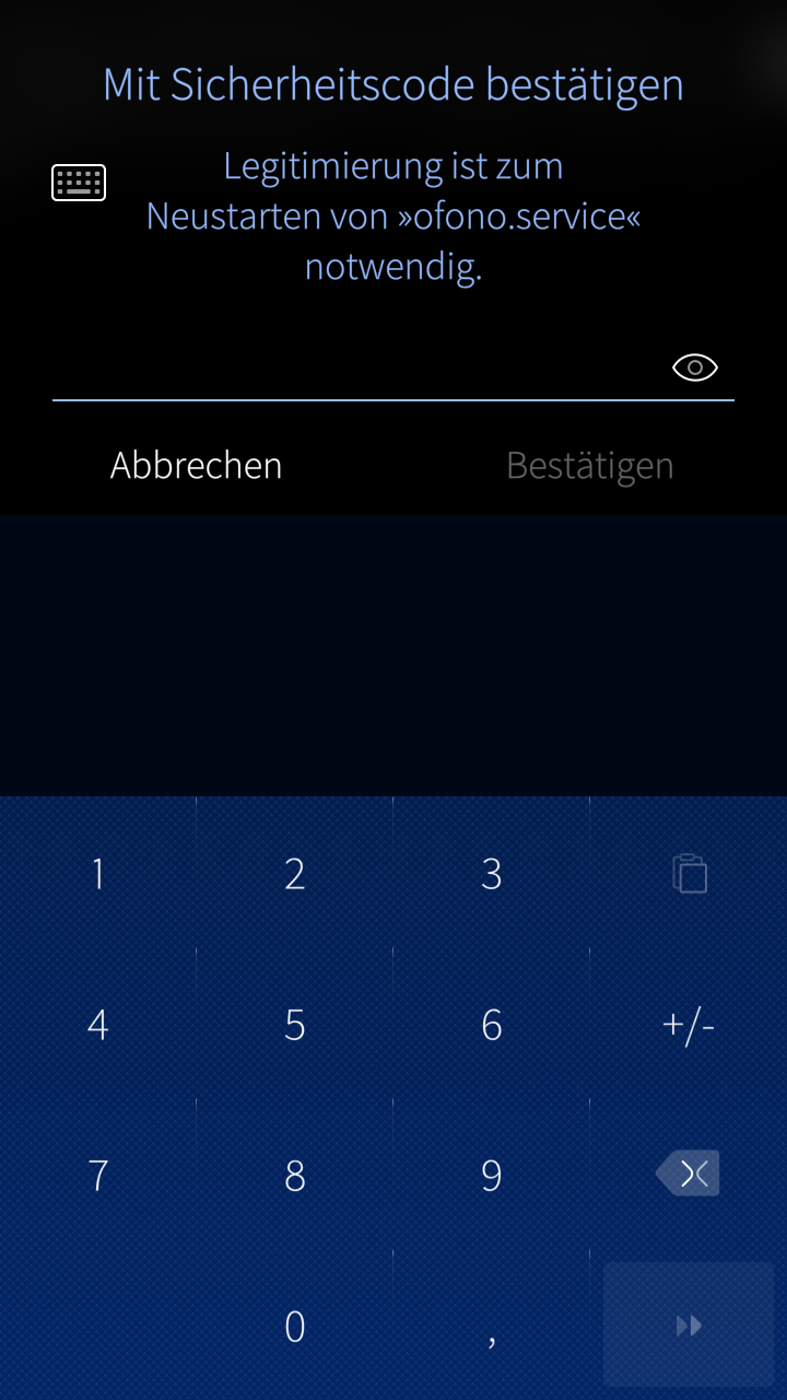

they do restart if you restart your device. By restarting the services via systemctl maybe you could avoid reboot (there is also a voicecall-ui-prestart service maybe this one is related to the issue also)

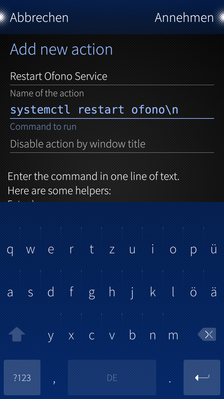

fully agree you shouldnt have to mess around with systemd on a phone but if you want to try if it actually helps (at least temporarily) you can use “toeterm” (not in jolla store, only in openrepos or this chum thingy) so you only have to input the command once as you can save it there for further usage

services like pusleaudio, ofono, droid-hal-init should restart via systemd if for some reason the running process gets killed (you can try yourself and use devel-su kill -9 ofono process, shortly afterwards ofono gets restarted. also oom_score_adj is -1000).
So maybe its related to some other service/process or ofono (or other related process) has some issue but wont crash (else systemd would restart the process)
We do have the app “helper settings” . Could anybody add something that starts / stopps ofono or anything else that helps, as a turnaround as long as it’s going to be fixed ?
