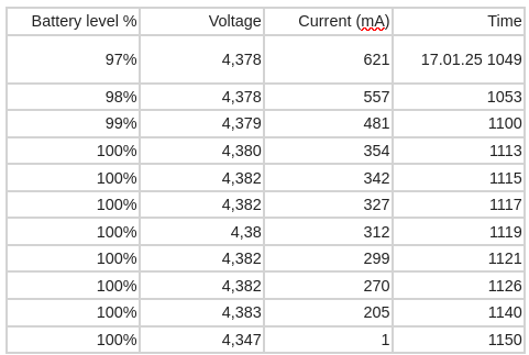

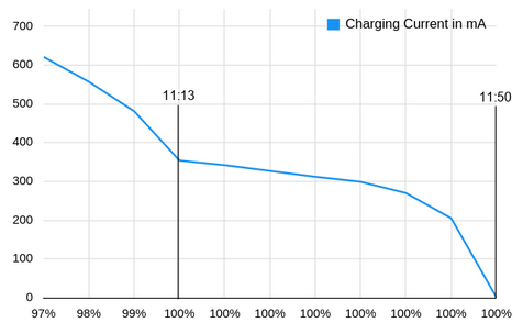

  • Name/IRC nick: Fingus
  • Topic: Percentage display of Jolla C2 battery
    The battery calibration of the percentage display on the Jolla C2 has a strange mapping/positve shifting. While the system shows 100% battery at “end” of charging, it sometimes continues to charge at 400mA and decreasing for 10-30 minutes until its really “full” - the System recognized that correctly then. When the battery-level falls below 20%, it drops very quickly (only a few minutes remain). The voltage of the battery is then 3.6 volts or lower, which indicates a miscalibration. Here in the forum, there are already some who have also observed and reported this. I do not consider this to be a hardware fault, as the battery voltages are within the permissible parameters. I could imagine it is defined in the device adaptation. Is there a way for you to easily change this mapping? Or its up to Reeder to change it in the Firmware/Driver?
  • Approx. time needed: 5 Minutes
Charging:

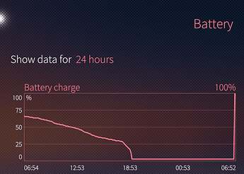

Discharging-Drop under 25% and very fast under 20/15% with same load:
Some additional information:
C2 has /sys/class/power_supply/sc27xx-fgu/ (FGU is Fuel Gauge Unit). That sysfs location has sc27xx-fgu/debug/dump_info which AFAICS should show the current (heh!) calibration values. Sources for that driver: Linux Kernel (may not the exact one in use in the C2!)
The sysfs file just dumps the current state of the driver. The actual one-time calibration data is part of the device tree, which is stored somewhere in the vendor_boot and dtbo partitions. A typical battery definition looks like this: ums9230-reeder-s19mps.dts line 64
The upstream Linux Kernel driver is a bit simpler than Unisoc’s version used in the C2 (probably kernel-sprd/drivers/power/supply/sc27xx_fuel_gauge.c at android-14-release-ula34 · MotorolaMobilityLLC/kernel-sprd · GitHub), but they both seem to start recalculating the charge based on the voltage only after the charge drops below a certain threshold. This should explain why the curve suddenly drops and suggests that it can be fixed by correcting the ocv-capacity-table in the device tree.
