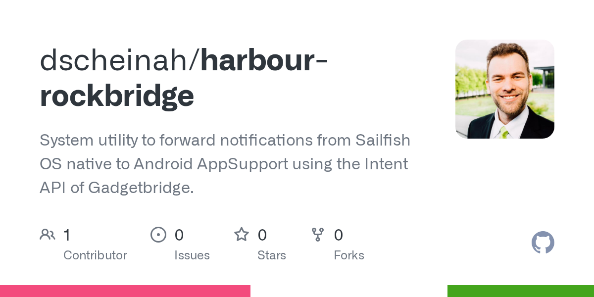

For anyone who’s curious, here’s what I have so far:
It’s currently untested and therefore unreleased, as I lent out my development testing device…
It’s done: RockBridge | OpenRepos.net — Community Repository System
