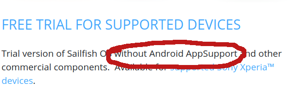

What does “purchased free license” mean?
Android App Support is a paid feature.
IV and V are a bit different with being beta (and subscription in the future), but for the III it is very much a normal paid license.
OK - my mistake. I’ll go and pay
