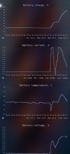

I noticed charging problems also on new JP, SFOS 5.2.0.13. I’m using laptop power source which gives me 3A @ 5V, 9V, & 15V, and 3.25A@20V. On the screenshot you can see that at time ~7:35 the charging rate went down when I was using the phone, and later it picked up again when I stopped using it. At the time when the phone was in use the charging icon was visible on top left corner of the screen like normal and I was just wondering why the charging is so slow. I’m using the default charging limit 90%. At next charge I will try to disable the limit to see if it makes a different.
