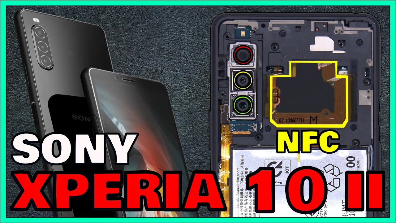

Here is an oversimplified video so that you can see how it looks like (at least part of it)
I’d just found out how to get the back cover off, (didn’t need to warm up the glue - a thin object drawn along in the junction was enough.
The video you provided is of good help for further action. Thanks a lot!

There’s several videos on how to…
https://eu.startpage.com/do/dsearch?q=Sony+Xperia+10+II+Disassembly+Video+Review&cat=web
Thanks for video links.
Problem solved:
Now the proud owner of one functioning X 10 II, and two halves no-functioning X 10 II. :slight_smile:
