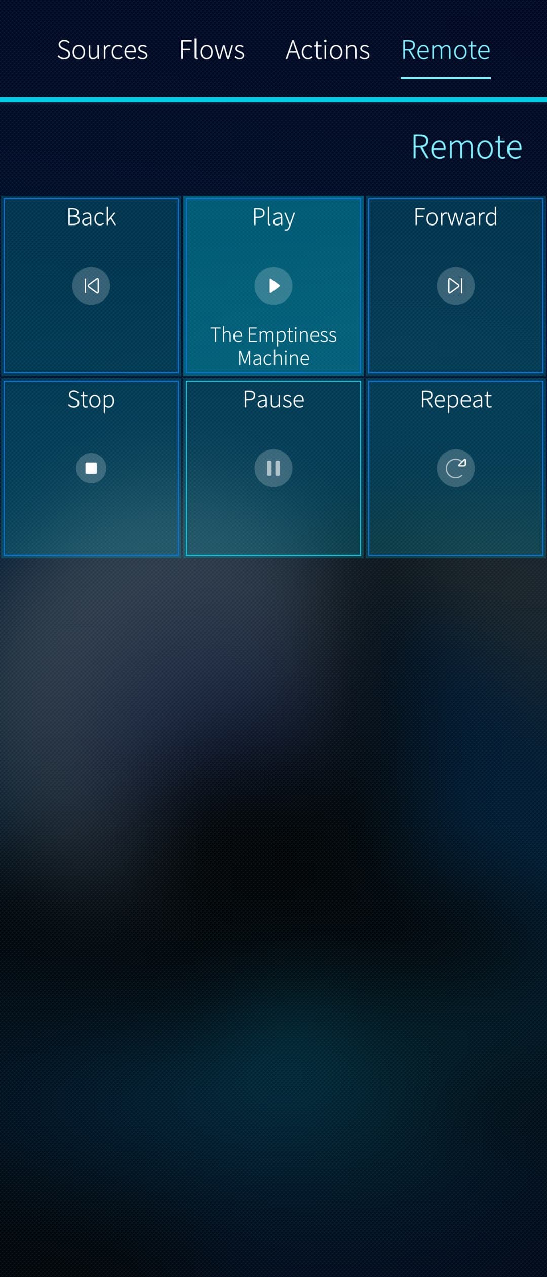

If home assistant understands any of the supported protocols you could create a remote in Automagic:

That sounds like it may work directly with Automagic (without going through Quartermaster), you could create http actions, connect them to flows and invoke them either via .desktop file or define a remote with buttons.
The later would also allow showing the current status (e.g. if the door is open etc.) if HomeAssistant exposes this over http.
