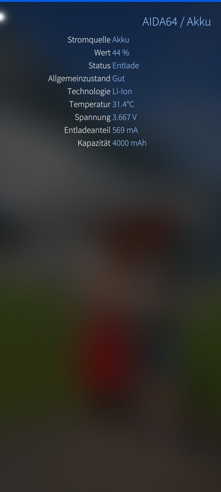

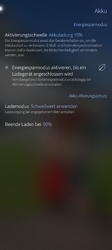

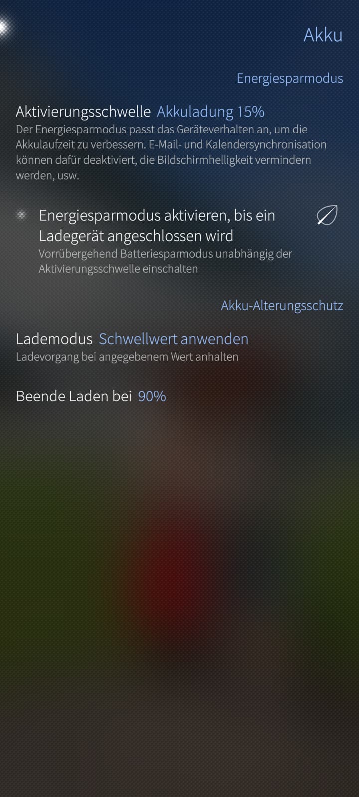

With these settings, my Jolla C2 has been working flawlessly for weeks. If you also install the “AIDA64” app, you can
verify this under “Battery”.
