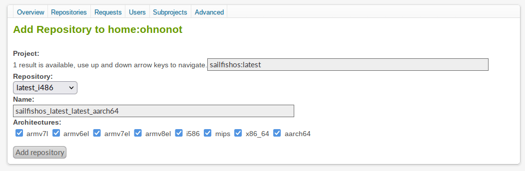

If I go to the Repositories tab on my home project => Add repositories => check “SailfishOS latest”, I get this result:
It looks wrong (for comparison, this is what it looks like on chum:testing/hosts-block).
OK, so I delete all repositories on my home project again, and do Add repositories => expert mode.
  • I’m being asked to specify a project. What should I enter there? Entering my home project does not give me any repos to choose from.
    • I enter sailfishos:chum.
      • The repository dropdown is now populated with basically all the choices seen in this screenshot (hosts-block). I do not remember adding those all 1 by 1. Which should I choose?
    • I enter sailfishos:latest
      • The repository dropdown is now populated with three repositories.
  • All the above repositories are architecture-specific by name, yet I always get an additional line of Architectures checkboxes: - what’s that all about? Leaving them all checked, the package still tries to build only for armv8el, i586, x86_64 and aarch64. I’m guessing I should only check one of those 4, leave the rest unchecked?

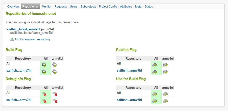

I have now changed the meta config xml to look like this:
<project name="home:ohnonot">
  <title/>
  <description/>
  <person userid="ohnonot" role="maintainer"/>
  <repository name="sailfishos_latest_latest_armv7hl">
    <path project="sailfishos:latest" repository="latest_armv7hl"/>
    <arch>armv7l</arch>
    <arch>armv7el</arch>
    <arch>armv8el</arch>
  </repository>
  <repository name="sailfishos_latest_latest_aarch64">
    <path project="sailfishos:latest" repository="latest_aarch64"/>
    <arch>aarch64</arch>
  </repository>
</project>
Would y’all say that’s a sane default setting for my home project?
