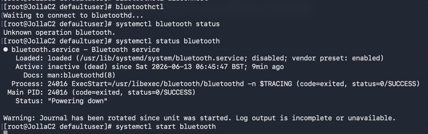

Symptom:
After the update, Bluetooth no longer can be turned on in the UI neither in the quick settings nor in the settings.
Attempt to restart the bluetooth subsystem fails. Bluetooth so far is not usable at all.
The bluetooth service shows as active and running. → update: cannot be restarted and show not running
Update 2:
rfkill list
0: bluetooth: Bluetooth
	Soft blocked: yes
	Hard blocked: no
Update 2:
Attempts to restart the bluetooth service hang forever in terminal.
Relevant logs:

Update 3:
Another cold reboot seems to have solved it.
My understanding of the issue: the bridge cannot take exclusive ownership of hci0; another process still has the controller open even after bluetooth.service is stopped.
I’ll leave the report here for anyone experiencing similar.
