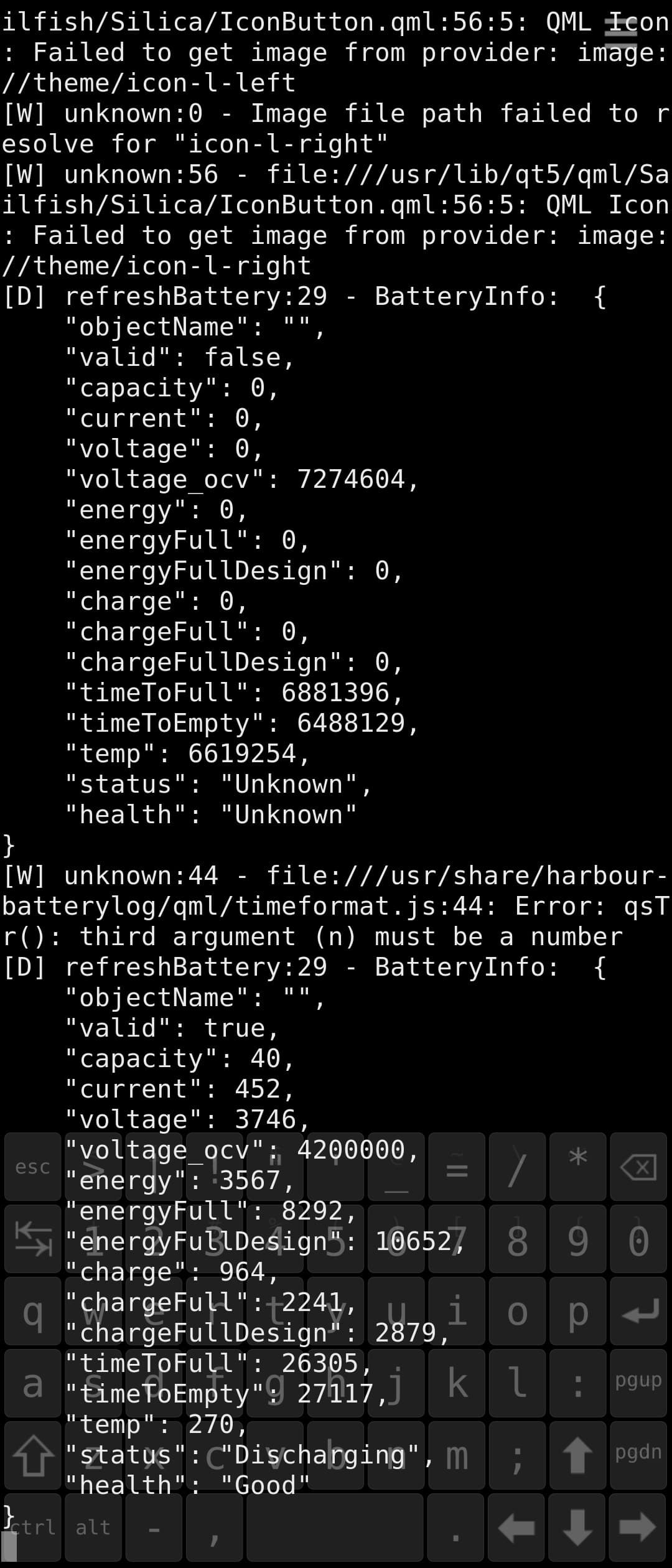

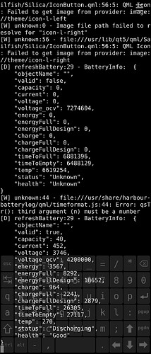

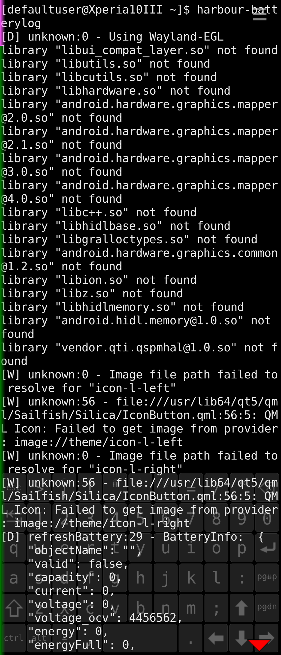

via terminal follow result:

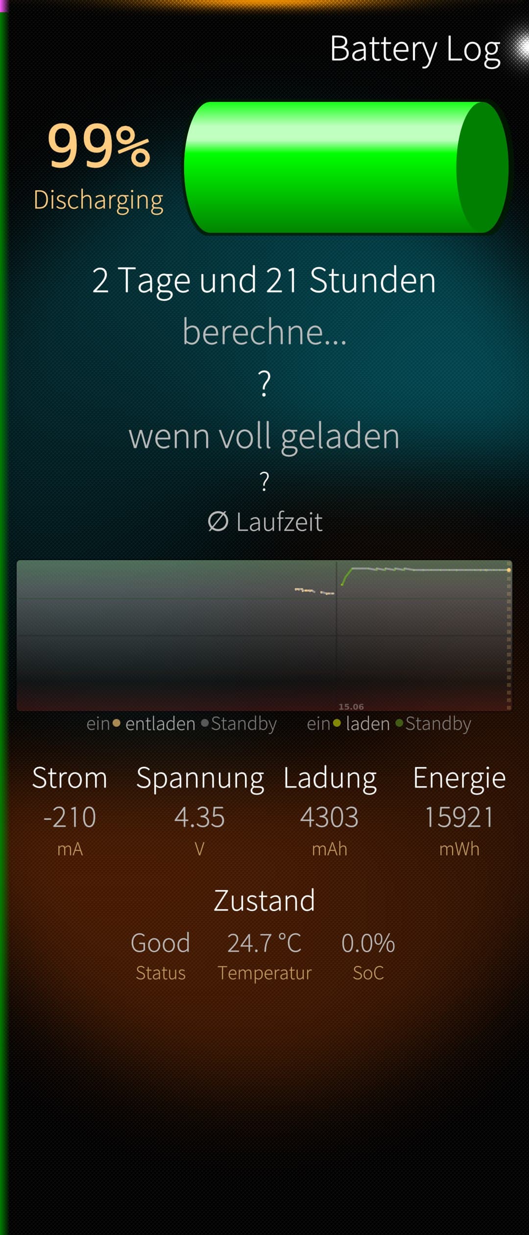

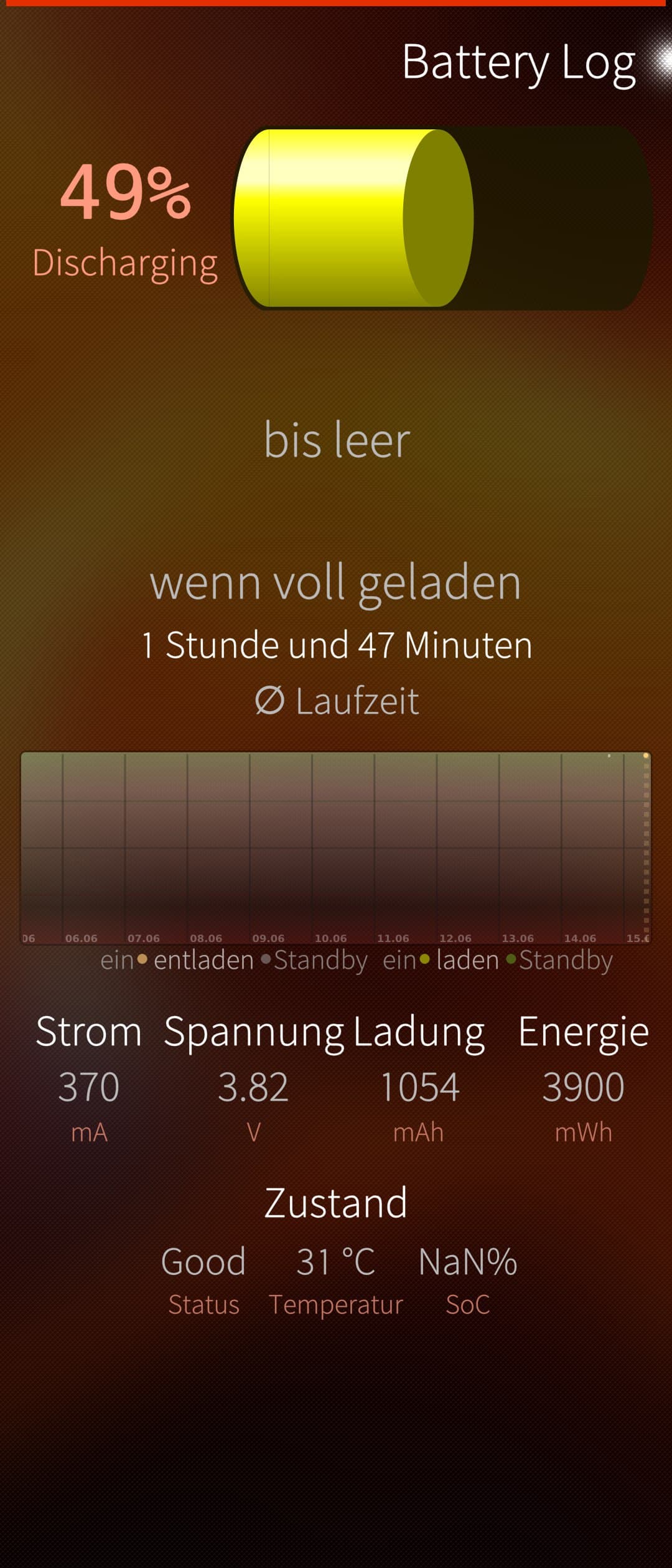

Hello nephros, yesterday I had a party and so I can answer only today. You are the best :). The new version brings two variable back on my X10III but on X10 the new version had now a -mA variable in charge moden and + in discharge. The biggest problem on both is, that the SoC varialble is missing. On X10III is this 0% and on X10 NaN%. Therfore the rest time cannot be calculated.
X10III X10

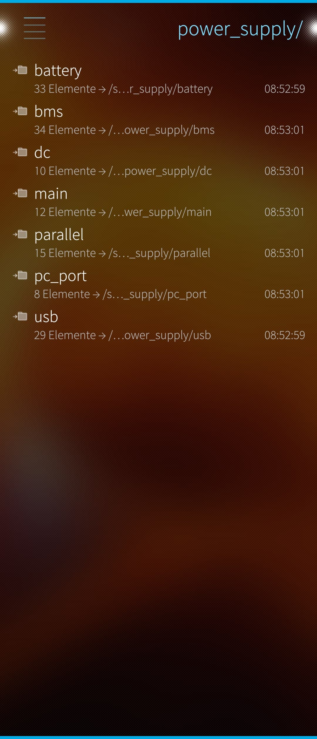

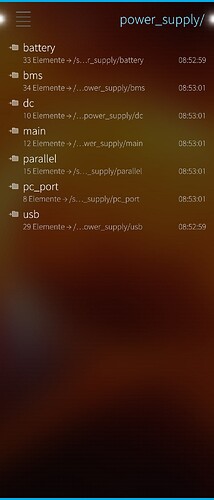

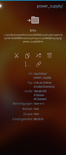

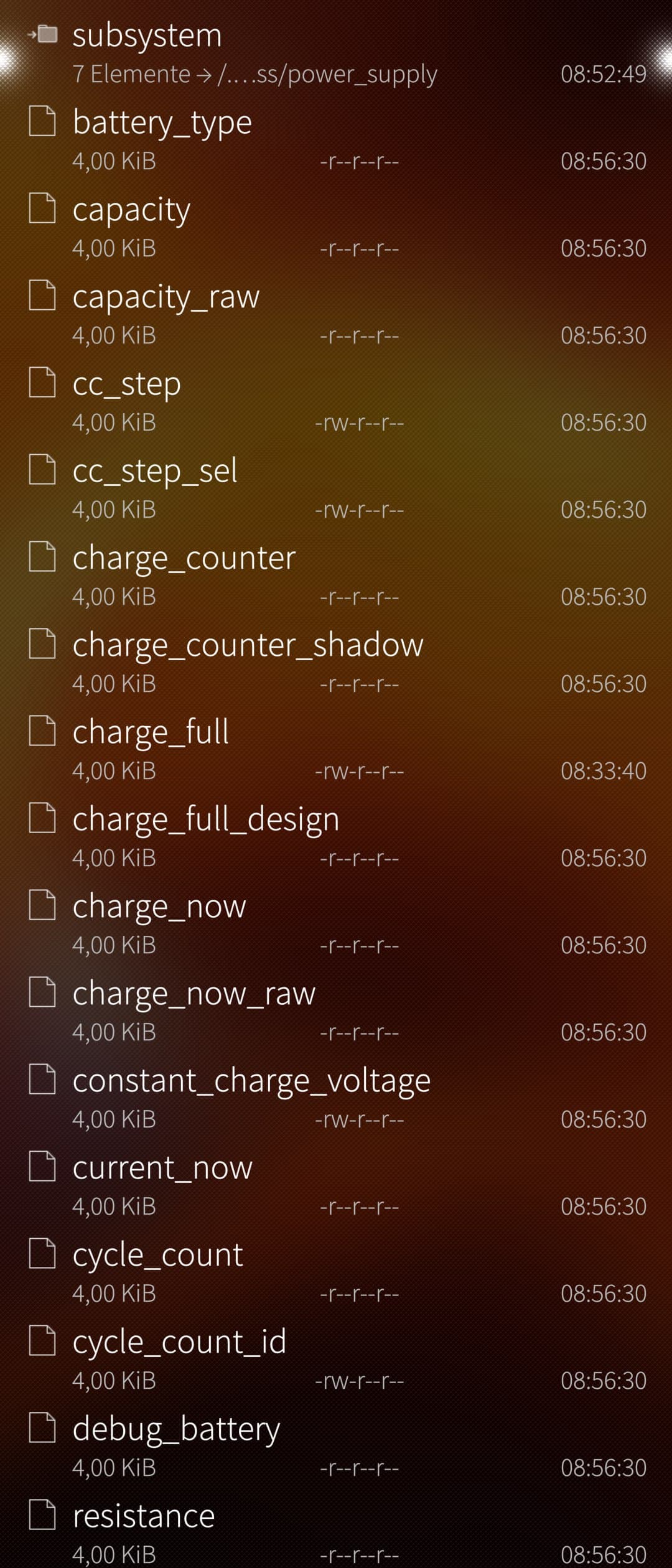

I was also with a file manager in /sys/class/power_supply and saw that all folders are linked on both phones to a other place. On X10 I have no patchmanager and so it could not be from a patch. But If I open the folder BMS I could see, that the used filenames are complete diferent between X10 and X10III and I think also between X10II. Maybe the hard reset changes the filenames from a fresh flashed phone. The Phon was Android 11 and never used before (fresh out of the box).

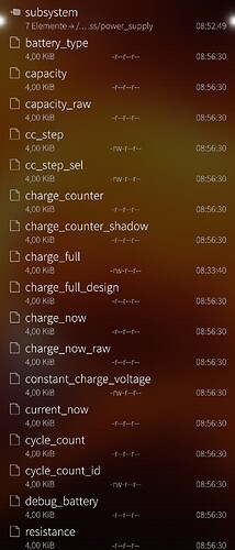

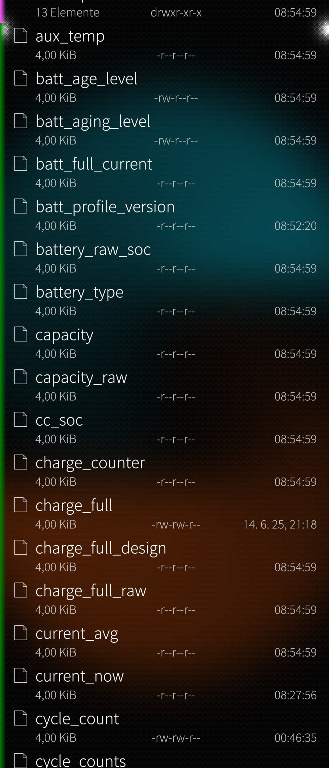

The SoC file on X10 is called “soc_reporting_ready” (file contains “1”) numeand on X10III I have 3 files “soc_reporting_ready” (file contains “1”), battery_raw_soc" (file contains “9417”) and “cc_soc” (file contains "9253).
No I will understand the file batteryinfo.cpp fom Batterylog and maybe I find a reason. Thanks for you quick task / new version and knowledege.
I was wrong the folder /sys/class/power_supply/battery/ is the reight folder. But the same game. The folder do not have the same name there either.
here the file lists:

I think the file "charge_full"makes the problem:
This is every time 0 under battery and bms. Maybe this constand is not usable. Maybe its possible to create it wich capacity and charge_full_design?
Also the file “charge_now_raw” not exist under bms.

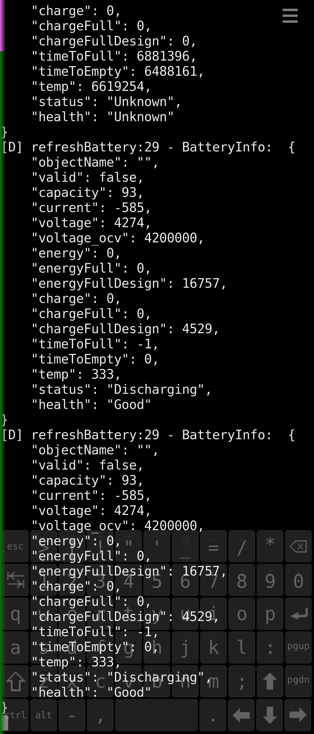

hera are the files from a X10III SFOS 5.0.0.67 in discharge mode:
/sys/class/power_supply/battery/capacity=89
/sys/class/power_supply/battery/current_now-344543
/sys/class/power_supply/battery/voltage_now=4253791
/sys/class/power_supply/battery/charge_counter=3893940
/sys/class/power_supply/battery/charge_full=0 here could be the problem!!!
/sys/class/power_supply/battery/charge_full_design=4529000
/sys/class/power_supply/battery/time_to_full_now=-1
/sys/class/power_supply/bms/charge_now_raw	file not exist
/sys/class/power_supply/bms/charge_full=0 here could be the problem!!!
/sys/class/power_supply/bms/charge_full_design=4529000
/sys/class/power_supply/bms/time_to_empty_avg=0
/sys/class/power_supply/bms/time_to_full_avg=-1
/sys/class/power_supply/bms/voltage_ocv=4271600
/sys/class/power_supply/battery/status=Discharging
/sys/class/power_supply/battery/health=Good
/sys/class/power_supply/battery/temp=310

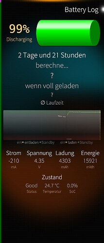

Yes I know but it was only a trick to compensate my 0 in this file. A other idea is to bring a if in there. If charge_full = 0 then use charge_full_design Else charge_full. We can also wait some cycles, maybe the BMS will write the right charge_full after it… No pressure. Before I made the hard reset with power+ Vol = 3x vibrate all was good. But a good effect is, that after this hard reset the X10III had a very low current in discharge. Befor it was about 200mA now 150mA most times.
After my hard reset and 2 times charge fron 1% to 100% the BMS is not refreshed and I have a “0” in /sys/class/power_supply/battery/charge_full and also in
/sys/class/power_supply/bms/charge_full.
So the app Batterylog could not show the remaining time at full charged.
