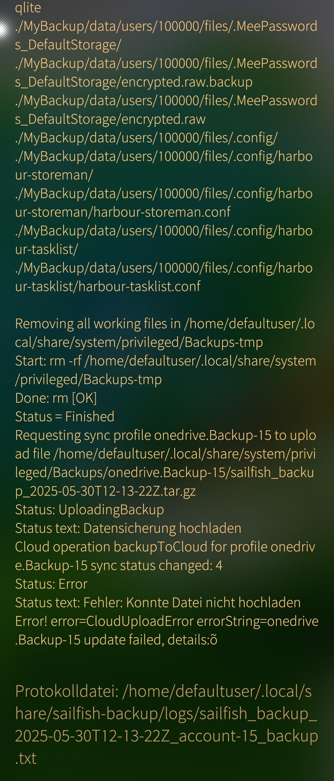

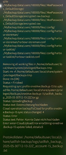

However I managed to retrieve the following logs from journalctl:
Mär 07 08:45:41 Xperia10III p[46102]: [W] unknown:0 - [sailfish
-backup] "Status text: Datensicherung hochladen"
Mär 07 08:45:42 Xperia10III buteo-oopp-runner[59964]: [W] unkno
wn:0 - "Backup" request with account 16 experienced error: QNet
workReply::NetworkError(ContentConflictError) HTTP code: 409 da
ta: "{\"error\":{\"code\":\"nameAlreadyExists\",\"message\":\"N
ame already exists\",\"innerError\":{\"date\":\"2025-03-07T07:4
5:42\",\"request-id\":\"8d139e07-ca74-4513-b5b2-099e66d3bef8\",
\"client-request-id\":\"8d139e07-ca74-4513-b5b2-099e66d3bef8\"}
Mär 07 08:45:43 Xperia10III buteo-oopp-runner[59964]: [W] unkno
5:43\",\"request-id\":\"5f35a065-694f-4c4e-9eab-ecca93f3f8a9\",
\"client-request-id\":\"5f35a065-694f-4c4e-9eab-ecca93f3f8a9\"}
Mär 07 08:45:46 Xperia10III buteo-oopp-runner[59964]: [W] unkno
workReply::NetworkError(AuthenticationRequiredError) HTTP code:
401 data: "{\"error\":{\"code\":\"unauthenticated\",\"message\
":\"Unauthenticated\"}}"
wn:0 - failed to backup file: "/home/defaultuser/.local/share/s
ystem/privileged/Backups/onedrive.Backup-16" "sailfish_backup_2
025-03-07T07-45-32Z.tar.gz" to: "Backups/Xperia-10-III_NsYDIHBU
iPRe" for OneDrive account: 16 , code: 401 response: ""
Mär 07 08:45:47 Xperia10III p[46102]: [W] unknown:0 - [sailfish
-backup] "Cloud operation backupToCloud for profile onedrive.Ba
ckup-16 sync status changed: 4"
-backup] "Status: Error"
-backup] "Status text: Fehler: Konnte Datei nicht hochladen"
Mär 07 08:45:47 Xperia10III buteo-oopp-runner[59964]: [W] unkno
wn:0 - Cloud backup error was: "CloudUploadError" "onedrive.Bac
kup-16 update failed, details:õ"
wn:0 - busy semaphore is negative for account 16
-backup] "Error! error=CloudUploadError errorString=onedrive.Ba
ckup-16 update failed, details:õ"
-backup] "Status text: untätig"
-backup] "Status: Idle"
