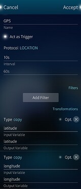

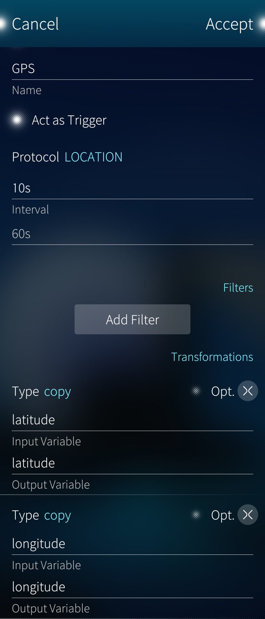

Version 1.0.17 adds GPS location as source or trigger:
Pushed to github. Not sure if anyone is using it that way :slight_smile:
