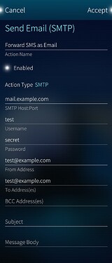

Version 1.0.11 adds SMTP support, allowing, for example, texts to be forwarded as emails:

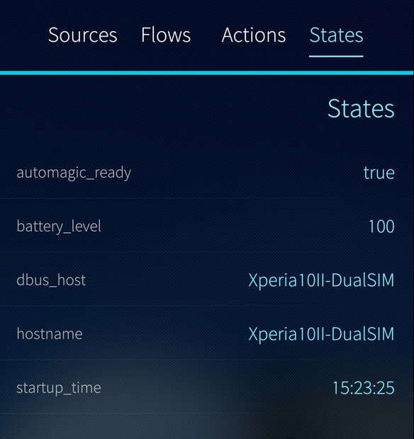

If something like this shows up in the States tab, then the daemon is working:
It may need a reload (from the pulley menu) after the initial install or any changes to the configuration.
Oh, ok, no I have nothing in ‘states’
Sorry, looks like there was an error in the spec file.
There should be another RPM (build version 2) that hopefully fixes this.
Yesss, states is now populated!

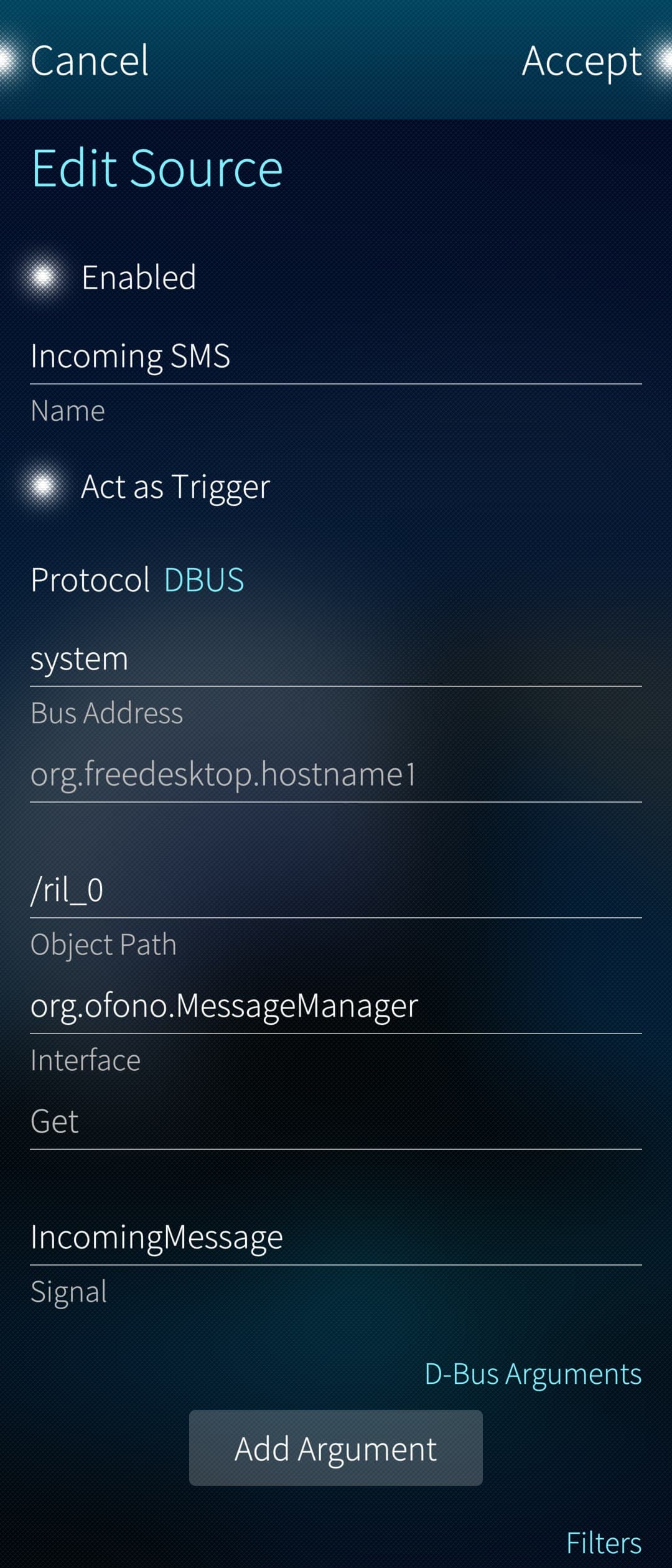

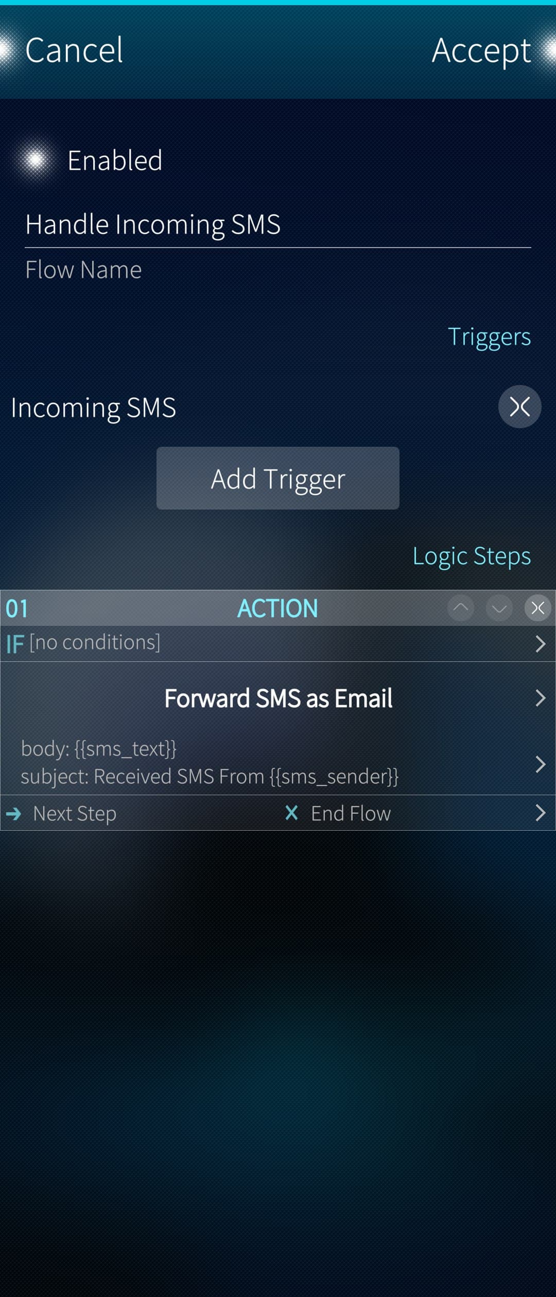

Here is an example how to forward SMS messages as emails:

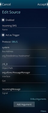

  1. Create a new trigger (or use an existing one, e.g. “Incoming SMS”):

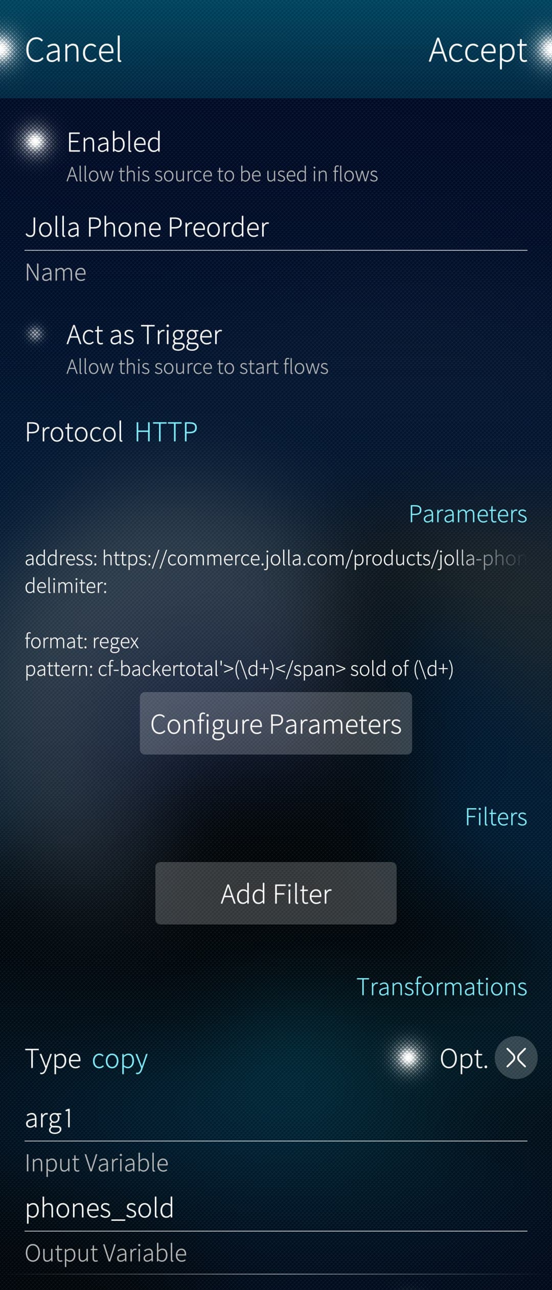

The difference between sources and triggers is that triggers can act as both, but can actually be used to start a flow. For example, a D-Bus signal can be a trigger, whereas a D-Bus method call can only be a source.
Both can pass variables to the flow, which are configured under Transformations.

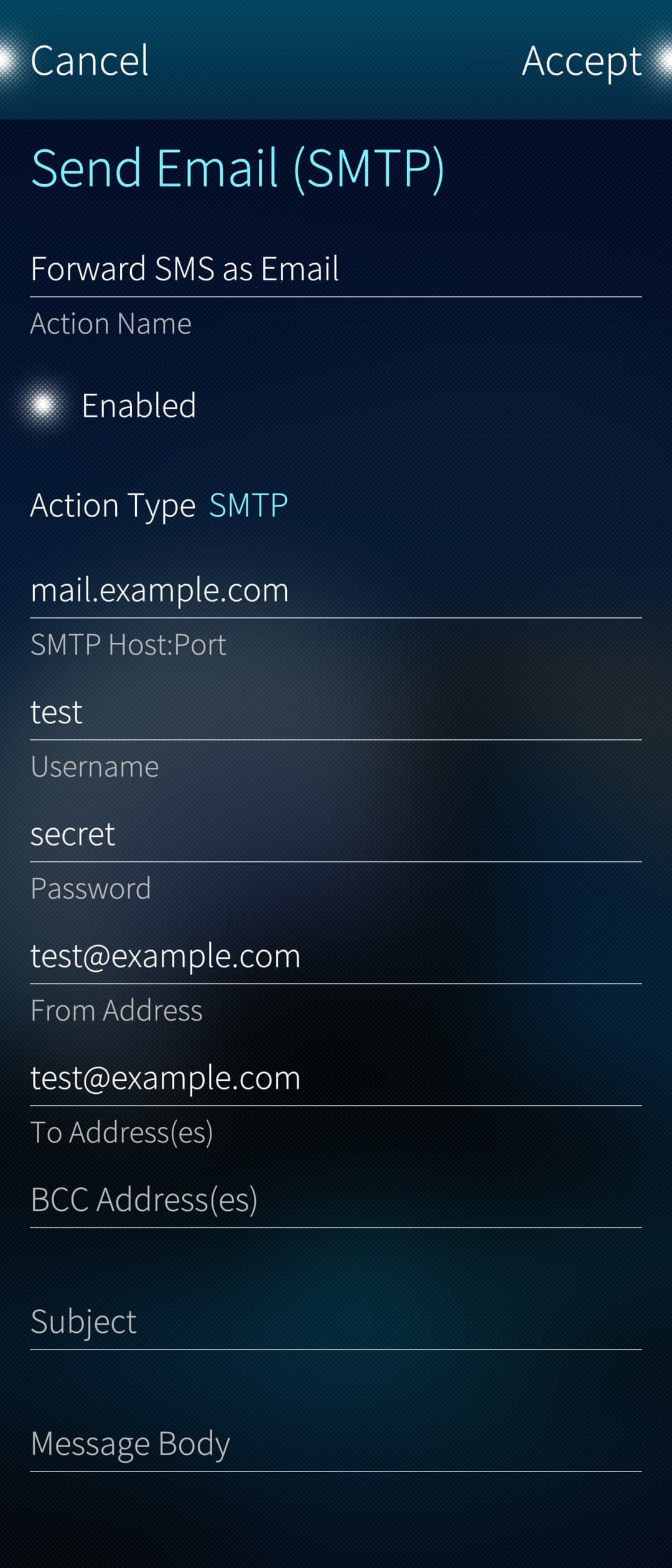

  1. Create a new action (or use an existing one):

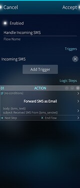

  2. Create a flow and select the trigger you want to use.
  3. Add a step to the flow to perform an action, for example an Action step, and select the action you want to use:
  4. Set the parameters you want to pass to the action.

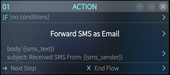

Message and body were left blank in step 2. so that they can be passed as parameters from the flow.
In this example the trigger receives a text message and saves the sender number and the actual text into two variables: sms_sender and sms_text.
The action step in the flow then sets two parameters/variables (body and subject) using the variables from the source to construct the subject and the body of the email respectively, that are then passed to the action.
The action then sends the email using the parameters that were defined in the action plus the ones that were passed from the flow. The later having precedence over the ones defined in the action itself. (e.g. If a subject is defined in the action it would have been used if there was no subject parameter passed from the flow).

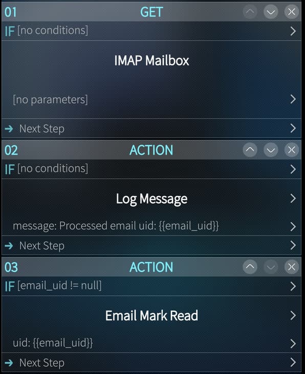

Version 1.0.12 adds IMAP support:

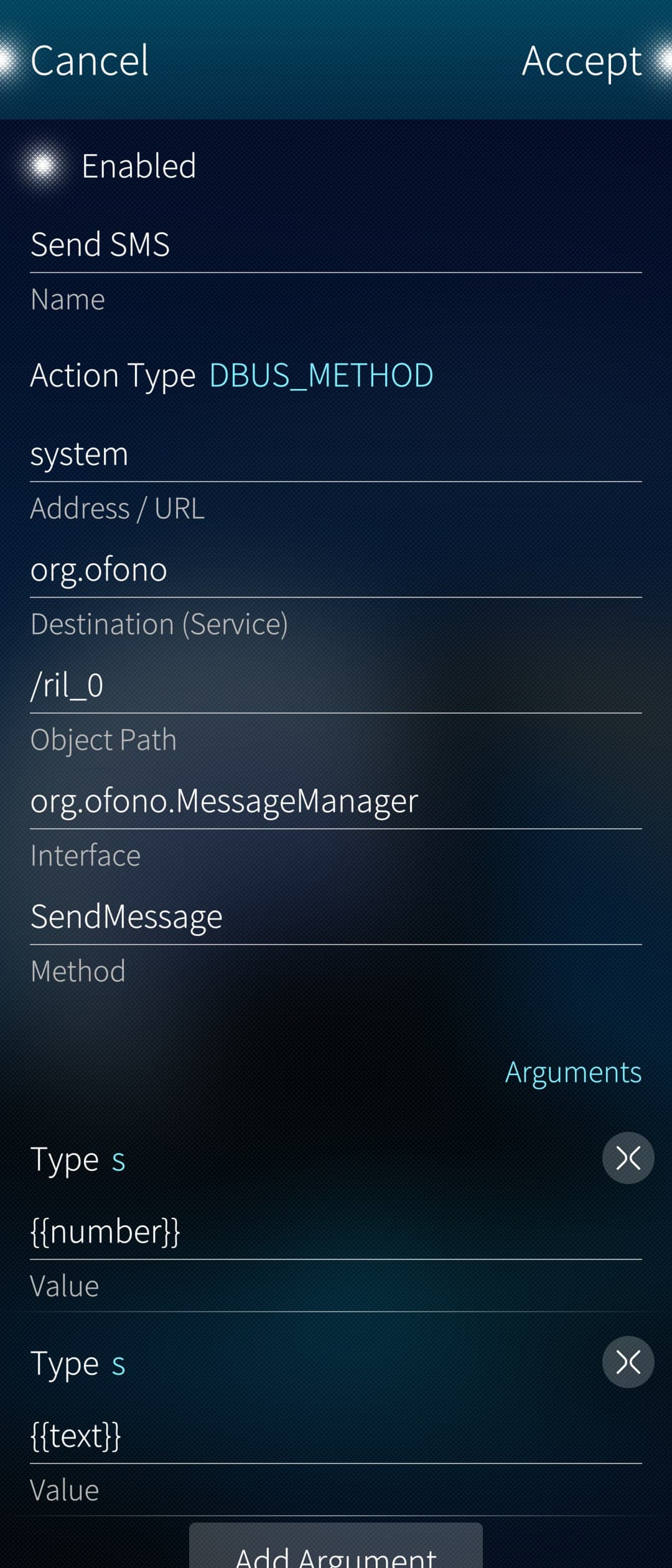

This should now allow building a complete two-way email-to-sms / sms-to-email gateway.

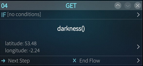

Version 1.0.13 adds a darkness() function to calculate sunrise/sunset:
It accepts latitude and longitude as parameters and returns:
is_dark: true/false
sunrise: HH:MM:SS
sunset: HH:MM:SS
sunrise_hour: H
sunrise_minute: M
sunset_hour: H
sunset_minute: M
Very useful for e.g. controlling lights etc.
