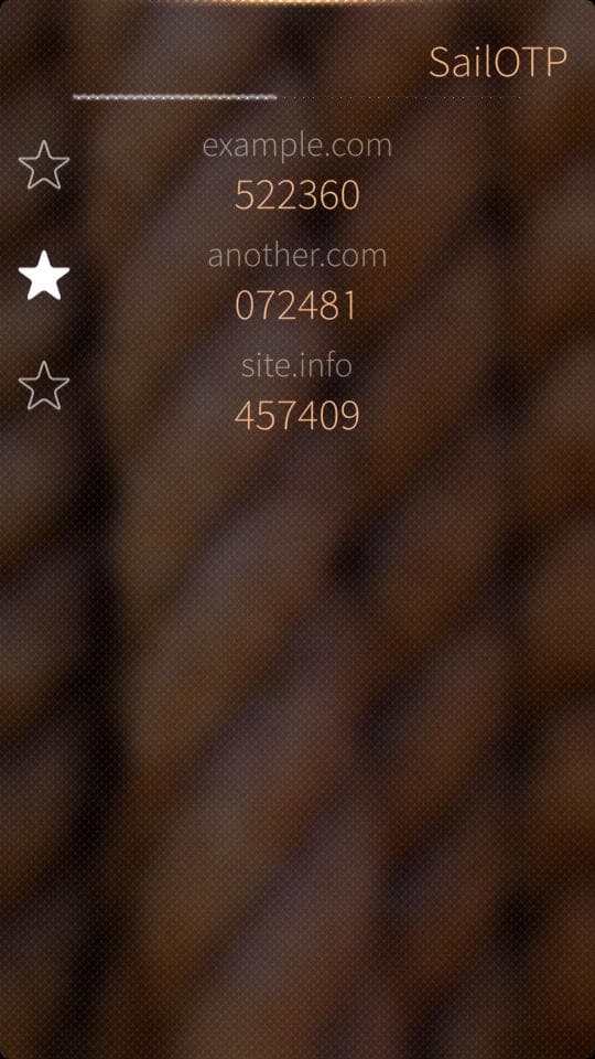

To give a (bad) example, take SailOTP.
The entries are at the top, far away from my hand, while the bottom is empty. The part I can reach with my hand is where nothing is. This is even worse on the tall xperia devices.
Now, why it is a bad example: I don’t really need to interact with these entries. And when I do, I am usually at my computer, where I can put down the phone, and don’t have the need for one handed use. So SailOTP is fine. But I hope it does make the point come across.
