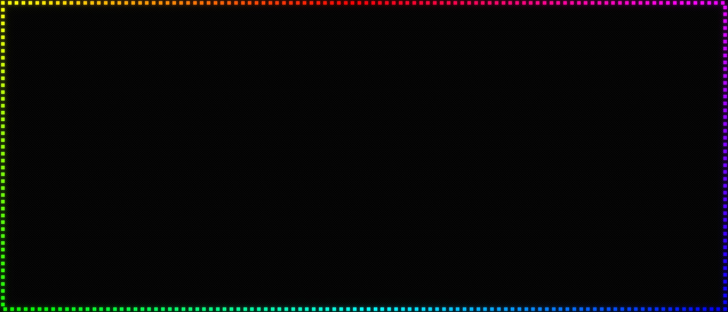

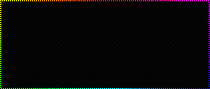

I’ve made a colour changing border that runs on sailfish but, I don’t have a SIM that fits my phone, so I cannot call to test.
Initially, I added the code to IncomingCallViewBase.qml in /usr/share/voicecall-ui-jolla/calling then realised I cannot make a call, doh!, the QML file I added this to, may not be the right place!
IF anyone fancies having a play, I’ll leave the code here. I can say, the effect is very resource hungry.
    // Fixed configuration values
    property real phase: 0.1
    property real margin: 10      // width value
    property real direction: 1.0  // forward
    property real modelCount: 300 // model value
    property real dotSize: 12     // dot value
    property real shape: 1.0      // shape value (1 = circle, 0 = square)
    property real speed: 0.01     // speed value
    // Timer drives animation
    Timer {
        interval: 16
        running: true
        repeat: true
        onTriggered: {
            phase += speed * direction
            if (phase > 1.0) phase -= 1.0
            if (phase < 0.0) phase += 1.0
    // Path animation
    PathView {
        anchors.fill: parent
        model: modelCount
        pathItemCount: model
        delegate: Rectangle {
            width: dotSize
            height: width
            //radius: width * shape / 2 + width * (1 - shape) * 0 // interpolate
            color: Qt.hsva(((index / pathView.model + phase) % 1.0), 1.0, 1.0, 1.0)
        path: Path {
            startX: margin; startY: margin
            PathLine { x: margin; y: parent.width - margin }
            PathLine { x: parent.height - margin; y: parent.width - margin }
            PathLine { x: parent.height - margin; y: margin }
            PathLine { x: margin; y: margin }
    FastBlur {
        anchors.fill: pathView
        source: pathView
        radius: 28
