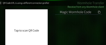

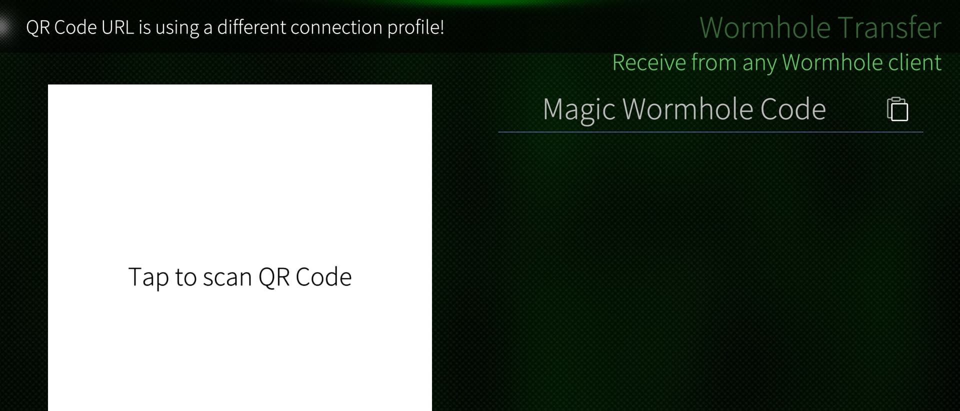

the problem with reading QR code is that Warp or iOS/android app generate just wormhole code (wormhole-transfer:2-some-code) = does not contain rendezvous or role …
so around this piece of code will need more enhancement to use default values if they are not in QR code…
 else if (content.rendezvouz != wormhole.mailbox) {`
                                    app.popup("QR Code URL is using a different connection profile!")
Thanks for the analysis.
I try to set the defaults in the URI parser correctly, but that rendezvouz part was a typo/thinko.
Shoud be fixed in 0.3.8 (8139e0a).
:partying_face: now it is working, reading and start receiving from Warp or iOS app automatically :raising_hands:

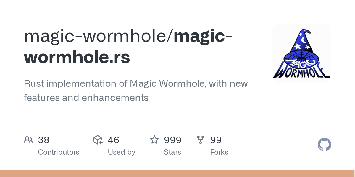

There is an official implementation in Rust.
This can help avoid Python dependencies.
Thanks. I’m aware, but Rust is even more of a can of worms than Python, when you’re trying to build offline (like on OBS).
