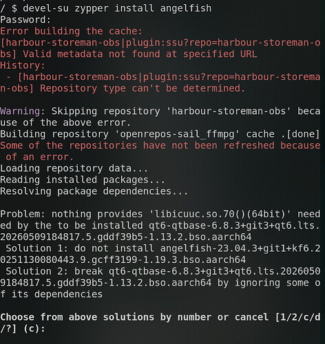

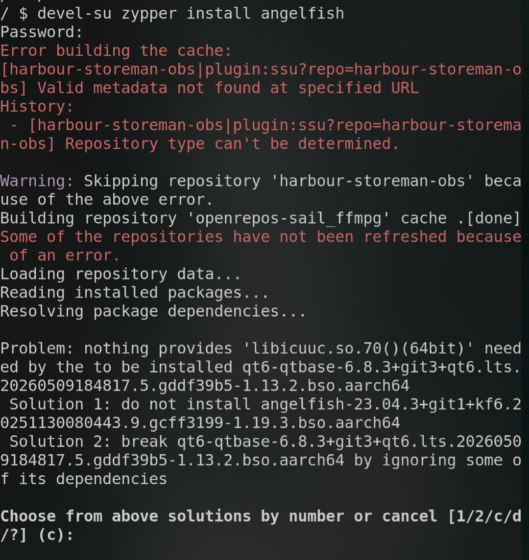

Hi, becasue of the latest update (5.1.0.11) I had to delete Angelfish due to space constraints on root. After I updated, now when I try to reinstall it it gives me this error
Would I be fine picking solution 2 or should I try to fix it somehow?
I assume its because of some dependencies that updated in the new sailfish update?
Thank you for any help :downcast_face_with_sweat:

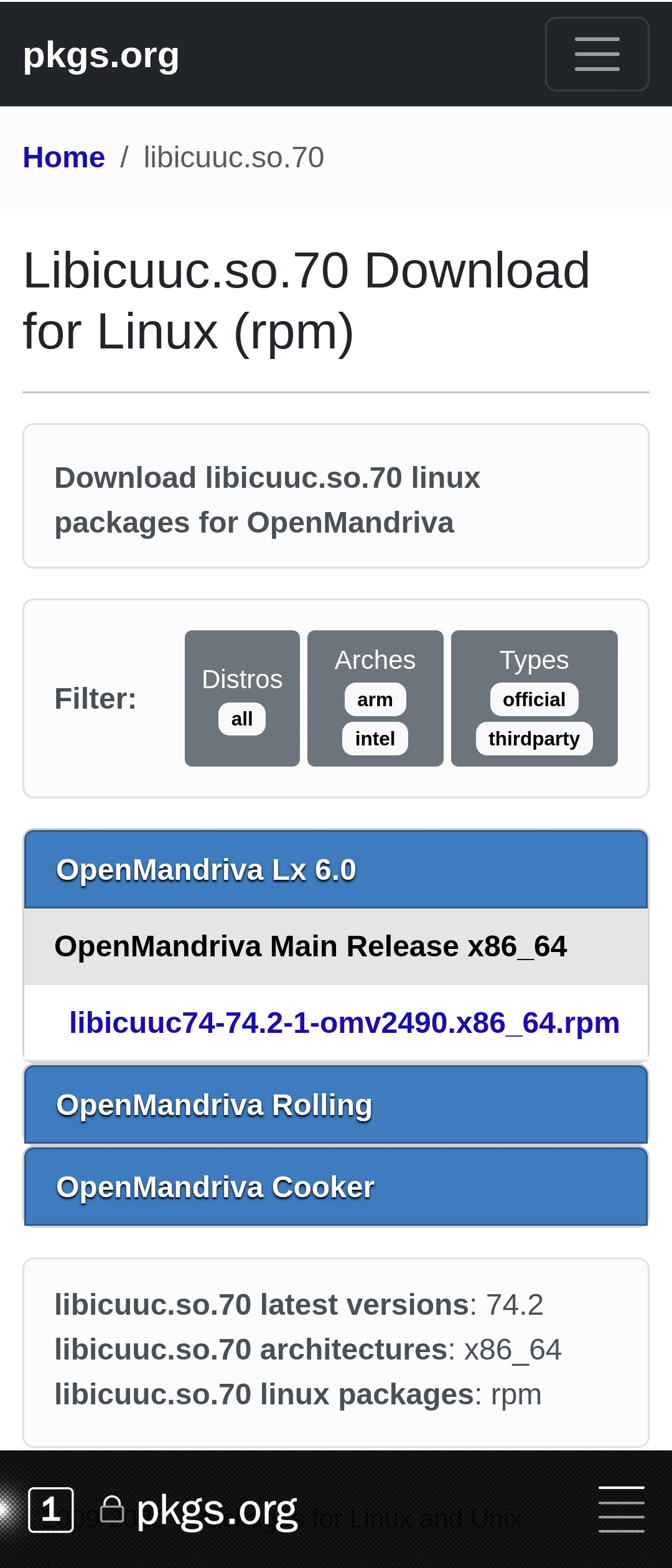

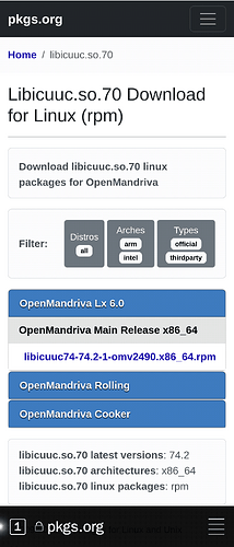

After some digging I found an rpm with the name of the missing dependency but Ive also read somewhere on the forum that just downloading and installing rpms arent a good safe way to do it on sailfish. Neither Zypper nor Pkcon has it in my installed repositories
Downloading and installing software from random sites isn’t a smart thing to do on any OS.
Are you using the piggz repos for Qt6? There aren’t any Qt6 builds for 5.1 on Chum yet.
See the other Angelfish thread for details.

@piggz had replied that the required scratchbox changes were expected in 5.1 How is Angelfish currently? - #99 by poetaster
Which does not mean they have made it yet.
and i believe they wont even make 5.2
Sorry Im not a developer, but that sounds like we wont see it working until at least 5.2, if even then?
It means you won’t get a working version of any Qt6 application from Chum until that “sb2 issue” is resolved. That may be in 5.2, or later, or never happen. We don’t know.
You will have to use (even) less “official” repos, like the piggz one, in the mean time.
And while the volunteer developers and maintainers of this repo try to make responsible choices that will not brick your device (hopefully), you are in *development/alpha/untested" waters if you do.
No guarantees are made of any kind, and “What you get is what you get”.
