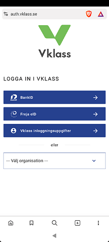

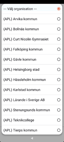

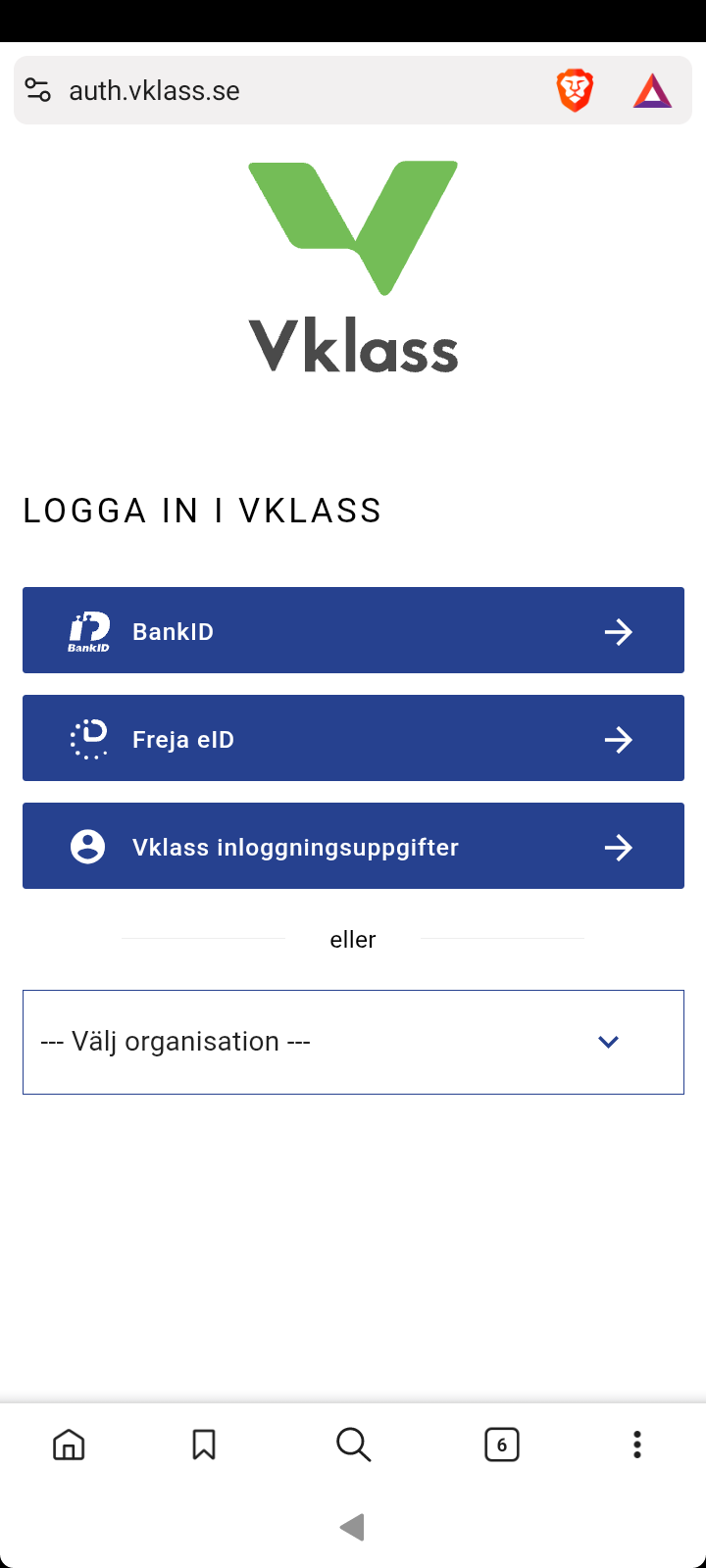

For example on auth.vklass.se (images belpw are from Brave browser, just to show what these dialog boxes are)
Pick “välj organisation”
The second image doesnt show in Angelfish.It simply does not load the list
I actually noticed that Välj organisation doesn’t work. On the stock browser it comes up Silica style.
Tested with this. Its most probably due to interaction between Angelfish and rather limited Wayland composer incorporated into qt-runner. On desktop, in Angelfish, this site worked as it should. Would have to look into it at some moment. Right now, not sure how to resolve it. Probably would have to check how is it done on stock browser

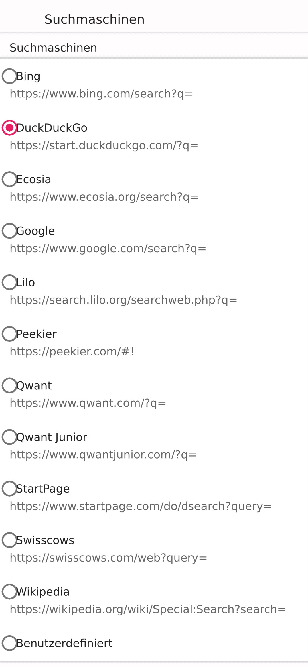

Is it possible to get the other available styles working properly ? https://doc.qt.io/qt-6/qtquickcontrols-styles.html (now they do work but missing icons and some elements have some layout issues)

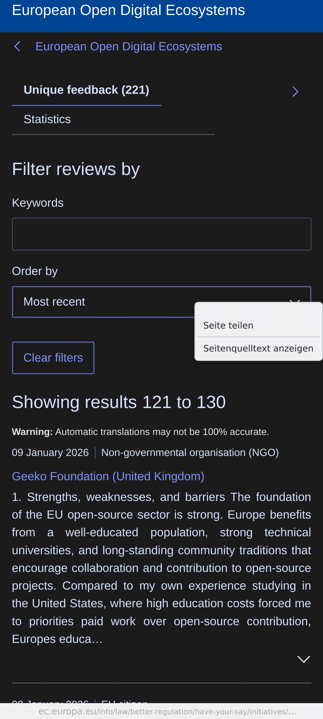

I do not if it was mentioned already: chiose in drop down menus do not work.
If a webpage requires entries via drop down menus, such selection of a country from a predefined expandable drop down list, thus cannot be expanded.
In the attached screenshot ‘order by’ the drop down cannot be expanded and no item chosen. In this case progress to the following page is not possible because the website experiences that no option from the drop down menu was chosen by the user

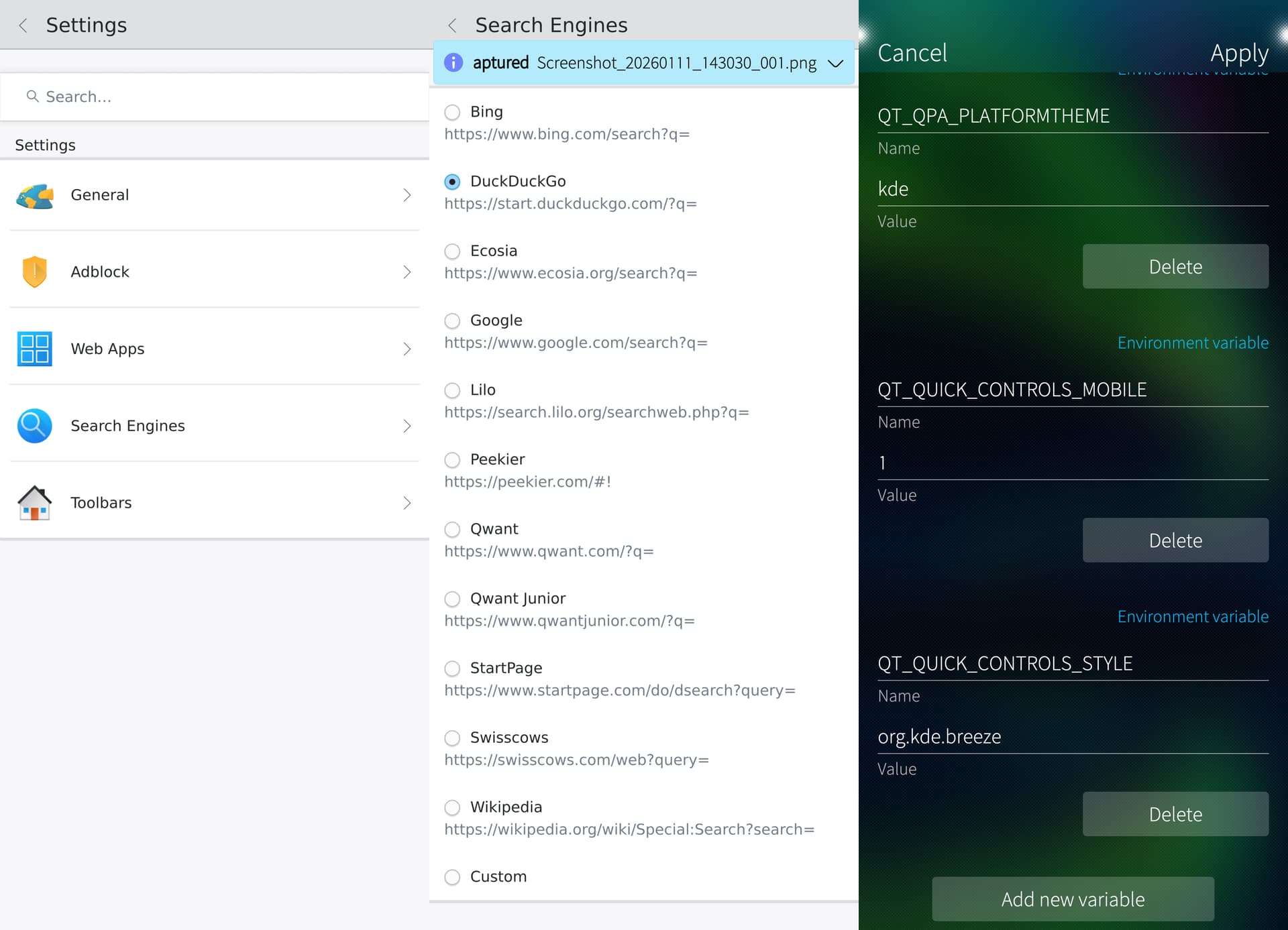

In my install it seems to be using the Breeze style and Breeze icons.
I think it is related to the (default) Qt Runner settings.
However, I am interested in getting the Breeze Dark color scheme working.
