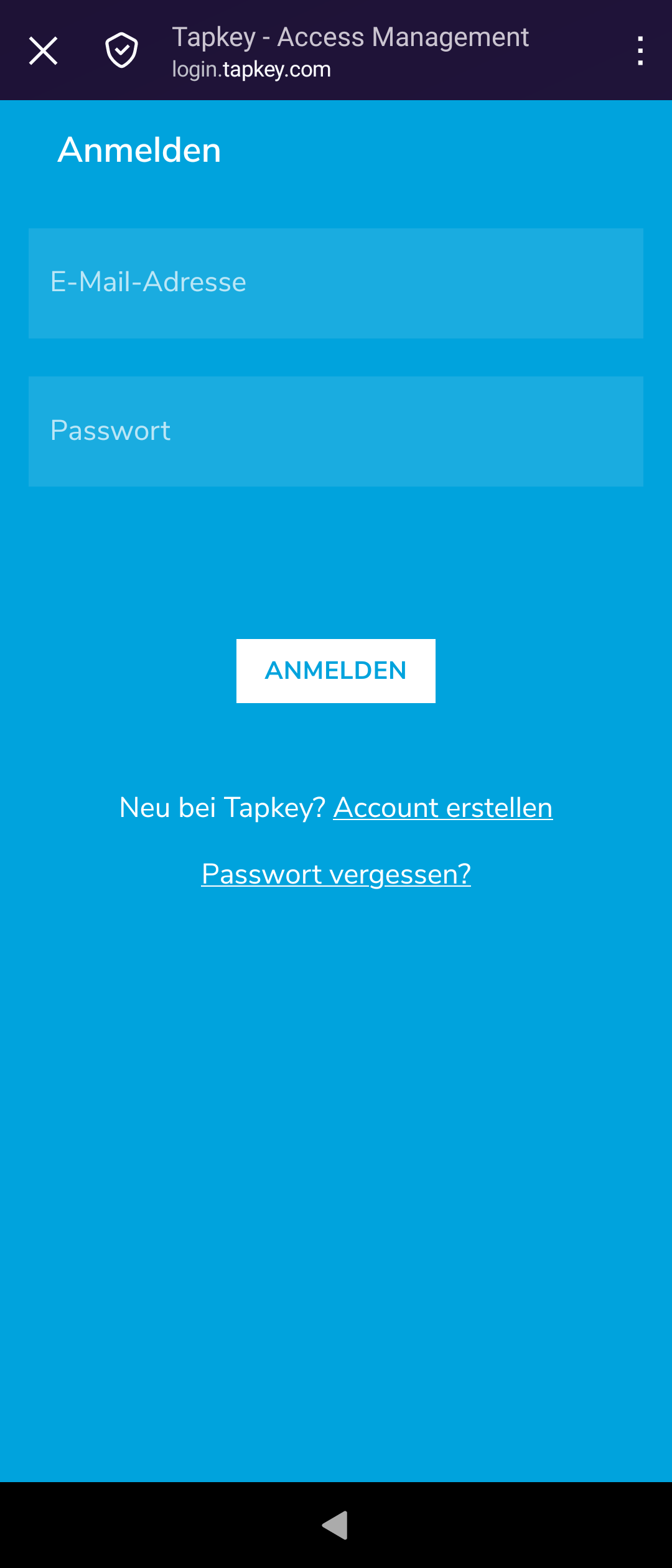

You need to install a web browser inside the Android layer. Firefox Focus is a lightweight option:
After that, login works for Tapkey (see attached image)
Make sure that inside Firefox Focus, Settings > Advanved > Open links in apps is enabled
