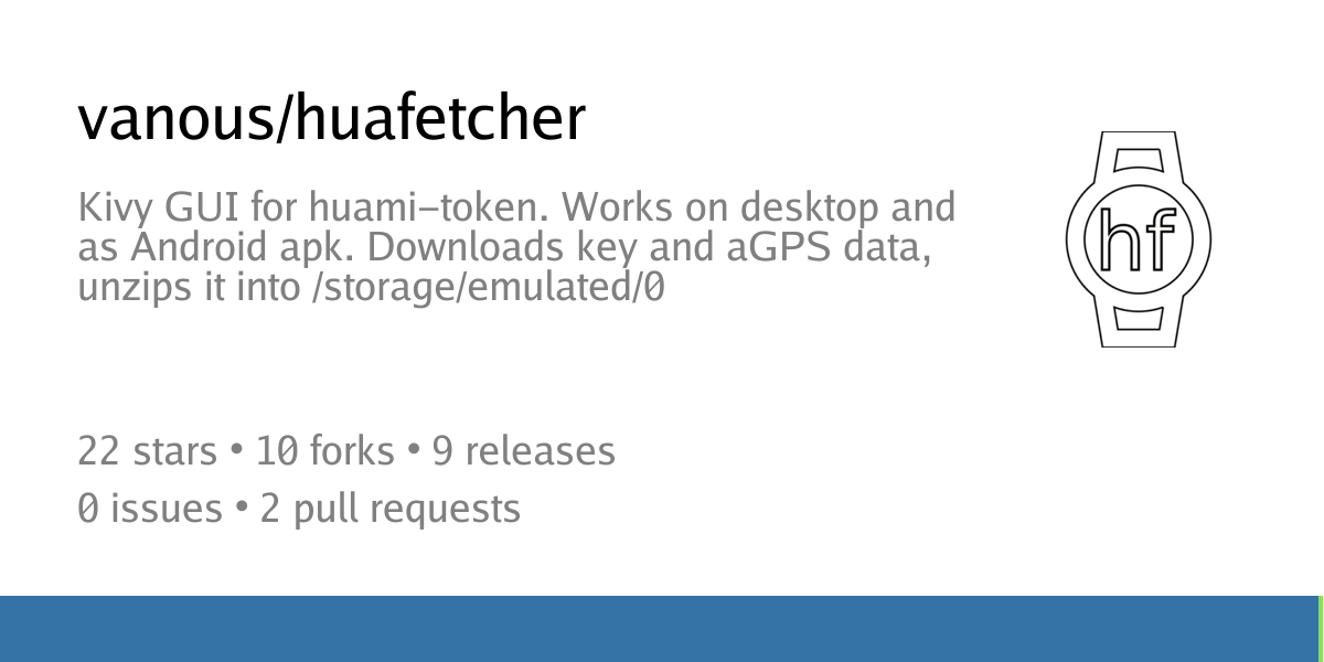

It seems the new token retrieving protocol as already been reverse engineered. Hopefully we get a new implementation soonish.
Maybe someone can extract the new function of hafetcher to get the aGPS data into a script because hafetcher is open source and written in Python.
