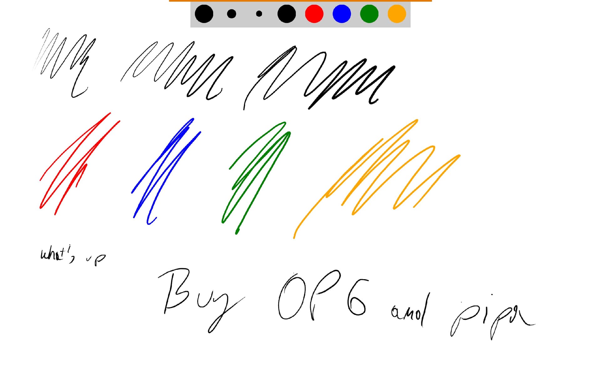

I was bored and very tired and decided too cook up world’s worst note taking app
