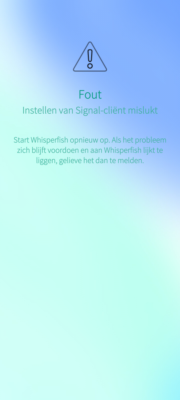

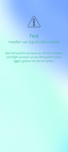

I get an error with registering as primary device on Whisperfish 0.6.0-b35, SFOS 5.0.0.68, Jolla C2. After I enter my phone number and completing the captcha I get this message:
translated from screenshot:
Error
Failed to set up Signal client
Restart Whisperfish. If the problem persists and seems to be related to Whisperfish, please report it.
I also tried it with beta 34, but unfortunately the same problem. Is there a fix for this issue?
You’ll want to reset Whisperfish and then try again, while capturing logs. If it happens again, share either @direc85 or me the logs in a private message. I think @direc85 is a bit more responsive around this time :wink:
