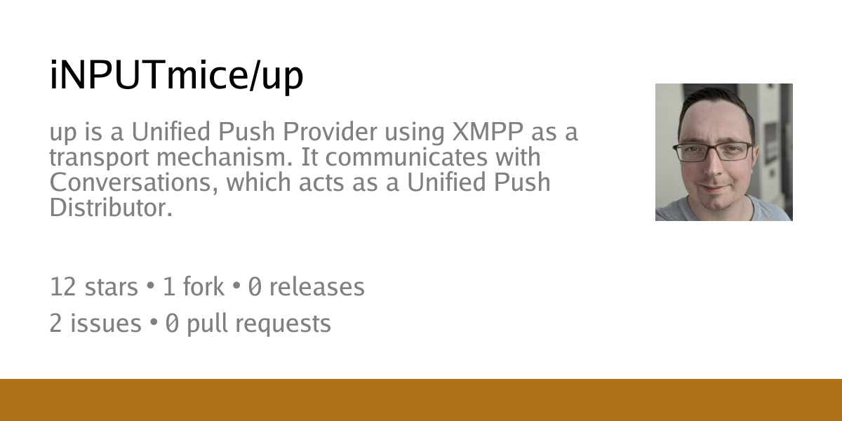

This is based on my understanding of what conversations.im does - I think it acts like a UP provider with XMPP as the transport and Conversations-the-app (or a background service of it) provides a UP distributor.
Also, according to my understanding, Unified Push doesn’t specify the protocol between provider and distributor, so my question was if you would consider adding the protocol defined here:

Conversations and its derivatives acting as a UnifiedPush provider is different than XMPP push notifications. A UP provider is using the XMPP server as the actual push service mechanism for UnifiedPush traffic. XMPP push notifications via XEP-0357 are push notifications from the XMPP server for messages and whatever else to a target device.
In the case of Foghorn, Mozilla’s push service is acting as the UnifiedPush provider, similar to the Sunup Android app. I plan to eventually add at least ntfy.sh and NextPush (NextCloud). I’m not really sure I will add XMPP as a UnifiedPush provider because it doesn’t entirely make sense if the XMPP connection can go down and be disconnected. I haven’t checked to see if UnifiedPush over XMPP can make use of XEP-0357 or not. And if it does, then you’re back to needing another UnifiedPush service. So running UP push provider mode would be mutually exclusive with push notifications for Livewire.
