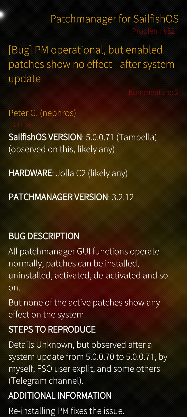

I find it weird that this does not seem to happen. Somethings amiss. We do have some, rare, race conditions in PM but still…
For me it works on two phones X10 and X10II. The own reason could be, that I installed and unsistalled the original patch from here. Maybe it copy anythinks on the phone what you not have. I tested it always with the root filebrowser. You can also do it without restart the Homesrceen.
Maybe you not activate the 64 bit option in patchmanager and some line create a 32 bit world on your phone? I had this also because I started the patchwork at my old 32bit X10 phone and moved later to my dayly phone X10III.
But I think than the patch bring false? I had also a problem with restarting the homesreen because a data collector from datascope app.

Hi !
I have found the problem.Read a bugreport on chum-developers that PM works but shows no effects. So I installed PM from ChD and now it works. Thanks for your effords. Greetings from Austria.
