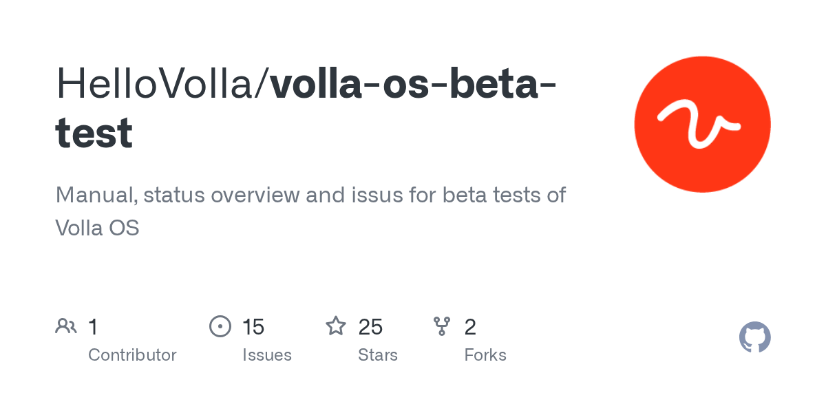

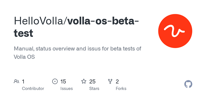

The changed components are shipped since April 2021 as you can see here:

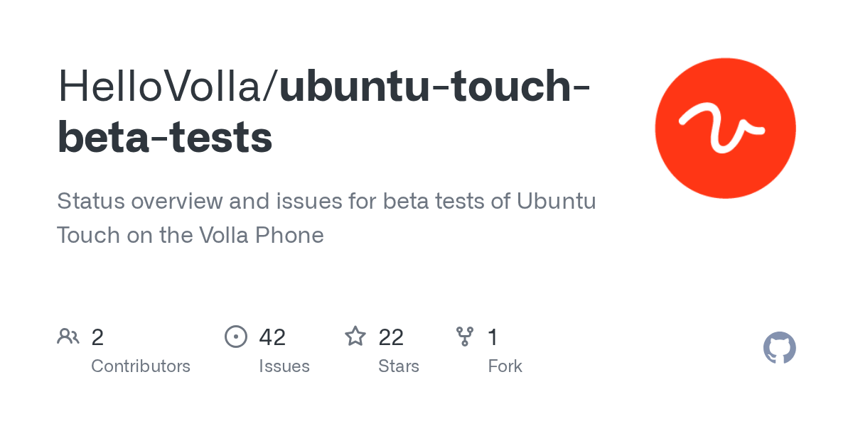

I don’t know if this helps, but here is stated, that with OTA 10 in Ubuntu Touch, the camera driver is fixed for UT.
