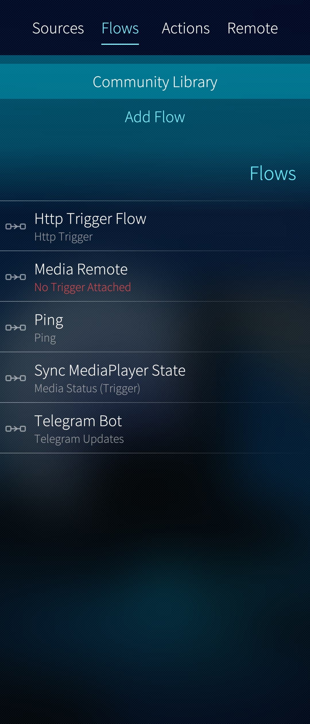

Someone with a J2 could add it to the Automagic community library, means the switch could practically do anything.
That’s where the community library comes in. If one user figures it out he/she can share either just the trigger settings or the finished automation with every other Automagic user, making it trivial for others to set it up.

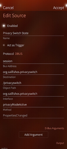

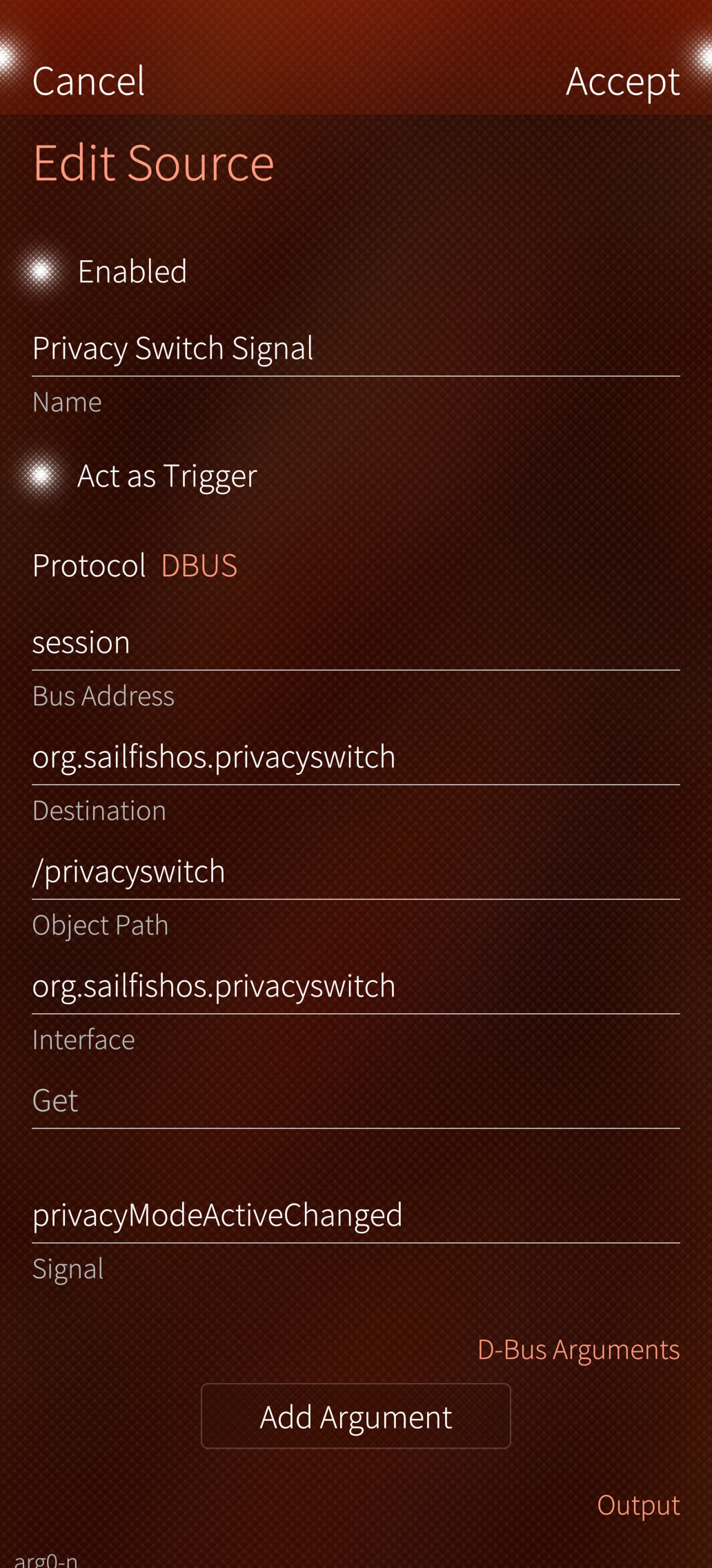

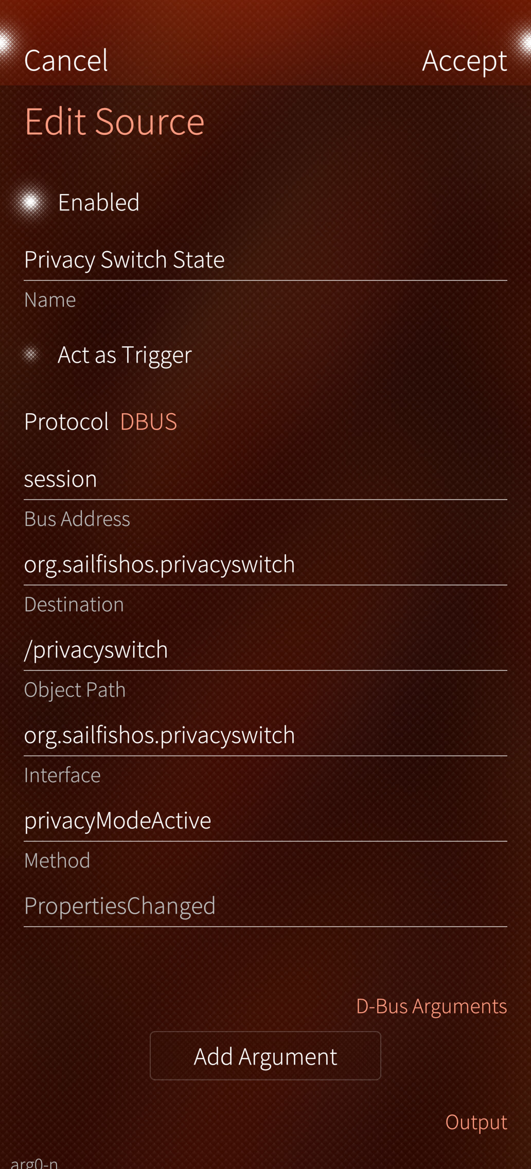

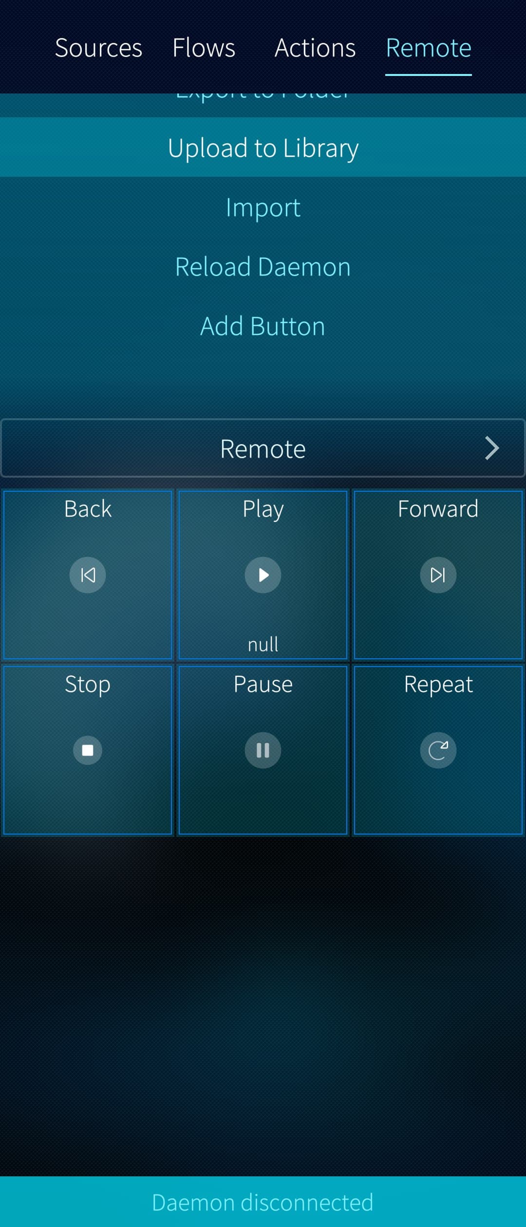

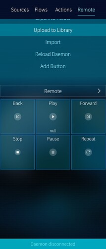

Do these look right? I suppose…
I have pushed these to the library for testing.

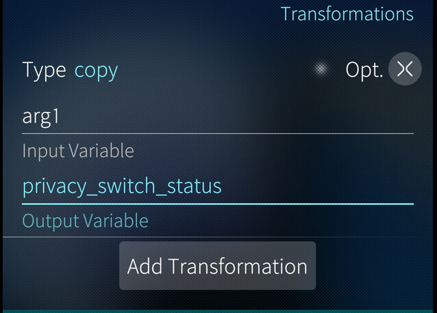

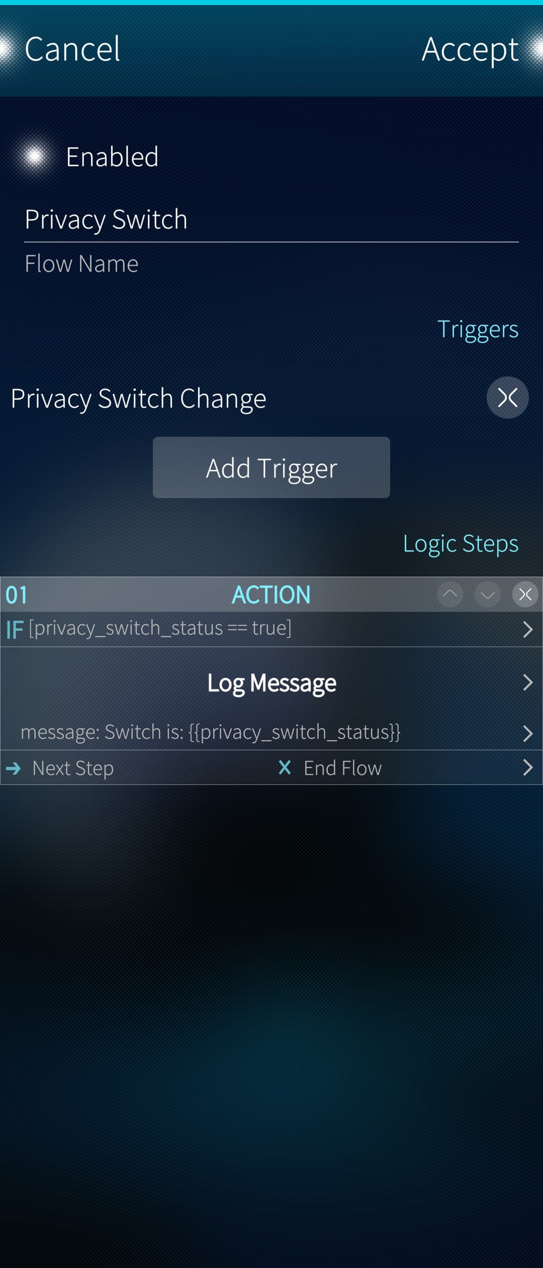

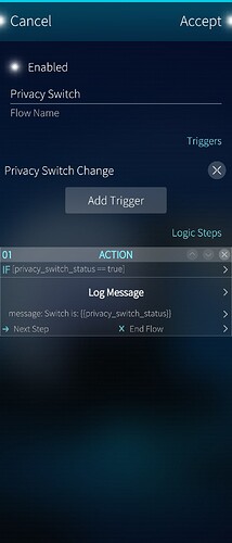

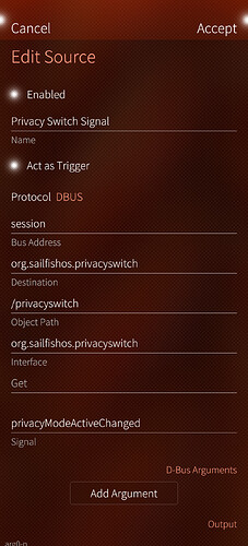

You likely will have to pass the return values into a output variable, like in the Media Status (Trigger) from the Media Player Monitor example.
Then the variable should be available in the flow and it can check/display/pass it’s value:
