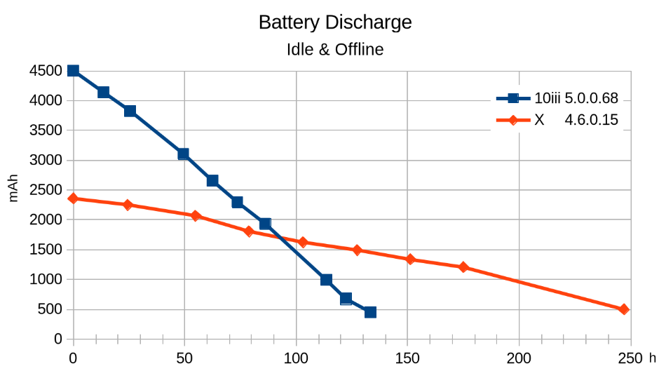

I recently had to start using my 10iii for mobile network reasons (LTE), but before putting it to use I checked its idle consumption. Test procedure: Charge device, reboot, leave it idle with all radios and GPS off, occasionally check battery level.
Let me present the two contestants in this challenge:
  • In blue: Xperia X 10 iii, unused with a handful of charge cycles, flashed with 5.0.0.68
  • In red: Xperia X, bought second-hand and used as daily driver for 6 years, originally on 2.0.x and upgraded to every release until 4.6.0.15

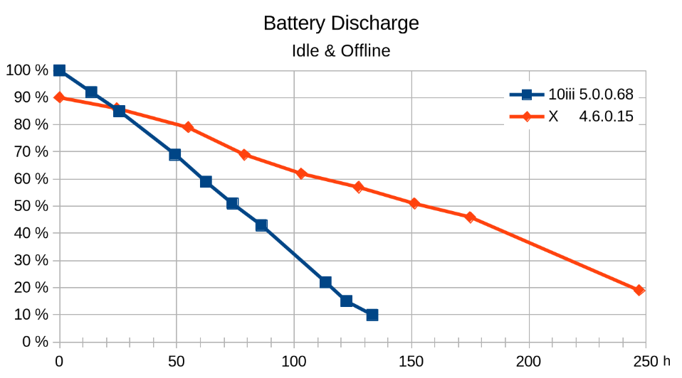

The 10iii is holding up pretty well, but I realized the comparison was unfair. So I decided to plot the actual remaining charge in the battery instead of percent charge:
I think this shows the 10iii’s powerful, octacore idle better, half the endurance (5 days) on a battery that is twice the capacity.

Great analysis! to me it actually highlights a problem with idle consumption since a 6 year old phone with daily usage is able to hold battery levels for sooo much longer (100hrs) compared to a newer phone with better (maybe more efficient??) CPU and twice the battery capacity.
A more fair comparison would be to use 4.6.0.15 for both so the OS "should” behave the same and the difference would be the adaptation and the hardware.
Agreed, that would be a more apples-to-apples comparison. However, the 10iii is now my daily so I prefer not to start over after a re-flash…
The Xperia X has stayed in surprisingly good shape, especially since it was already used when I bought it to try out SailfishOS. I don’t think the battery has degraded much, and I can only hope the 10iii will be as good. I am worried, though, that the higher consumption may lead to more frequent recharging, wearing the battery out in a shorter time. But the difference is probably smaller in actual use than in the idle/offline-scenario in the test, and the 10iii has a bigger battery, keeping cycles down a bit…
The real issue is that I can compare both the factory Android, and the SF to show a difference of 3x. It has nothing significant to do with SF version number, or (factory) Android version number. Jojomen’s test shows 0.67%/hr vs my original value of 0.75%/hr when starting the thread, i.e. unchanged. (vs 0.2% for factory android)
It is most glaring with all radios turned off. This is a state where the phone should be drawing current only to keep the ram alive - nothing else.
