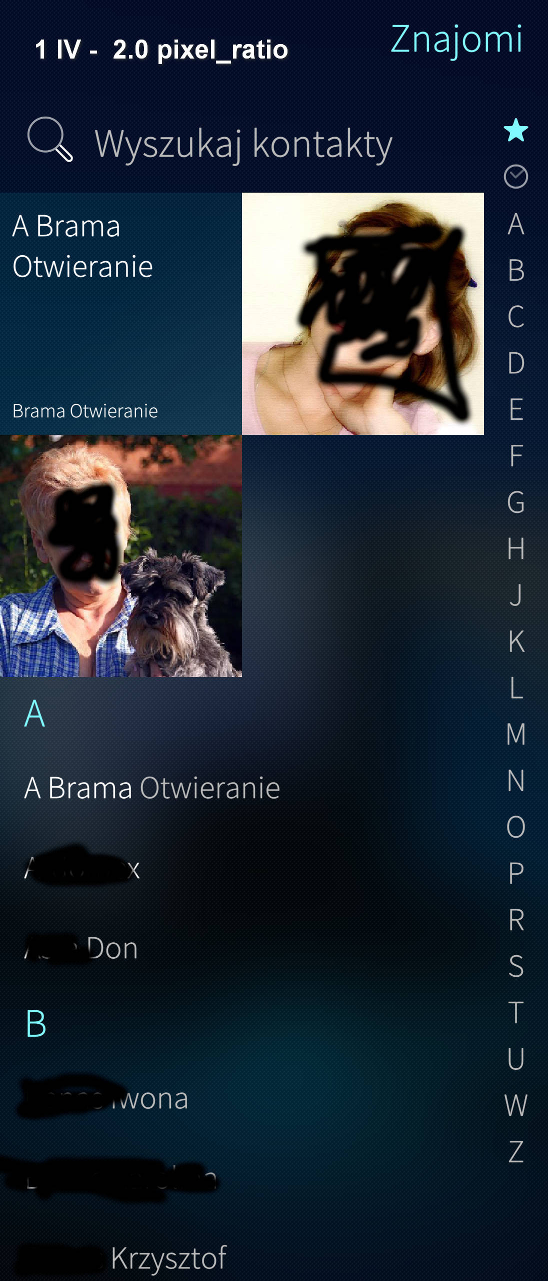

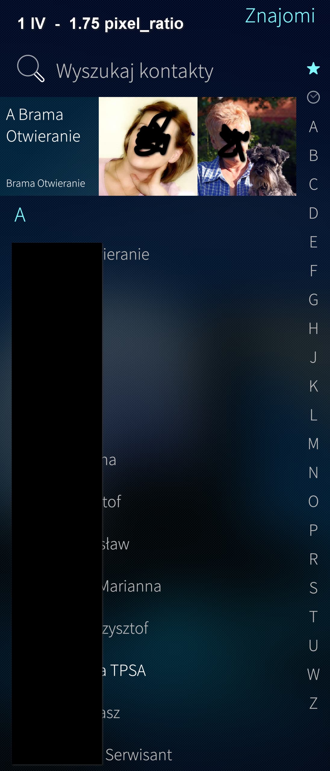

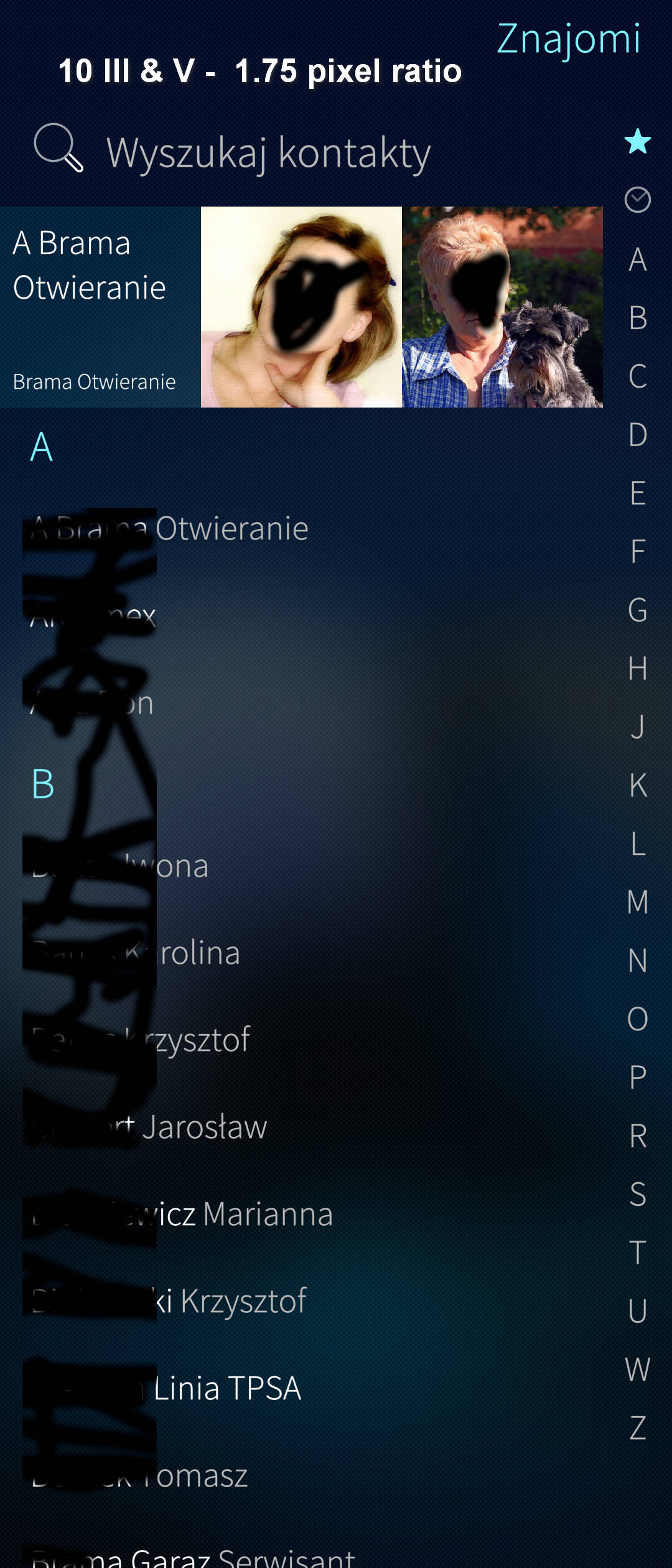

I’ve looked up several places, including e.g. GitHub - mer-hybris/hadk-faq: FAQ for Sailfish OS porting guide (HADK)
There are several different (and conflicting) formulas here and there, most of them don’t even give results matching pixel ratio values used by Jolla in their official SFOS ports, so I ignored those. I gave attention to the last (i.e. most recent) one there, which is also the simplest: YourDevicePPI/245 PPI. Therefore, 420 PPI of the 1 IV with 1096x2560 resolution / 245 PPI = 1,71 pixel ratio, so the closest matching one is 1.75.
Compared to this, the other (quite complicated) formula listed there and also labelled as “new” (diagonal size in inches / 4.5 * horizontal resolution / 540 ) gives completely different (and absolutely crazy) result of 2.91, which isn’t even a supported ratio. For the 10 III, which has an official pixel ratio value of 1.75, it gives 2.66 which is also utter cr_p. The third (oldest) one gives some silly result, too. So all those formulas are actually worth s***t if one contradicts the other and they don’t match Jolla’s values, aren’t they?
The XA2 Ultra (1080x1920, 367 PPI, i.e. both quite smaller than all the models listed above), has an official pixel ratio of 1.5. That simplest and most recent formula (YourDevicePPI / 245) gives 367 / 245 = 1.49, i.e. almost perfect match with the officially used value, whereas all the remaining formulas give wrong values. Therefore, clearly, it is only that last formula which gives sane results matching Jolla’s official values used in their official SFOS ports.
The 5 IV, 10 III, 10 V all have almost identical resolution of 1080x2520 (the difference vs. 1 IV’s 1096x2560 is completely negligible) and all of them have pixel ratio of 1.75, and that even though they have physically smaller screens (6.1, 6.0 and 6.1 inches respectively), so their PPI value is actually even higher (in the 440-460 PPI range) than 420 PPI of the 1 IV (when it uses 1096x2560 resolution rather than 1644x3840). So, theoretically, 1 IV’s pixel ratio should actually be even slightly lower than theirs, and not higher (but as we need to choose the closest one from the defaults, we still end up with 1.75 anyway).
Finally, as I wrote, only when set to 1.75, the UI of the 1 IV gets identical look and proportions as on all other devices - exactly the same amount of content fits on screen, UI elements and fonts have identical sizes as on all other devices, etc. Isn’t it obvious that the UI should have the same proportions and relative sizes accross all devices? Why would the 1 IV’s UI have everything so much bigger than all other devices? Obviously, it should not be the case.
The following three screenshots show respectively:
  1. 1 IV UI when pixel ratio 2.0 is used
  2. 1 IV UI when pixel ratio of 1.75 is used
  3. 10 III, 10 V, 5 IV (and more) with their pixel ratio of 1.75
I think they clearly show which value is the correct one…
Please note that even if pixel ratio value got changed from 2.0 to 1.75, you wouldn’t lose ability to use current enlarged proportions if they are better for your eyes. You’d only need to switch the font size setting from “Normal” to “Huge”, ending up with precisely the same proportions as what you have now.
