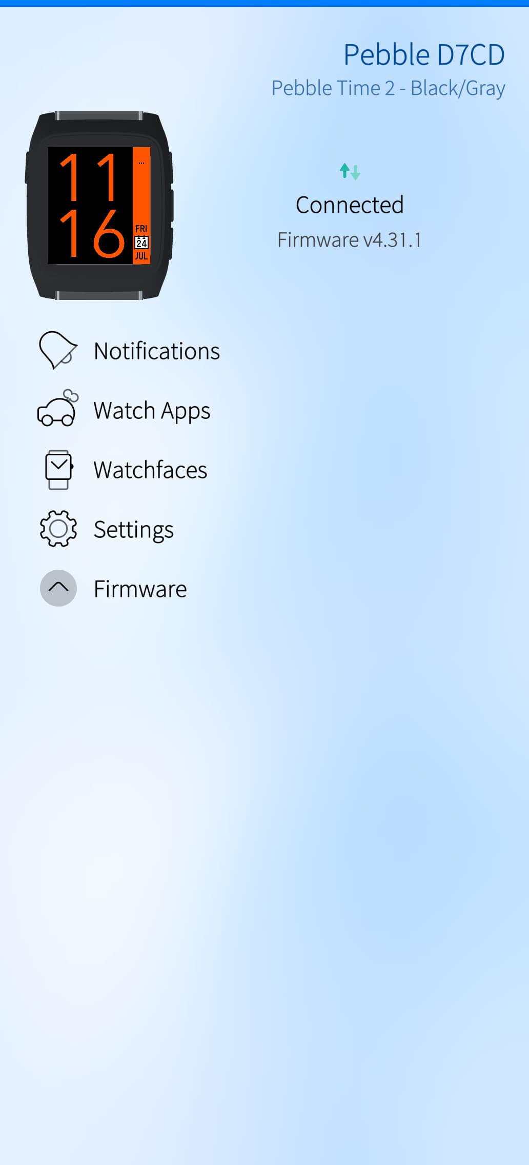

Work in progress. Lots of thanks to @JPlexer for adapting the official Pebble app backend to Rockpool!
