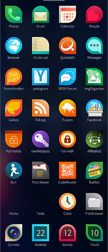

Not a big deal, but I have lost all of my icons for browser pages which had been added to the app grid. The ‘browser apps’ are all still there, but with no icons
