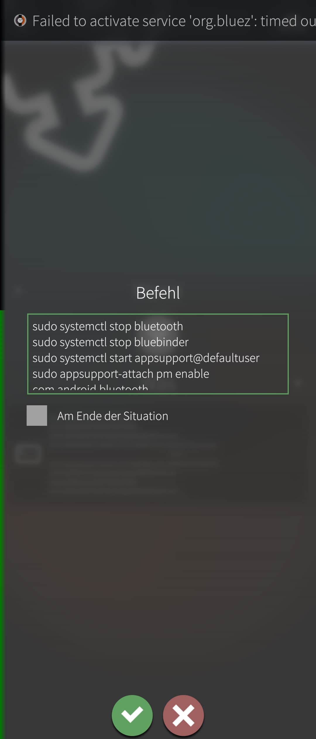

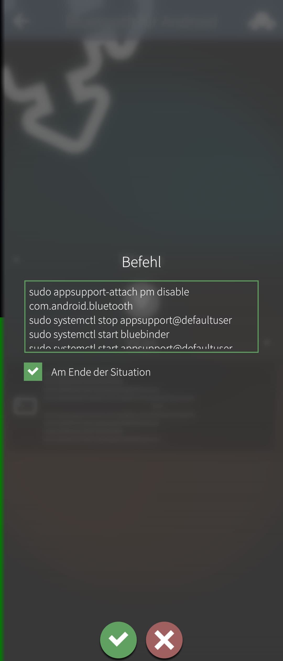

  2. Than create follow commands in ShellEx or in Situations!
Name 1: “BT AppSupport On”
   sudo systemctl stop bluetooth
   sudo systemctl stop bluebinder
   sudo systemctl start appsupport@defaultuser
   sudo appsupport-attach pm enable com.android.bluetooth
Name 2: “BT AppSupport Off”
   sudo appsupport-attach pm disable com.android.bluetooth
   sudo systemctl stop appsupport@defaultuser
   sudo systemctl start bluebinder
   sudo systemctl restart bluetooth

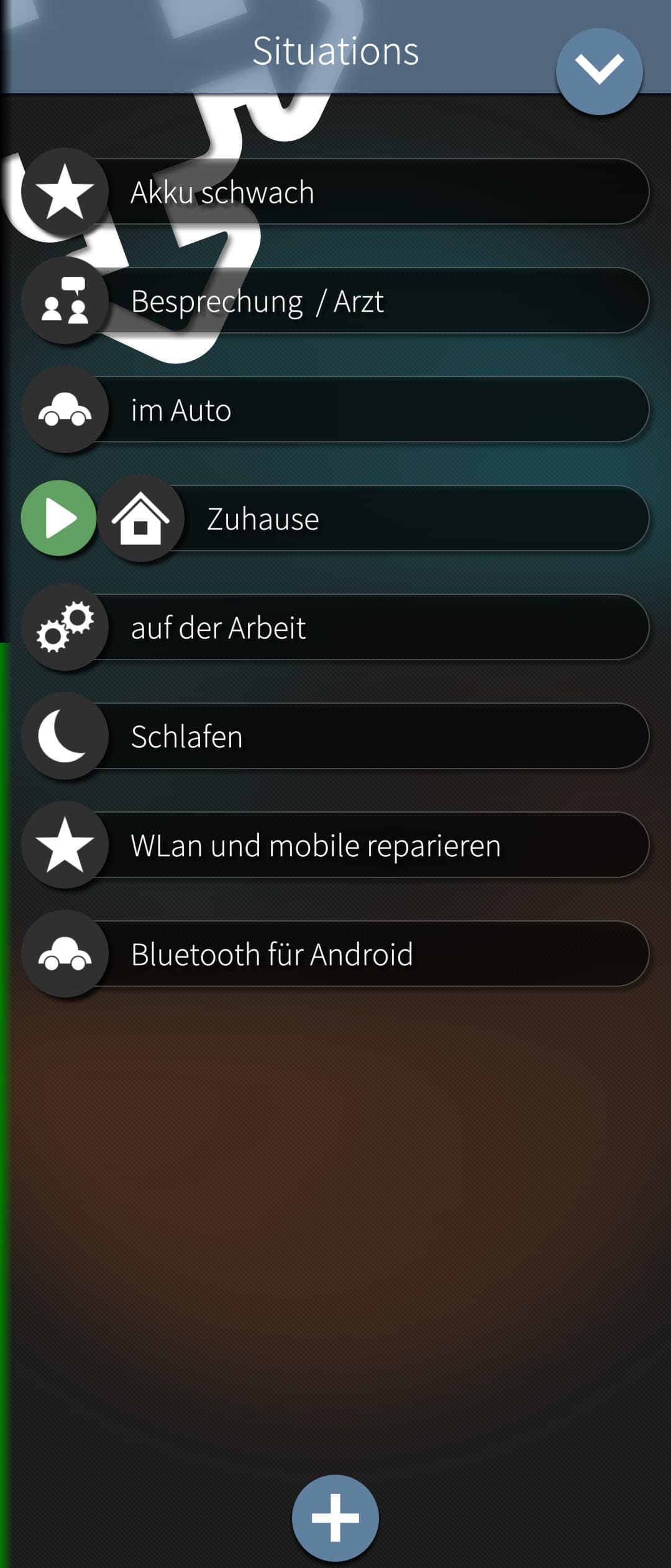

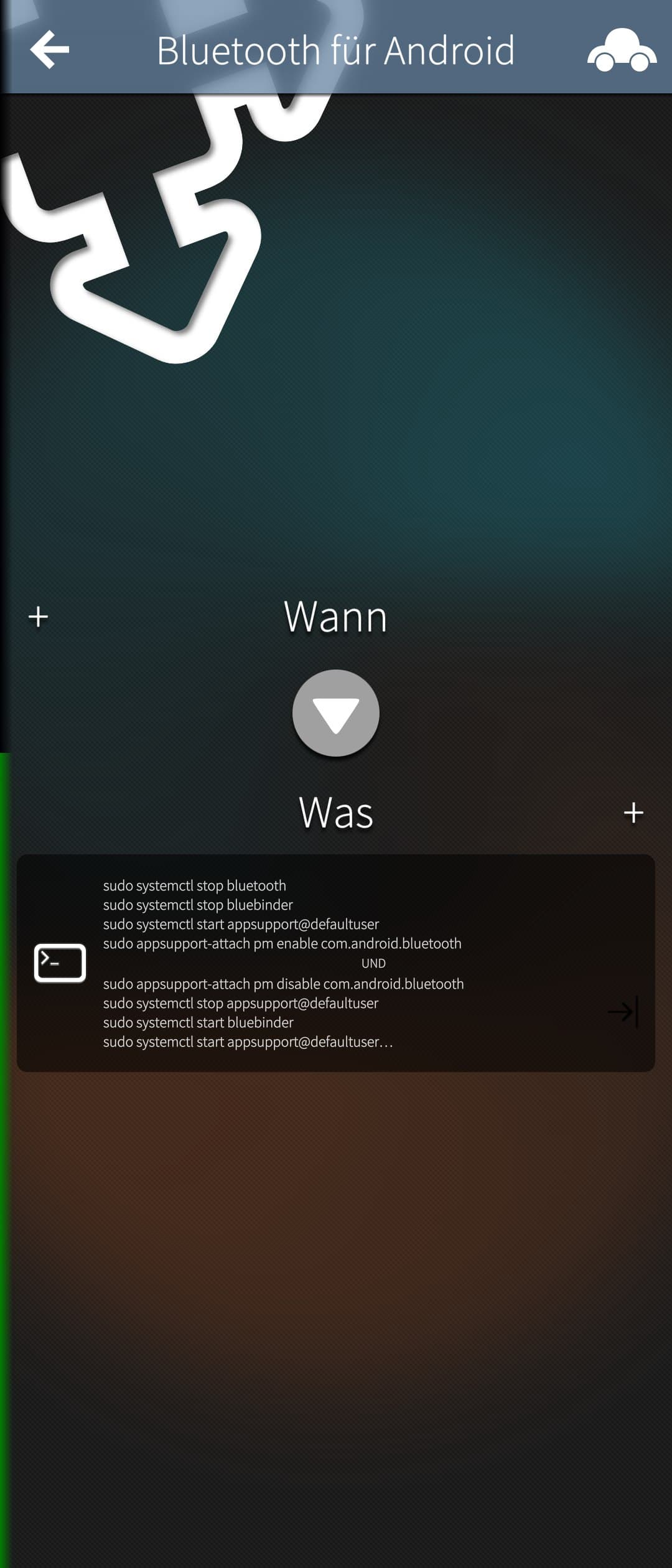

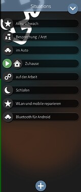

In Situations you can also bring the command blocks and it’s possible to create only one Situation because you can run the commands at start and stop from this Situation. So now enough text. :slight_smile:

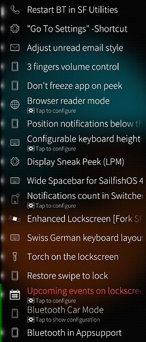

had anybody experiencewitth the Toomenu?
I created two files on my textphone X10 called
  1. /usr/share/jolla-settings/entries/BluetoothAndroid.json
  2. /usr/share/jolla-settings/pages/BluetoothAndroid/BluetoothAndroidToggle.qml
  3. I gave the same rights like the exist folders and files
  4. and reastart the home screen, but its not work - no switches in Topmenu vissible
    Later I want to bring it in a diff file for a small patch.
