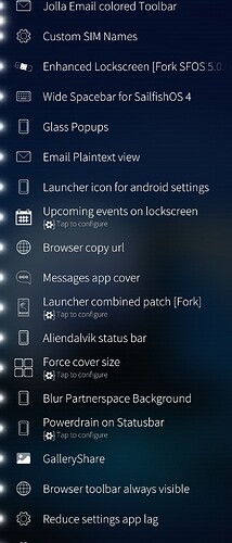

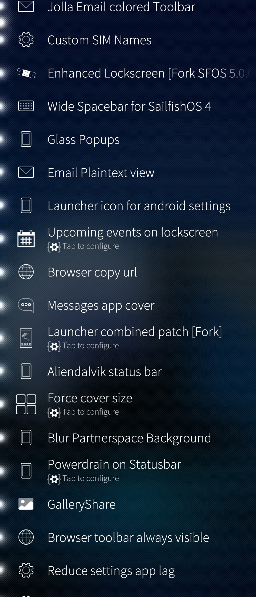

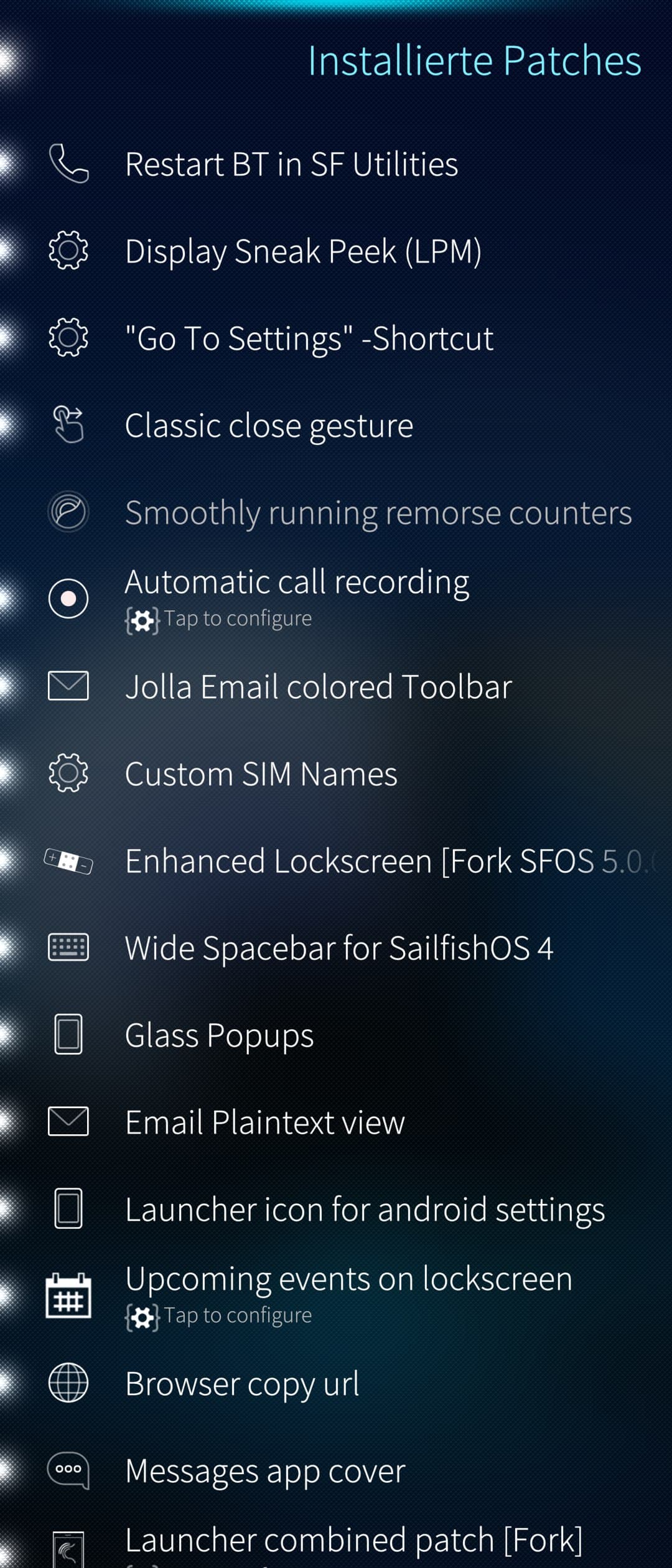

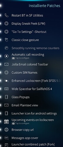

Hello nephros
I tested also the new version from patchmanager. Verry good work. Big Thanks on all developers!
I have only two small optical things on a 21:9 Phone.
  1. the dots for status are on a sony Xperia 10ii to near on the display border
  2. the first dot for the main patchstatus are not unshow if it scrolled
    Here two screenshots for better understanding. It is possible to anable or disable a patch, also no realy problem!
Which qml file I can change to test? Thanks in advance.
