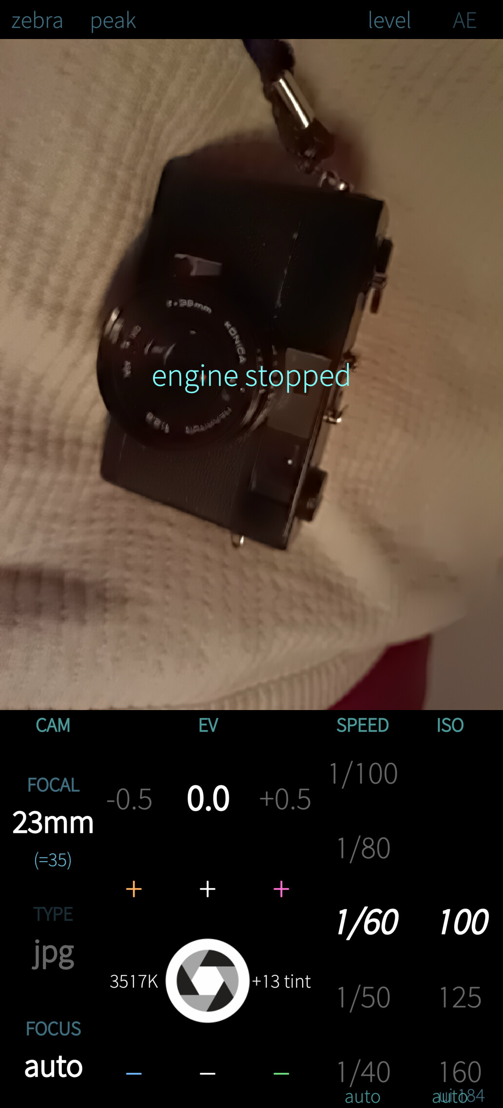

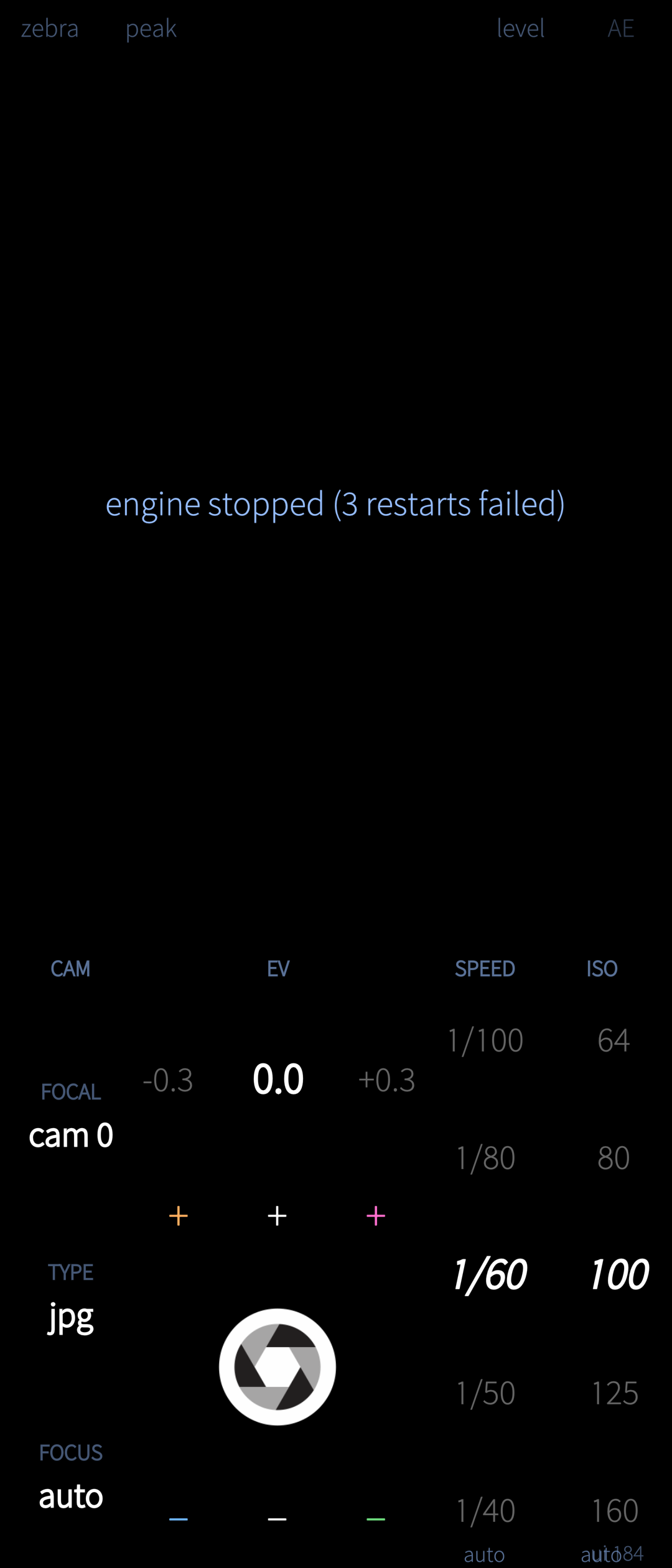

It works but seems a little unstable, got engine stopped’ error a lot.
Also sometimes the exposure goes crazy on the preview, needs a restart to go back to normal.
Love the manual focus!

Back on stopping engine, as @boshtannik, you can send the log, if you like. ( /mnt/sfos/home/defaultuser/.cache/com.rawfish/rawfish-ir/rawfish-ir.log)

This was on the JP2026
Log attached!
rawfish-ir.targz (15.3 KB)
Oh, I was confused by the 23mm written focal length with a 26mm diplayed image.
So, that was the front camera?
Thanks for the log.
