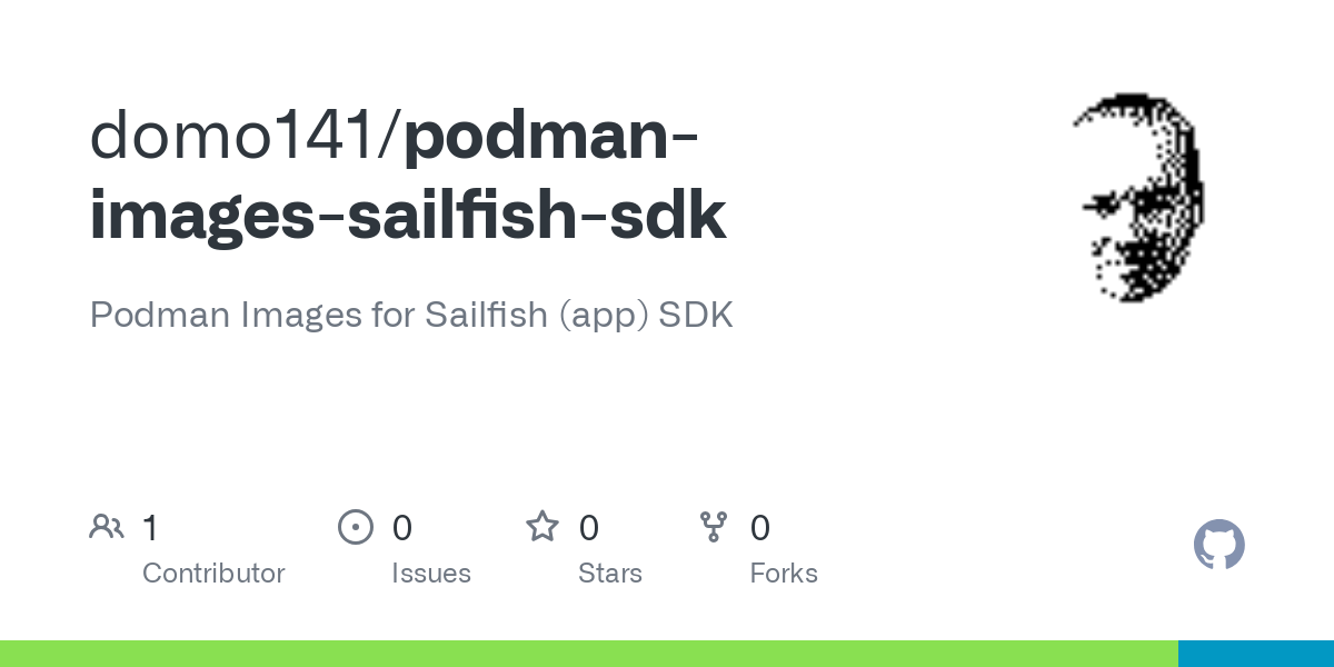

I did this - it worked a while - but bitrot pretty quickly :frowning:
It contains quite a lot of information what had to be tuned (6 years ago) to get it working,
which may be useful if anyone is attempting such a job.
These days I build from command line – using containers in podman
(or just with zig cc -target aarch64-linux-gnu.2.30 or zig cc -target arm-linux-gnueabihf.2.30
on x86_64 linux host)
I should do something with that repo; too much obsoleted stuff laying around there…
Wow, this is quite interesting! So as I understand it - the script extracts the VDI image from the offline SDK and imports it into podman. Also there is some more podman trickery that I dont understand. And finally it fakes the VirtualBoxexecutable to proxy the calls topodman`. This is amazing.
