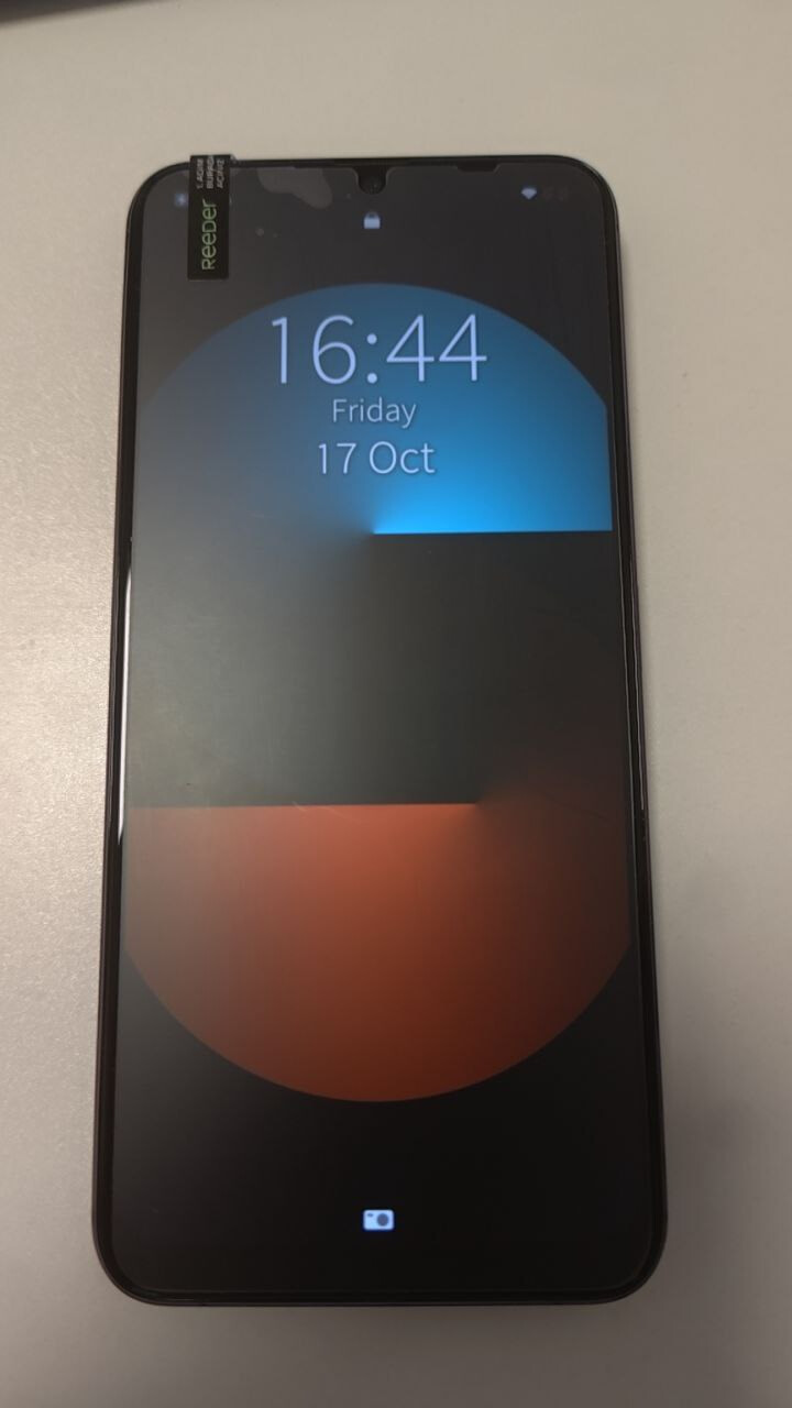

many thanks! Unfortunately :smiley: it worked! I say unfortunately, because now I have no excuse for not going deeper into the rabbit hole of installing SFOS )) but I assume there will be more questions along the road
thank you, I have just unlocked bootloader. In fact, the phone is still in fastboot mode, do I need to restart it, or I can go ahead with fastboot flash comands?
Also, very important for me, you say the update the bootloader via terminal - will I have access to the phone terminal ? With ssh or from phone directly? can you please explain, as it is my first time with SFOS…
UPDATE: for some strange reason, after I sudo fastboot flash-ed the 8 .img files from the instructions and fastboot reboot-ed the phone, it went into SFOS, so I did not have a chance to flash boot with lk.bin

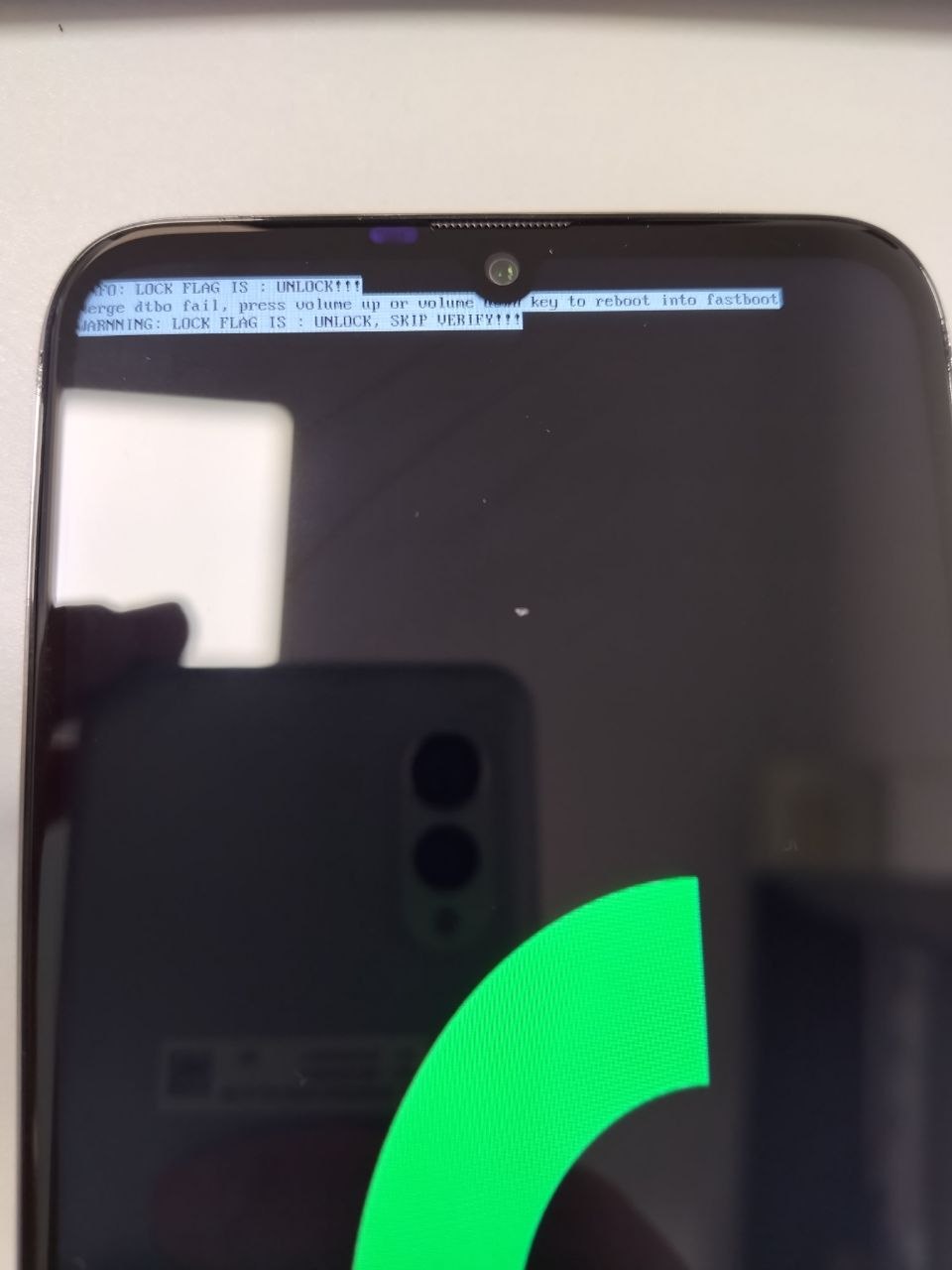

Hello, looking for some advice if anyone had this problem before:
Today I tried the same process with my second Reeder, but something went wrong.
I activated OEM unlock and USB debugging in Developers options, then rebooted bootloader and run unisoc_unlock unlock - the result was success, bootloader unlocked:
Preparing to unlock the bootloader
OEM ID: xxxxxxxxyyyyyyyy
Download signature
Unlock bootloader, pls follow instructions on device screen
Bootloader unlocked.
without rebooting or disconnecting the phone, I then went ahead and run all 8 sudo fastboot flash commands, they all executed fine.
I run at the end fastboot reboot and have a message that “merge dtbo fail…” please see the picture in the link below

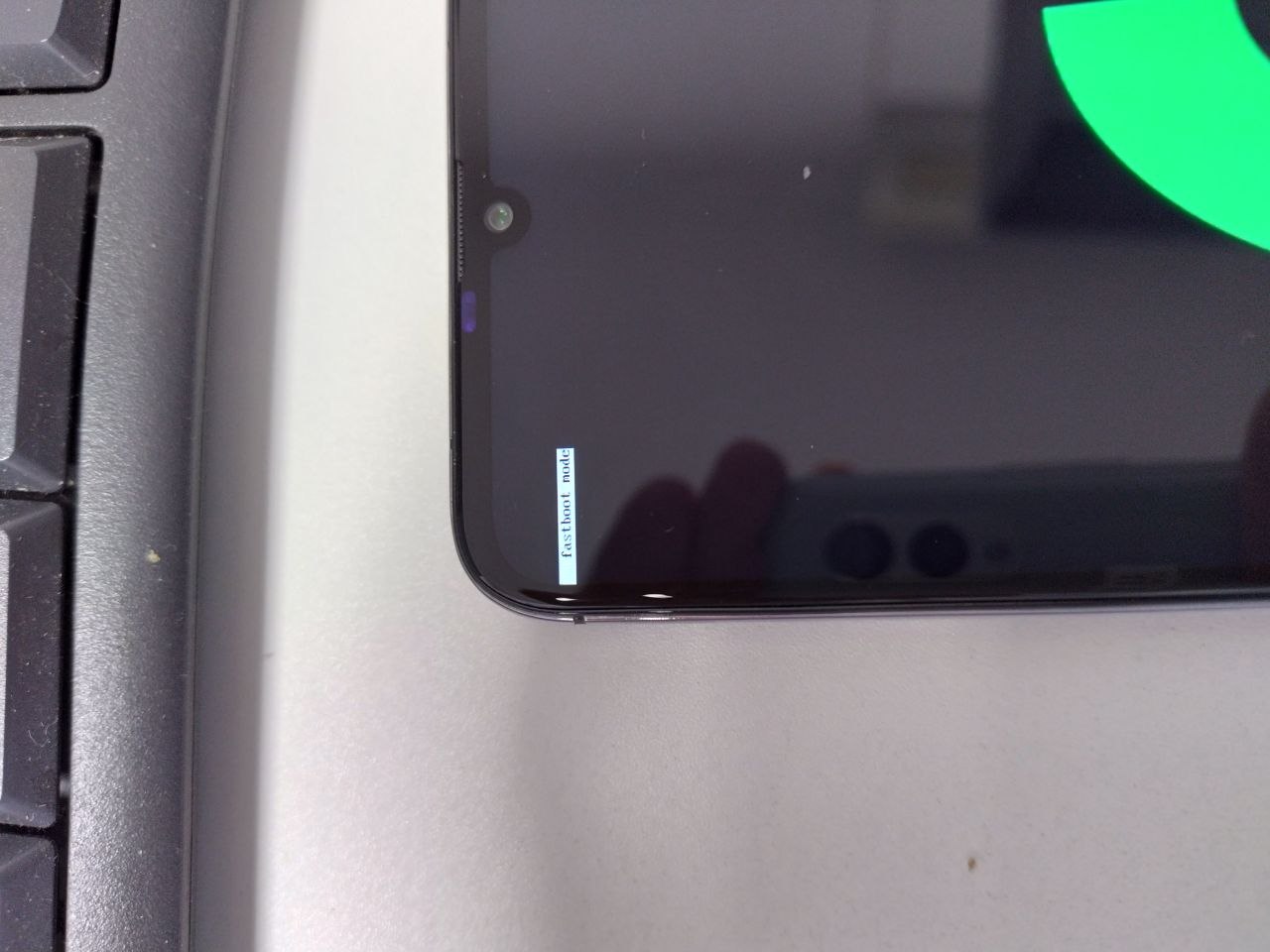

I choose vol down and the phone vibrates and only displays “fastboot mode” on the screen, but when I try fastboot devices command, no device is detected.
Anyone knows how to repair this please?

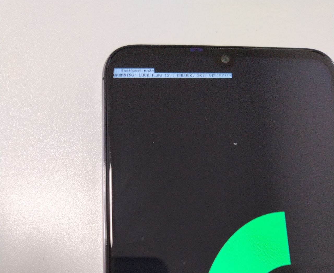

after holding volume up or volume down with power button, I get a different fastboot mode:
I am stacked at exactly this error screen. Can you please explain how did you solve this problem?

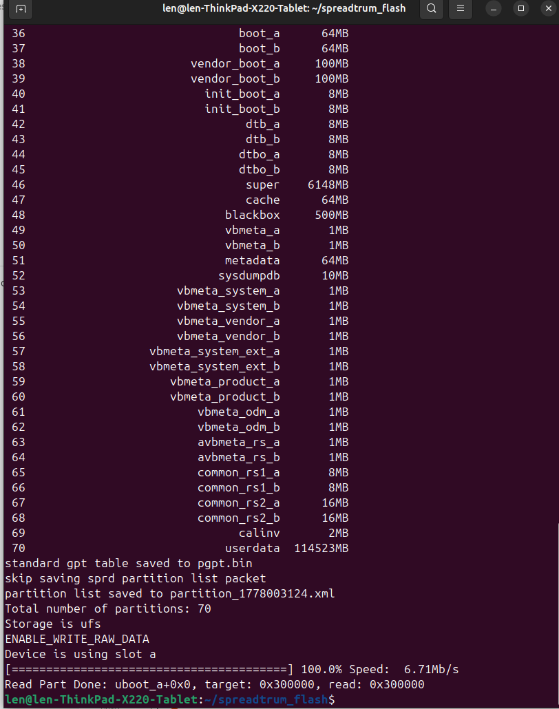

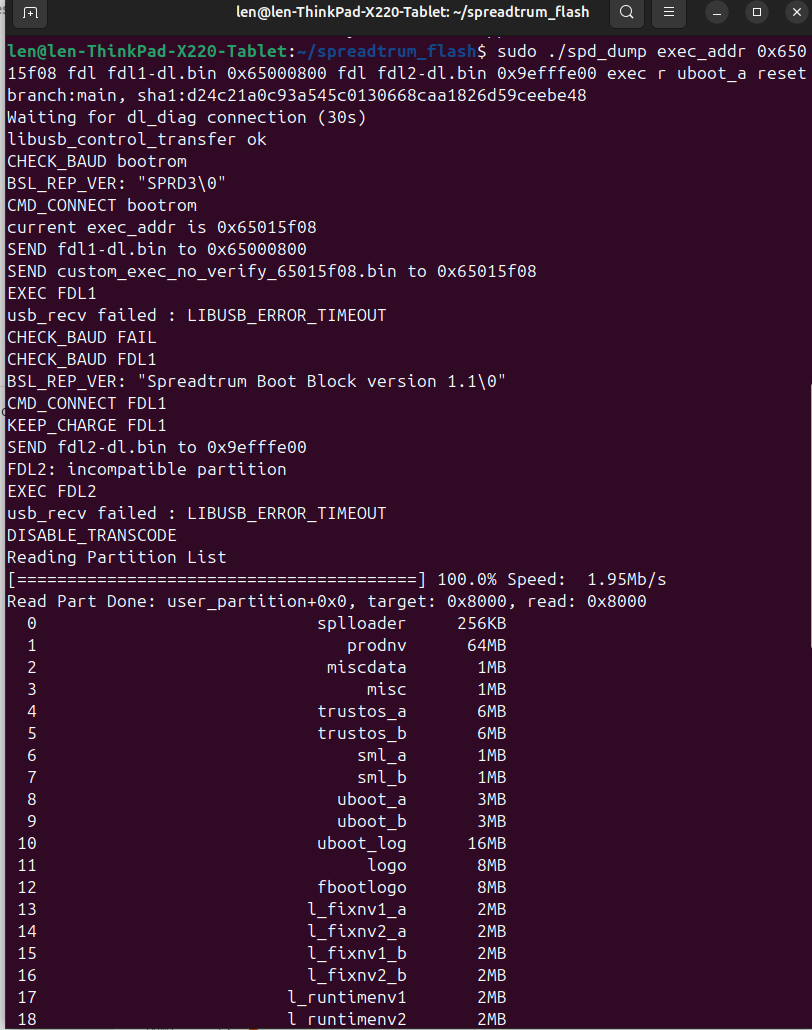

@affe_null Hi, I tried to follow the guide, but I have some questions:
  1. there are several errors on the screens above, can it be due to the fact that I used the ums9230_universal_unlock_EMMC.zip rather then ums9230_universal_unlock_UFS.dangerous.zip ? I only saw at the end of the terminal screen that the memory is UFS, but then again the archive has word dangerous in it - a novice like me was afraid to use it. I feel I am close, but every step is unsure, and not too many people around here lately to ask…
