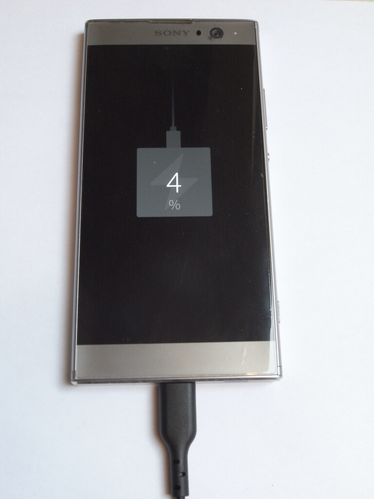

EMERGENCY: Xperia XA2 won't charge, won't back up files, battery at 15%
He had a socket problem. I proposed this idea to allow charging for backup before surgical operation.
But it is no more of actuality, he backed up correctly.

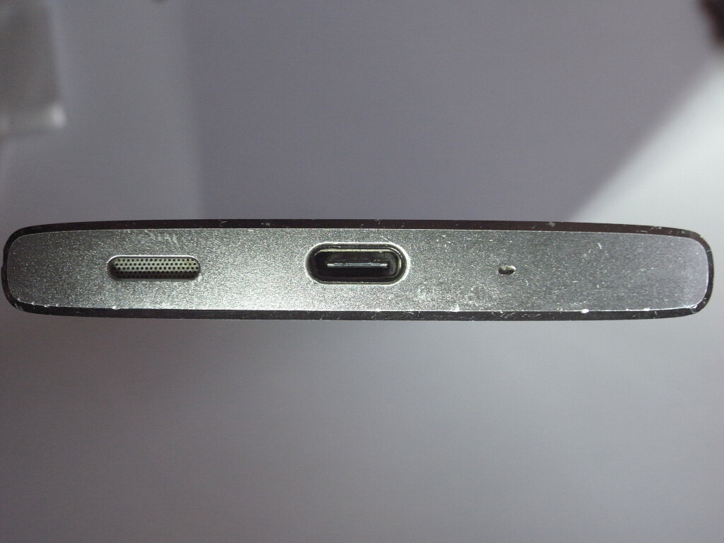

How likely is it that replacing the USB board will fix this issue? Trying to decide whether to buy a new phone or try to fix this one…

If really the USB socket is damaged, the replacement of the USB board will surely fix it. And please consider that the Sailfish OS licence is tied to the mainboard of the phone because IMEI is stored there. So I would rather suggest to repair the phone with a new USB board.

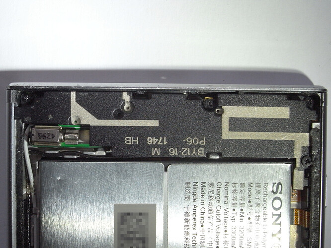

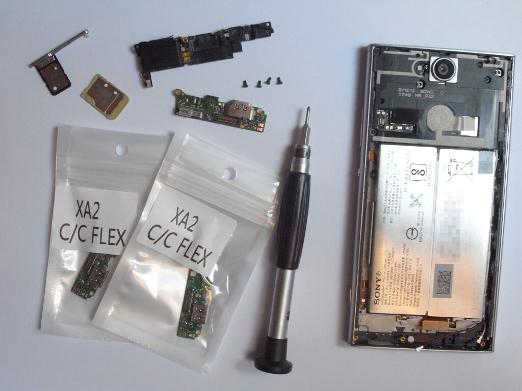

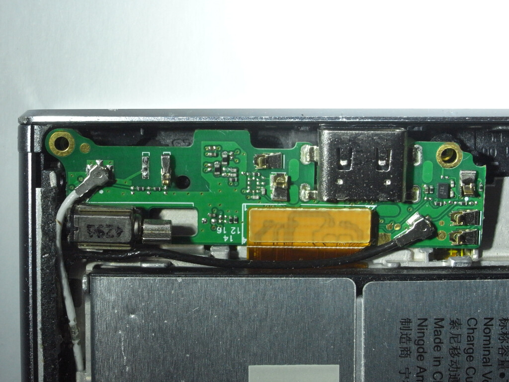

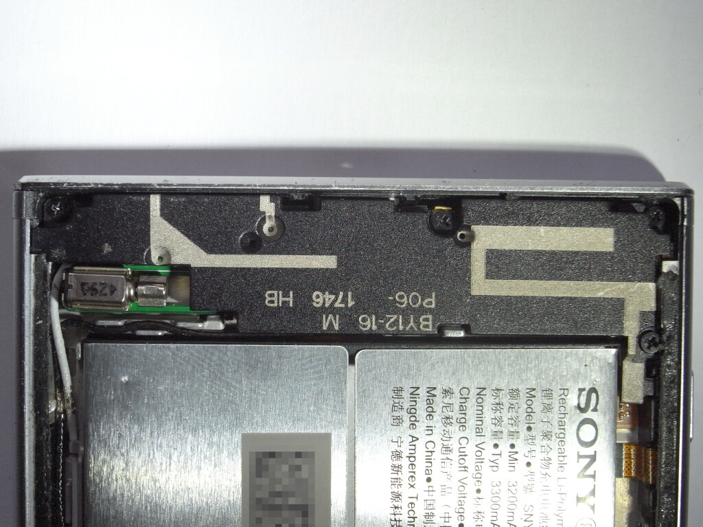

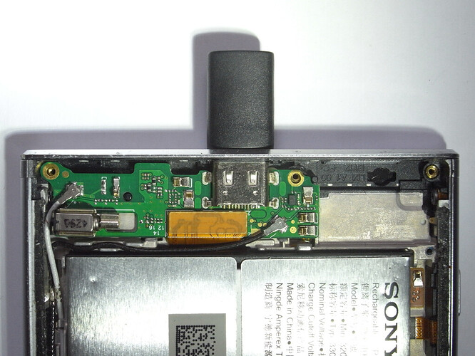

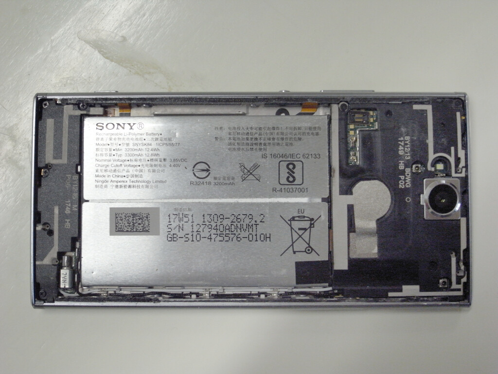

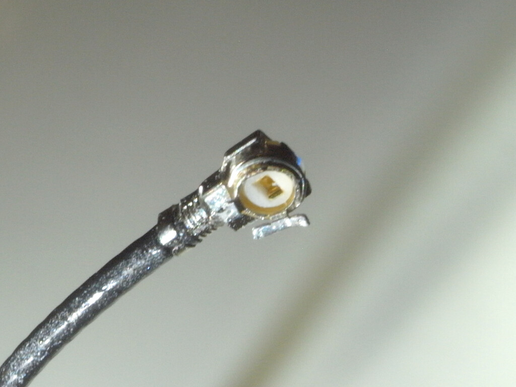

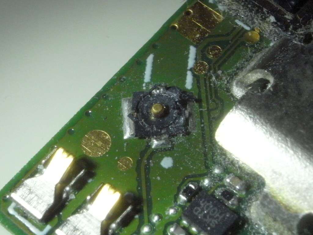

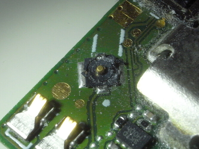

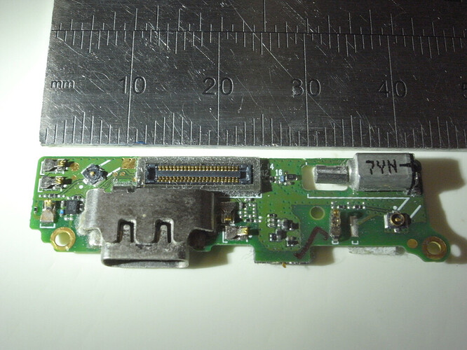

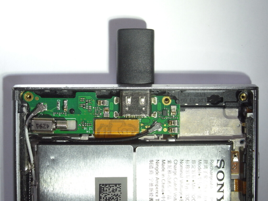

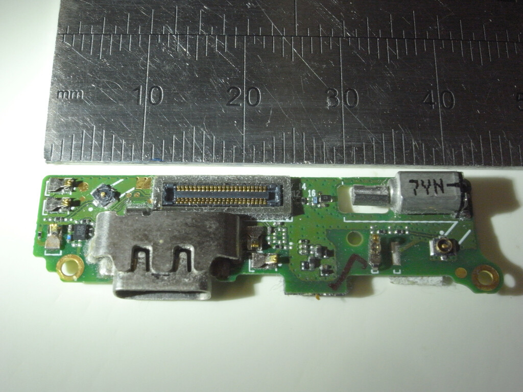

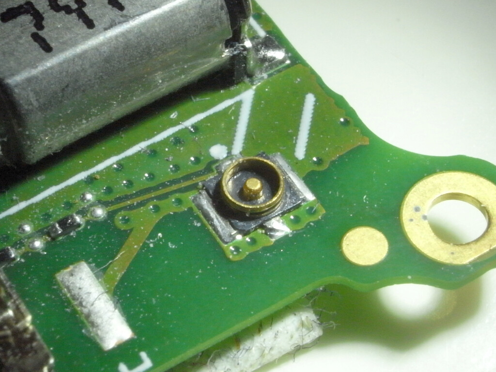

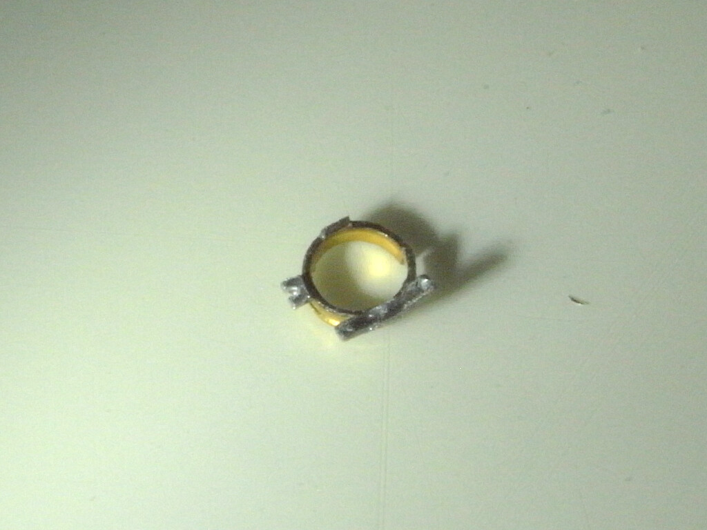

Ok, I got inside the phone, using a hairdryer and a plastic spudger - and plenty of patience. Nothing was damaged, but when I got to the USB board and unplugged the antenna connectors (some micro U.FL style connectors) one of them broke and the outer ring (~1.5mm dia) came off the PCB. I was able to extract this piece from the connector on the cable, so the cable should still work if I get a new USB board. Best of all: with the USB board removed I have confirmed that the short circuit is still present; the board will rapidly heat up if plugged into a USB host. That greatly increases the likelihood that the problem will be fixed by replacing the board.
Good work and good news! I hate trying to take modern glued-together phones apart.
I wonder if the overheating you experienced has contributed to the aerial connector being fragile (right near the USB connector I notice).
Thanks for posting good pics too for future reference, though I hope I will never need them! And if your phone is broken, how did you take photos…?!
There are old fashioned things still existing, like cameras… :wink:
@cwo Congrats! and from me also thanks for the interesting pics!

Edit: I have now ordered not one but two replacement USB boards. There is no other phone on the market that ticks my boxes, so I guess I’ll be stuck with the XA2 for some time.

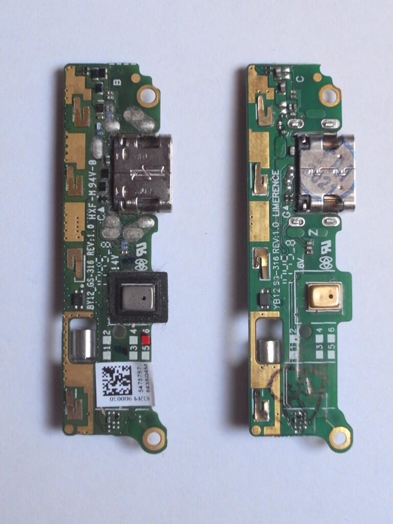

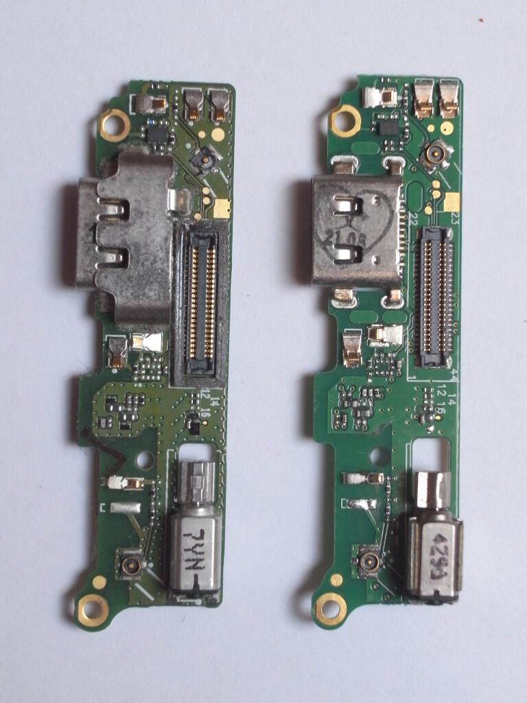

I finally got the replacement USB board today, and although it’s clearly a cheapo compared to the original board I am happy to report it works!
Thank you for this detailed report.
Hardware things gives us some recreation and instruction.
Great news, and thank you for more great pics!
