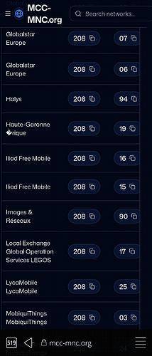

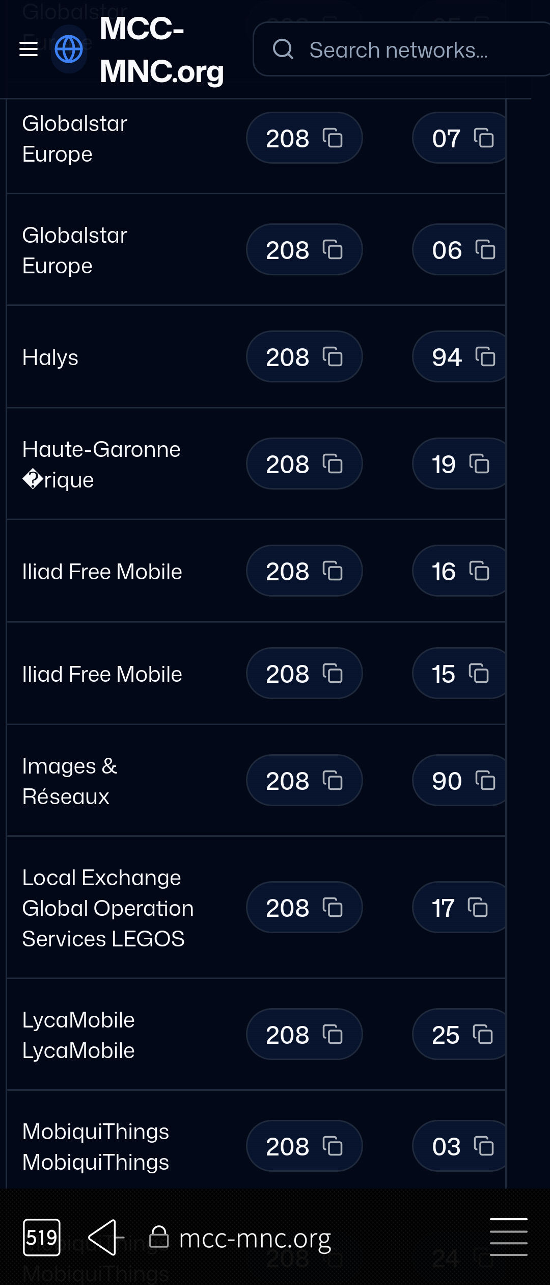

How did ppl figure out the magic S8683.1 directory on the XII? Seems like modem on xz2 (based on https://xdaforums.com/t/xperia-xz2-quest-for-a-volte-vowifi-support-mcfg_sw-mbn.4645992/), what’s the magic number for XIII?
Edit: yeah that just seems to correspond to mcc/mnc of 208/15
<service_provider_sim_config sim_config_id="S8683.1">
    <mcc>208</mcc>
    <mnc>15</mnc>
  </service_provider_sim_config>
according to https://raw.githubusercontent.com/sonyxperiadev/SonyOpenTelephony/refs/heads/master/ModemConfig/res/xml/service_provider_sim_configs.xml
which matches
AFAICT, it isn’t magic tied to the phone/modem - but the operator config.
