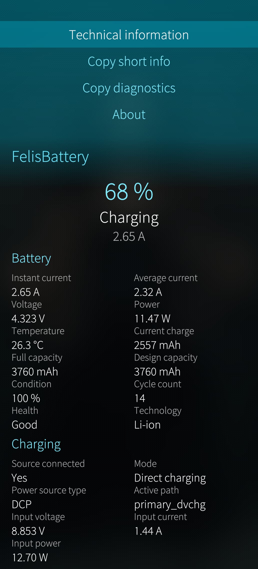

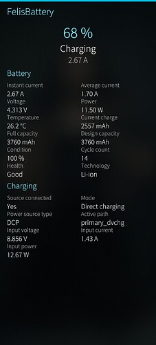

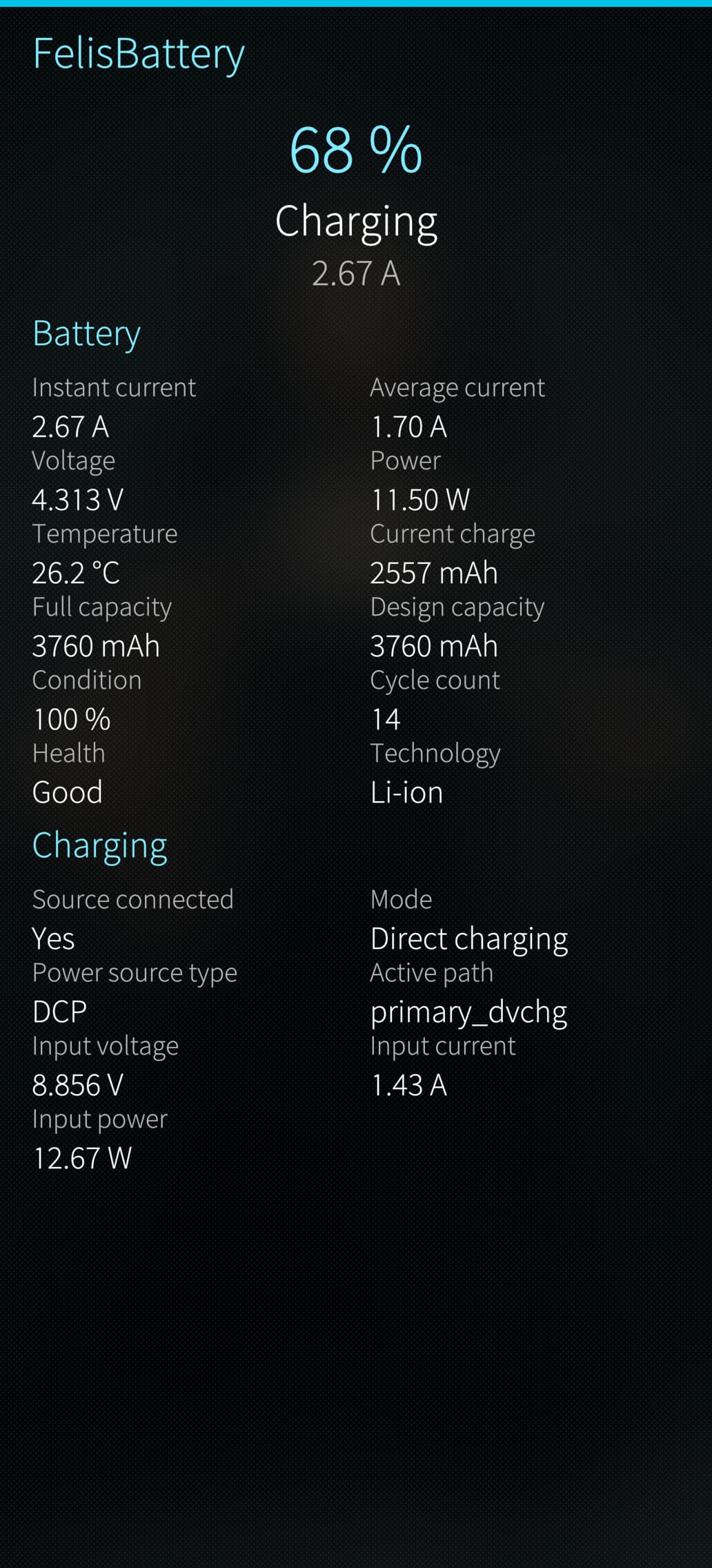

I made a small native Sailfish OS utility for Jolla Phone 2026 which displays battery and charging information in a simple graphical UI.
The main reason was the rather interesting USB-C charging behaviour of the JP2026. Instead of repeatedly checking /sys/class/power_supply/ from the shell, FelisBattery shows the relevant information directly in the application.
It displays battery percentage and status, instantaneous and average current, voltage, calculated power, temperature, charge/full/design capacity, battery health and cycle count.
For charging diagnostics it also shows the detected power source type, active charging path, input voltage/current/power where available, and whether the phone is using standard or direct charging.
There is also a separate technical-information page with the raw power-supply data, and the diagnostic output can be copied to the clipboard for forum posts or bug reports.
FelisBattery is read-only. It does not change charging settings or write anything to sysfs. It runs without sandboxing because it needs access to the low-level power-supply information.
It is designed and tested for Jolla Phone 2026. Other devices are unsupported, but you are of course welcome to try it.

Tested fine Felisbattery with different chargers + conductors:
In all cases:
All cases were detected that something was connected (DCP).
Input current: - (Not detected value).
Input power: - (Not detected value).
JP2 has now 12 % charge.
No use to continue anymore. Set off again.
Hard to belive that all my conductors are full shit.

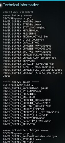

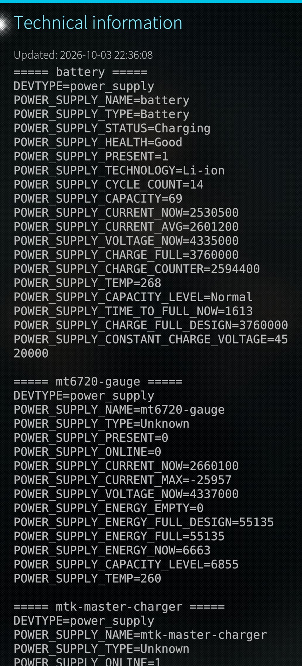

Why does thw report show full capasity to be 3769 mAh instead of 5450mAh
I have no problem with battery, lasts long etc .
FelisBattery 0.1.2
Updated: 2026-10-04 17:06:20
JP2026 charger diagnostics: available
Battery 39 %, Charging
Battery: 3.994 V / 2.57 A / 10.26 W
Charging: Direct charging / SDP
Input: 8.221 V / 1.49 A / 12.22 W
Temperature: 34.5 °C
===== battery =====
DEVTYPE=power_supply
POWER_SUPPLY_NAME=battery
POWER_SUPPLY_TYPE=Battery
POWER_SUPPLY_STATUS=Charging
POWER_SUPPLY_HEALTH=Good
POWER_SUPPLY_PRESENT=1
POWER_SUPPLY_TECHNOLOGY=Li-ion
POWER_SUPPLY_CYCLE_COUNT=81
POWER_SUPPLY_CAPACITY=39
POWER_SUPPLY_CURRENT_NOW=2568600
POWER_SUPPLY_CURRENT_AVG=2589000
POWER_SUPPLY_VOLTAGE_NOW=3994000
POWER_SUPPLY_CHARGE_FULL=3760000
POWER_SUPPLY_CHARGE_COUNTER=1466400
POWER_SUPPLY_TEMP=345
POWER_SUPPLY_CAPACITY_LEVEL=Normal
POWER_SUPPLY_TIME_TO_FULL_NOW=3189
POWER_SUPPLY_CHARGE_FULL_DESIGN=3760000
POWER_SUPPLY_CONSTANT_CHARGE_VOLTAGE=4520000
===== mt6720-gauge =====
POWER_SUPPLY_NAME=mt6720-gauge
POWER_SUPPLY_TYPE=Unknown
POWER_SUPPLY_PRESENT=0
POWER_SUPPLY_ONLINE=0
POWER_SUPPLY_CURRENT_NOW=2650200
POWER_SUPPLY_CURRENT_MAX=-23474
POWER_SUPPLY_VOLTAGE_NOW=3997000
POWER_SUPPLY_ENERGY_EMPTY=0
POWER_SUPPLY_ENERGY_FULL_DESIGN=55662
POWER_SUPPLY_ENERGY_FULL=55662
POWER_SUPPLY_ENERGY_NOW=3876
POWER_SUPPLY_CAPACITY_LEVEL=3905
POWER_SUPPLY_TEMP=340
===== mtk-master-charger =====
POWER_SUPPLY_NAME=mtk-master-charger
POWER_SUPPLY_ONLINE=1
POWER_SUPPLY_VOLTAGE_MAX=1
POWER_SUPPLY_VOLTAGE_NOW=8221
POWER_SUPPLY_TEMP=460
POWER_SUPPLY_CONSTANT_CHARGE_CURRENT_MAX=-1
POWER_SUPPLY_INPUT_CURRENT_LIMIT=-1
POWER_SUPPLY_VOLTAGE_BOOT=0
POWER_SUPPLY_USB_TYPE=[Unknown] SDP DCP CDP PD PD_PPS
POWER_SUPPLY_CHARGE_NOW=4009000
POWER_SUPPLY_POWER_NOW=4009000
===== mtk-mst-div-chg =====
POWER_SUPPLY_NAME=mtk-mst-div-chg
POWER_SUPPLY_VOLTAGE_NOW=8224
POWER_SUPPLY_TEMP=0
POWER_SUPPLY_VOLTAGE_BOOT=-95
POWER_SUPPLY_CHARGE_NOW=4008000
POWER_SUPPLY_POWER_NOW=4001000
===== mtk-mst-hvdiv-chg =====
POWER_SUPPLY_NAME=mtk-mst-hvdiv-chg
POWER_SUPPLY_TEMP=0
POWER_SUPPLY_CHARGE_NOW=4004000
POWER_SUPPLY_POWER_NOW=4013000
===== mtk-slave-charger =====
POWER_SUPPLY_NAME=mtk-slave-charger
POWER_SUPPLY_VOLTAGE_NOW=8232
POWER_SUPPLY_TEMP=0
POWER_SUPPLY_CHARGE_NOW=4001000
POWER_SUPPLY_POWER_NOW=4010000
===== mtk-slv-div-chg =====
POWER_SUPPLY_NAME=mtk-slv-div-chg
POWER_SUPPLY_TEMP=0
POWER_SUPPLY_POWER_NOW=4007000
===== mtk-slv-hvdiv-chg =====
POWER_SUPPLY_NAME=mtk-slv-hvdiv-chg
POWER_SUPPLY_TEMP=0
===== primary_chg =====
OF_NAME=chg
OF_FULLNAME=/soc/i2c@11282000/mt6720@34/chg
OF_COMPATIBLE_0=mediatek,mt6720-charger
OF_COMPATIBLE_N=1
POWER_SUPPLY_NAME=primary_chg
POWER_SUPPLY_TYPE=USB
POWER_SUPPLY_MANUFACTURER=Mediatek
POWER_SUPPLY_ONLINE=2
POWER_SUPPLY_STATUS=Not charging
POWER_SUPPLY_CONSTANT_CHARGE_CURRENT=3000000
POWER_SUPPLY_CONSTANT_CHARGE_CURRENT_MAX=3150000
POWER_SUPPLY_CONSTANT_CHARGE_VOLTAGE_MAX=4850000
POWER_SUPPLY_INPUT_CURRENT_LIMIT=500000
POWER_SUPPLY_INPUT_VOLTAGE_LIMIT=4200000
POWER_SUPPLY_PRECHARGE_CURRENT=1000000
POWER_SUPPLY_CHARGE_TERM_CURRENT=300000
POWER_SUPPLY_USB_TYPE=Unknown [SDP] DCP CDP
POWER_SUPPLY_CURRENT_MAX=500000
POWER_SUPPLY_VOLTAGE_MAX=5000000
POWER_SUPPLY_CALIBRATE=3999
===== primary_dvchg =====
OF_NAME=div2
OF_FULLNAME=/soc/i2c@11282000/mt6720@34/div2
OF_COMPATIBLE_0=mediatek,mt6720-div2
OF_COMPATIBLE_N=1
POWER_SUPPLY_NAME=primary_dvchg
POWER_SUPPLY_VOLTAGE_MAX=9800000
POWER_SUPPLY_VOLTAGE_NOW=8228000
POWER_SUPPLY_CURRENT_MAX=5000000
POWER_SUPPLY_CURRENT_NOW=1455000
POWER_SUPPLY_CONSTANT_CHARGE_VOLTAGE_MAX=4950000
POWER_SUPPLY_MODEL_NAME=MT6720
POWER_SUPPLY_MANUFACTURER=Richtek Technology Corp.
FelisBattery does not calculate the 3760 mAh value itself. It displays exactly what the JP2026 kernel reports:
These values are reported in µAh, so FelisBattery displays them as 3760 mAh.
The physical battery is specified by Jolla as 5450 mAh, so there is clearly a difference between the advertised battery capacity and what the current battery/power-supply driver exposes through sysfs.
I have seen the same 3760 mAh values on other JP2026 devices as well, so this does not appear to indicate battery degradation. In your case CHARGE_FULL and CHARGE_FULL_DESIGN are identical, which is also why FelisBattery reports 100% battery condition.
I don’t currently know why the MediaTek/Jolla battery driver uses 3760 mAh internally. FelisBattery intentionally reports the kernel values without trying to “correct” them.
