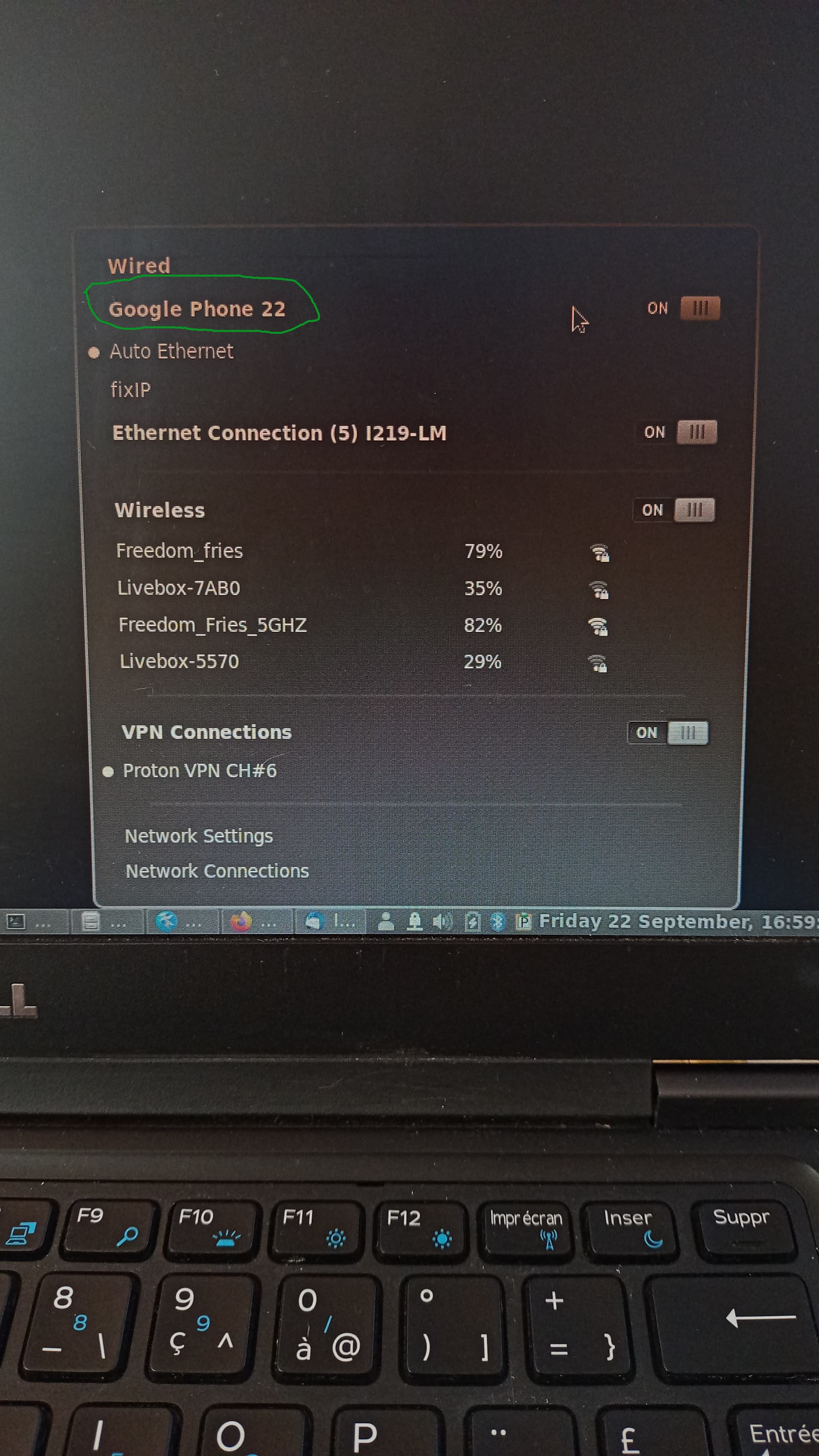

When I plug the SFOS GS5 into my Debian PC:
I meant the small update from .21 to .21. :wink:
