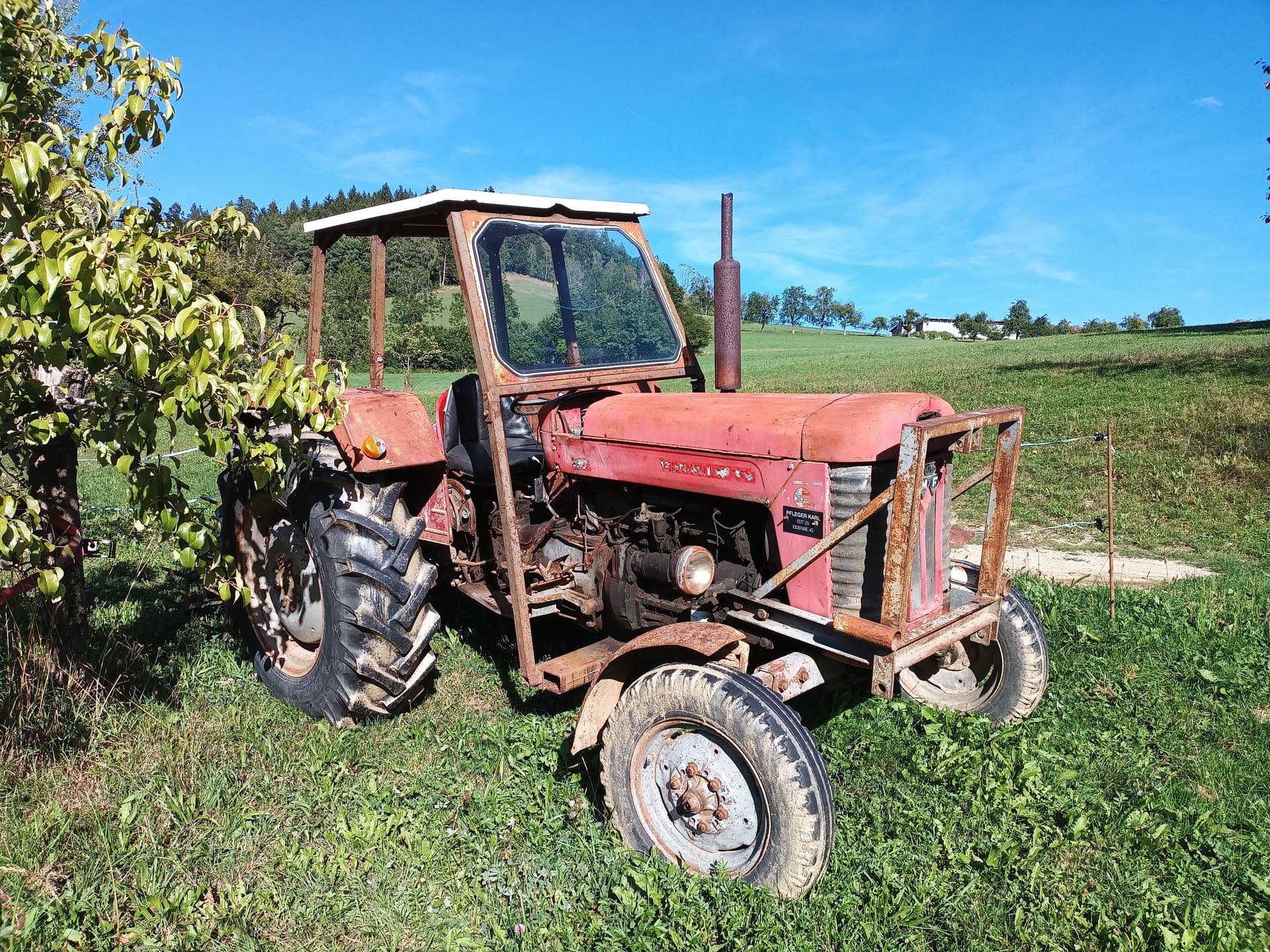

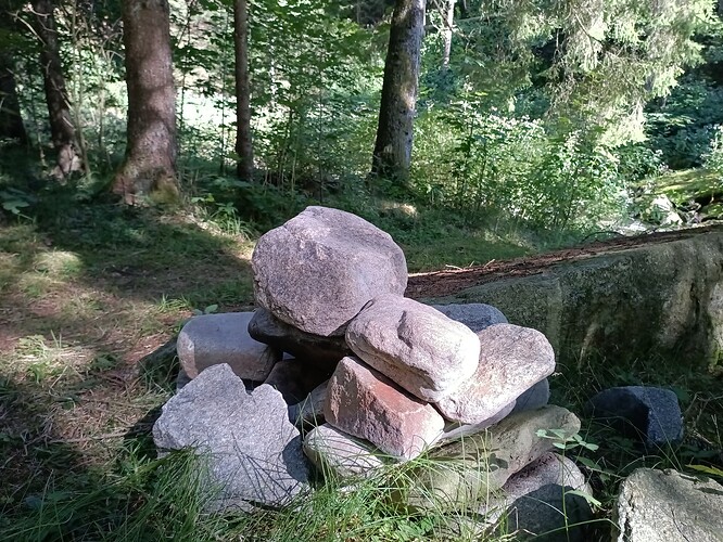

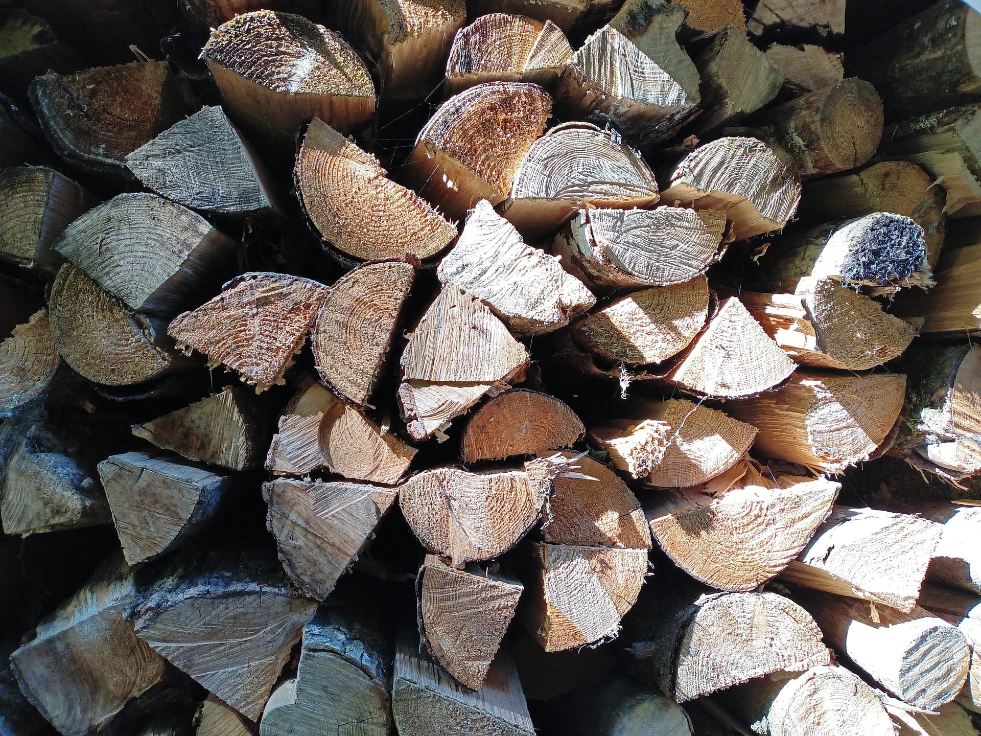

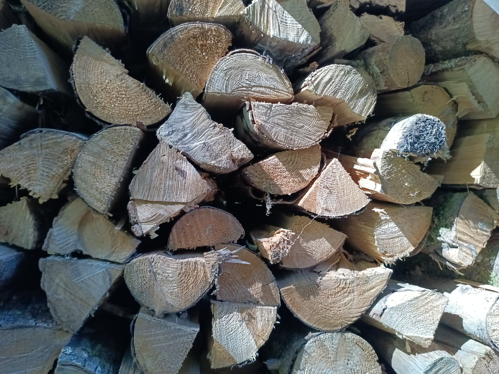

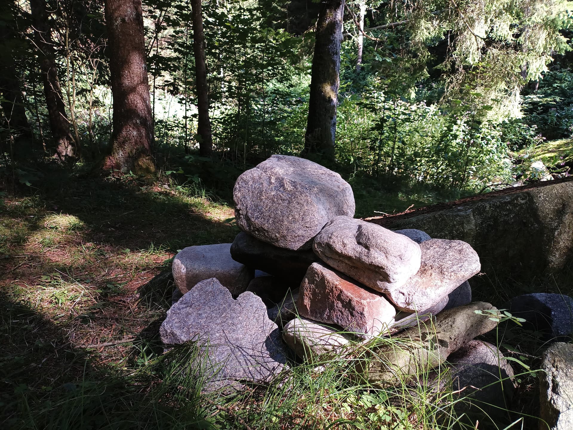

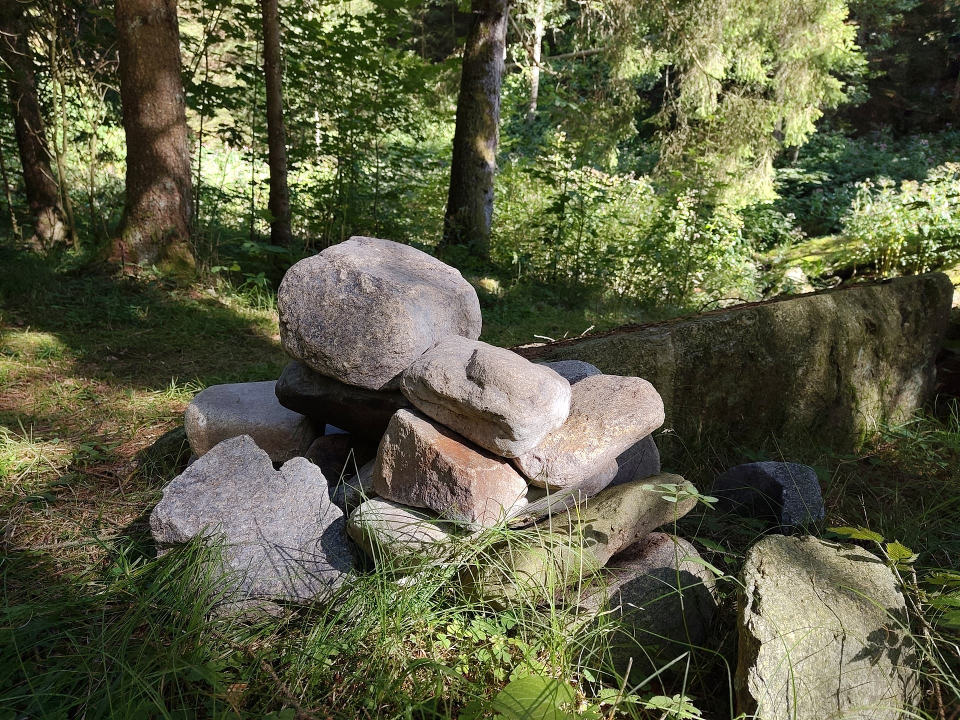

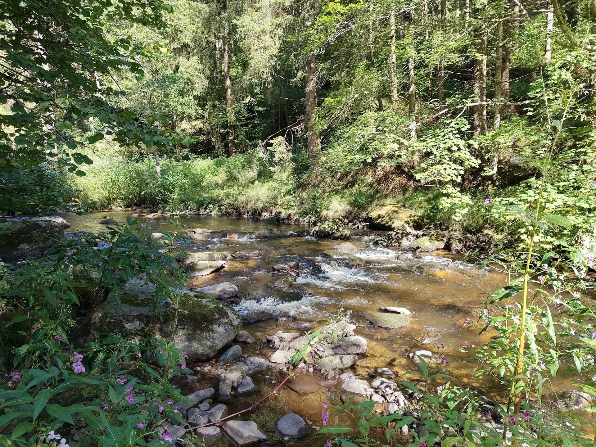

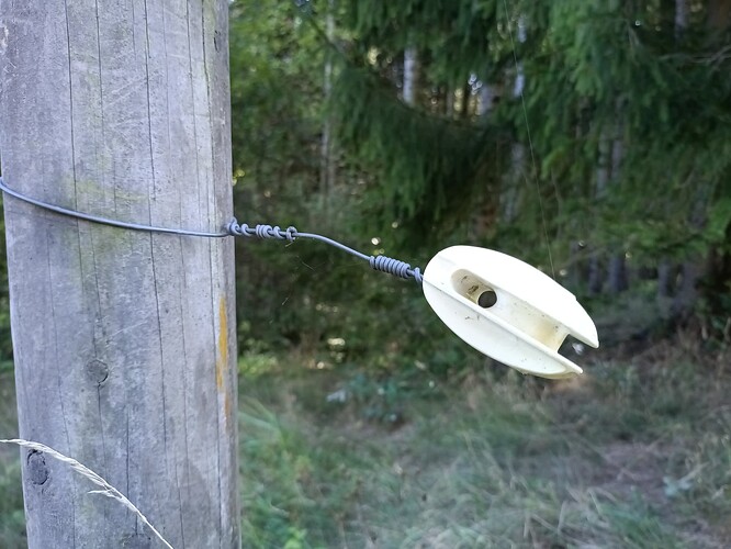

So I have taken a longish walk last Sunday, with the purpose of getting an idea, how different the phones at hand compare to each other. They were all put to 4:3, max resolution, standard mode; the only manipulation of the exposure was tapping at the lighter area, in order to “expose to the right” - if possible. The FP6 and X23 allow this, the JP2 did not react noticeably.
No post processing, I did reduce the resolution, though, as the files ware crazy big with no noteworthy detail.
The following devices were used:
FP6 - e/OS - Fairphone camera app v8.00.01.0011.2.0
JP2 - SFOS - advanced camera app 0.9.8-1.4.1.bso
Volla X23 - Ubuntu Touch (24.04-1.3) - stock camera app 4.1.1
Handling and feel:
FP6: is the fastest of the bunch. It just snaps into focus, on touching the trigger it takes the foto instantly.
JP2: Pretty good contender. Slight delay, but very capable in quickly grabbing a scene.
X23: A little slow in finding focus, but the delay from pressing the trigger to actually taking the foto takes ages (+/- 0.8 sec.) If you are around kids or animals, you will miss a lot of candid shots. I guess, this is mostly due to the weak CPU of the device.
About exposure & colours:
The FP6 tends to overexpose (even if you nudge it to ETTR) and adds a yellow-green hue.
The JP2 tends to balance out big contrasts and rather would give up some highlights, in order to save some low lights. It quickly goes down to 1/30 exposure time even in bright scenes, so camera shake is a big issue. It adds a blueish-green hue.
The X23 shots come closest to what I “saw” (or actually, what I wanted to see later in the foto)
About lens, bokeh, etc… Just have a look :wink:

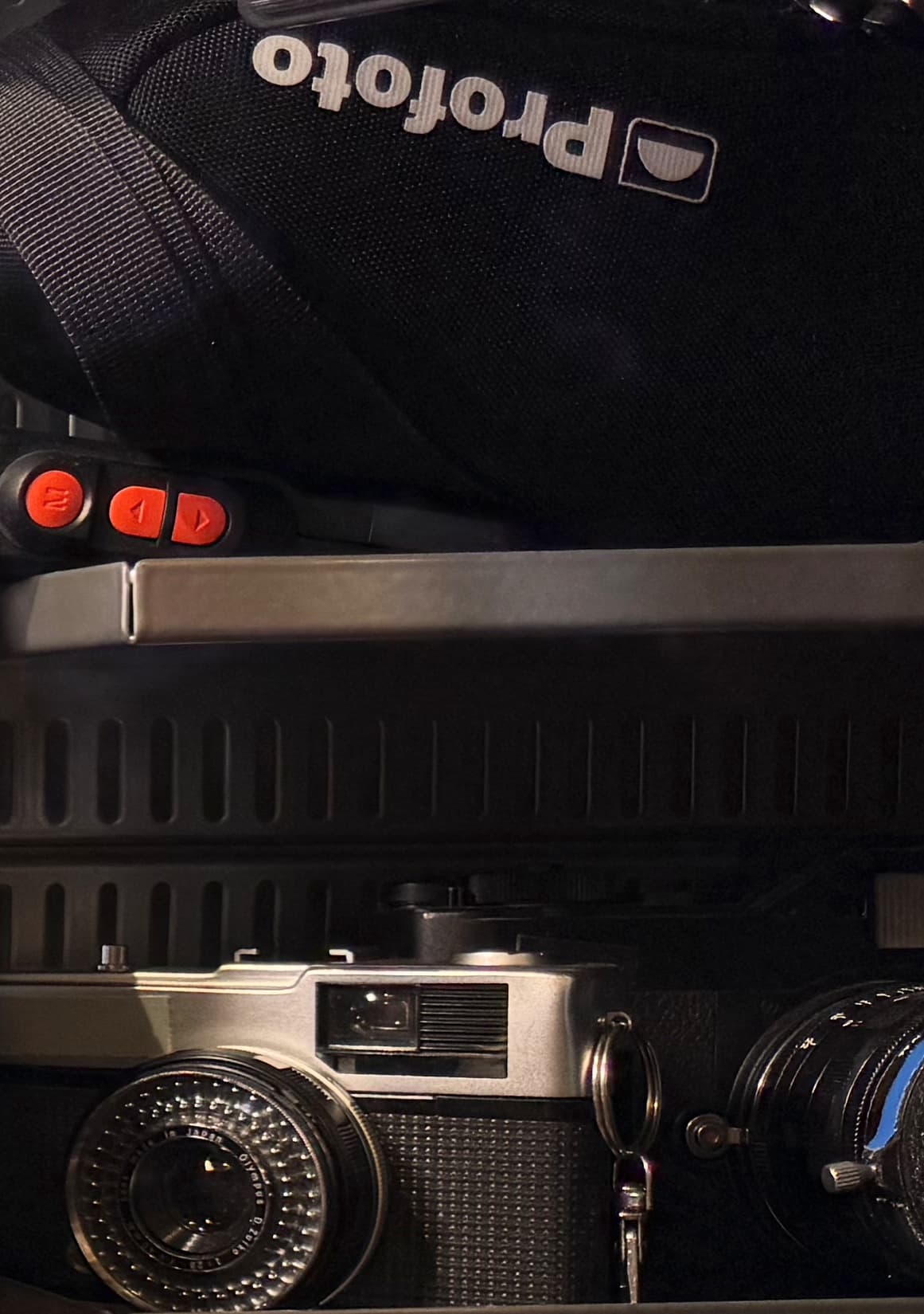

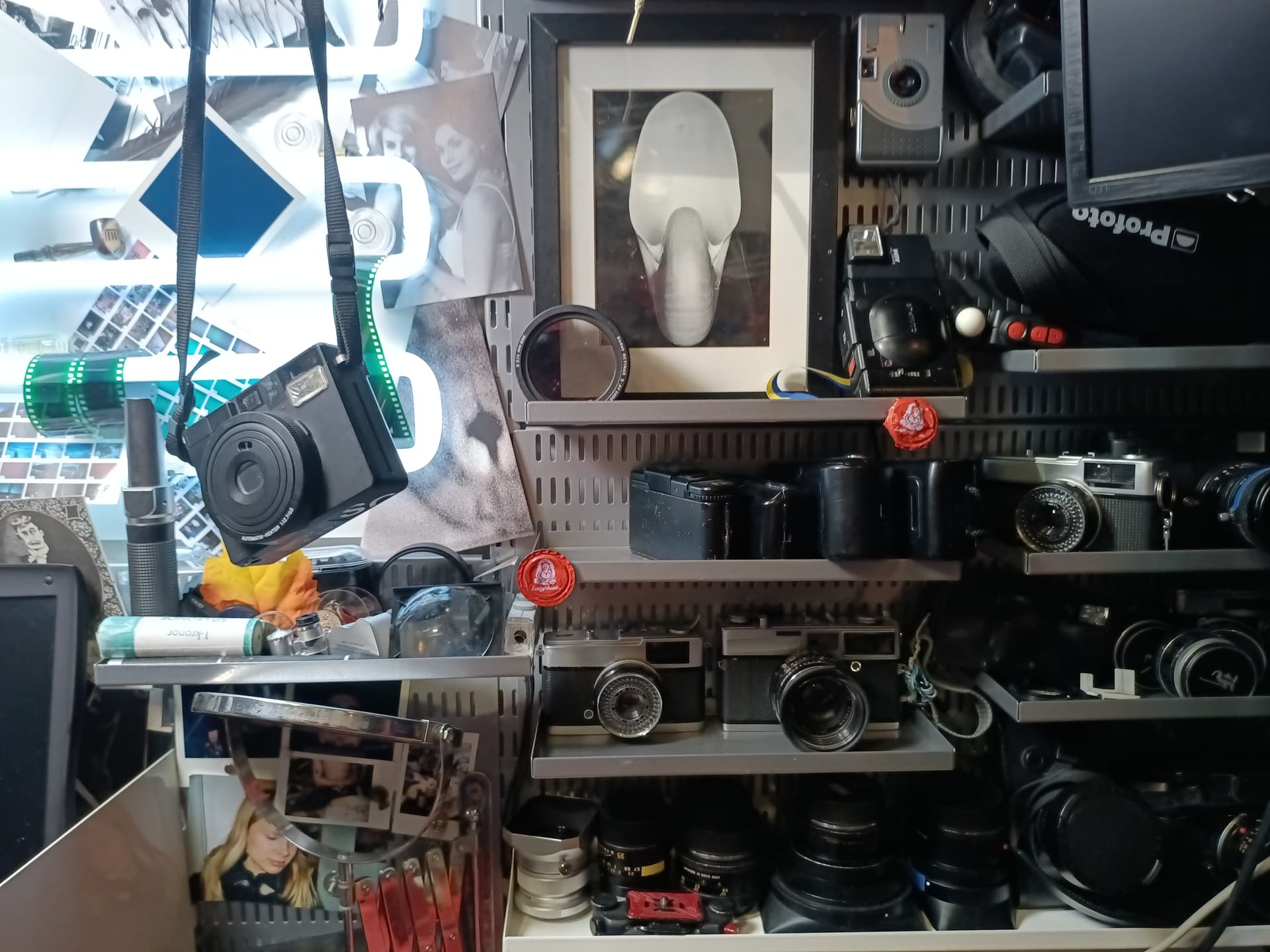

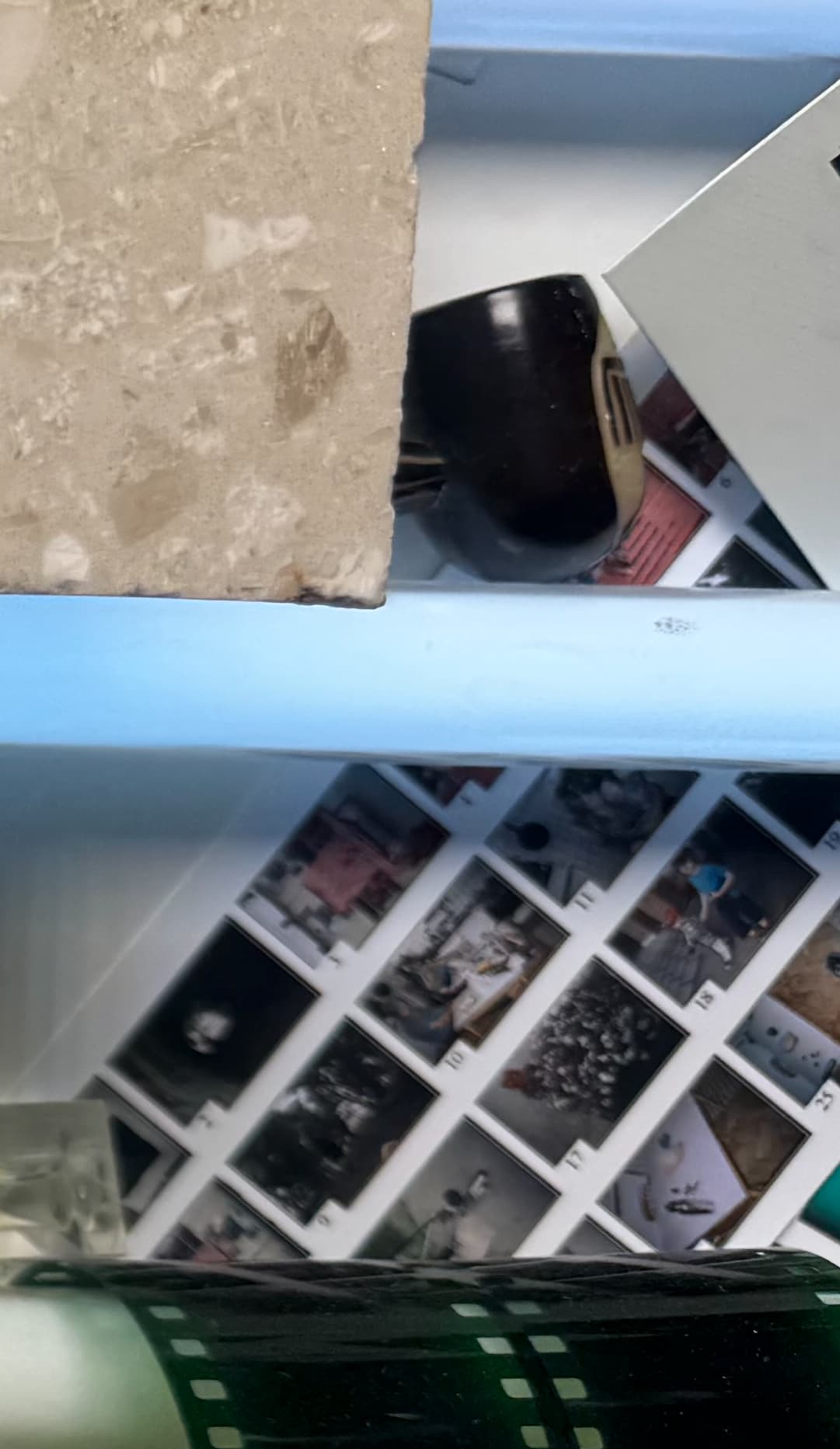

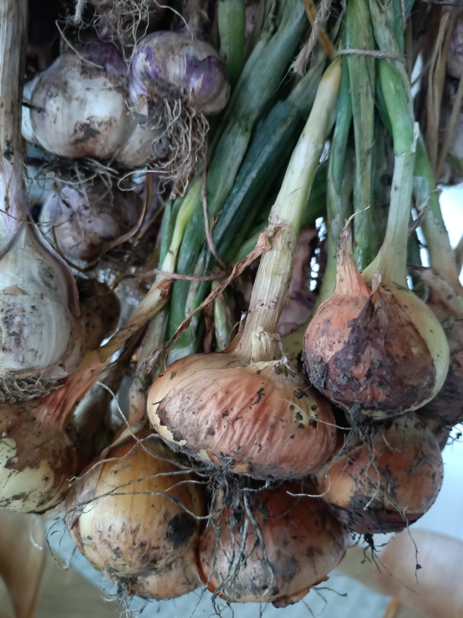

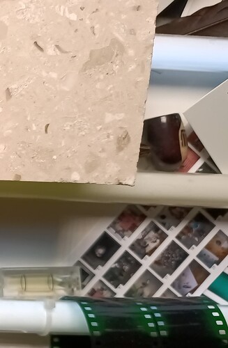

Here’s a few more, iphone (15 max pro I think) and JP2 (the Jolla pics are the first of each pair).
I would say that it’s a lot due to camera shake, the J pics are often 2-3 times slower than the iphone. 1/33 instead of 1/60 /100, which is roughly where you go from being able to handhold vs not.
In this first pic, I boosted the light a lot to see if that was the case, the iphone took it at 1/1600, the J at 1/326, and the details are closer than in the other pics.
This also tracks with my experience with Sailfish and the camera app. I have taken some amaaaazing pics with Sailfish, the 10III especially, but it was always in perfect high light conditions. As soon as it’s dim, you get soft, blurry images, long exposures, and unbelievable lag for actually taking the photo.
This is also where the iphone excels, it is insane in low light, takes incredible pictures with the main cam in the dark, and has imperceptible shutter lag.
I have no doubt that the sensor size and sensitivity are also important, but it’s clear the software is where Sailfish is lagging. The camera app has been slow and laggy since day one and I don’t think there’s ever been any big focus on it.
For me it’s no big deal, the camera is a tool you have to adapt to, and this just means getting used to laggy shots and motion, but if they could somehow at least solve the crazy random lag that would go a huge way to making the camera at least useable.
Currently I have just started always carrying a ‘real’ camera with me now, which is a nice change. The J2 really blows away other phones in being a phone, but the camera is the worst aspect of it and easily my second worst phone camera (Nokia 8110 is actually worse, although has less shutter lag).
100% crop
100%
Sure, go ahead :slight_smile:
20 characters
Dumped my thoughts on the camera here https://m.youtube.com/watch?v=uTdMMCyu0Zw&pp=0gcJCRoMAYcqIYzv
Nice Video!
How many Displays/Keyboards do you want? Yes! :grin:
I don’t know how these situations look to the naked eye, but in the first picture pair I like the Jolla Phone’s colors better. The cropped version iPhone seems to have more details on the small photo frames in the background, or the depth of field is different enough that the difference is noticeable, but overall the difference in details isn’t as huge as I would have expected.
In the second pair I still like the Jolla Phone’s colors better and in the cropped versions it seems to me like Jolla Phone has more details (the black grip texture on the camera or the fabric and white printing on the camera bag). Maybe iPhone’s post processing smooths things too much here?
In the onion picture iPhone has more detail and the colors look better to my eye.

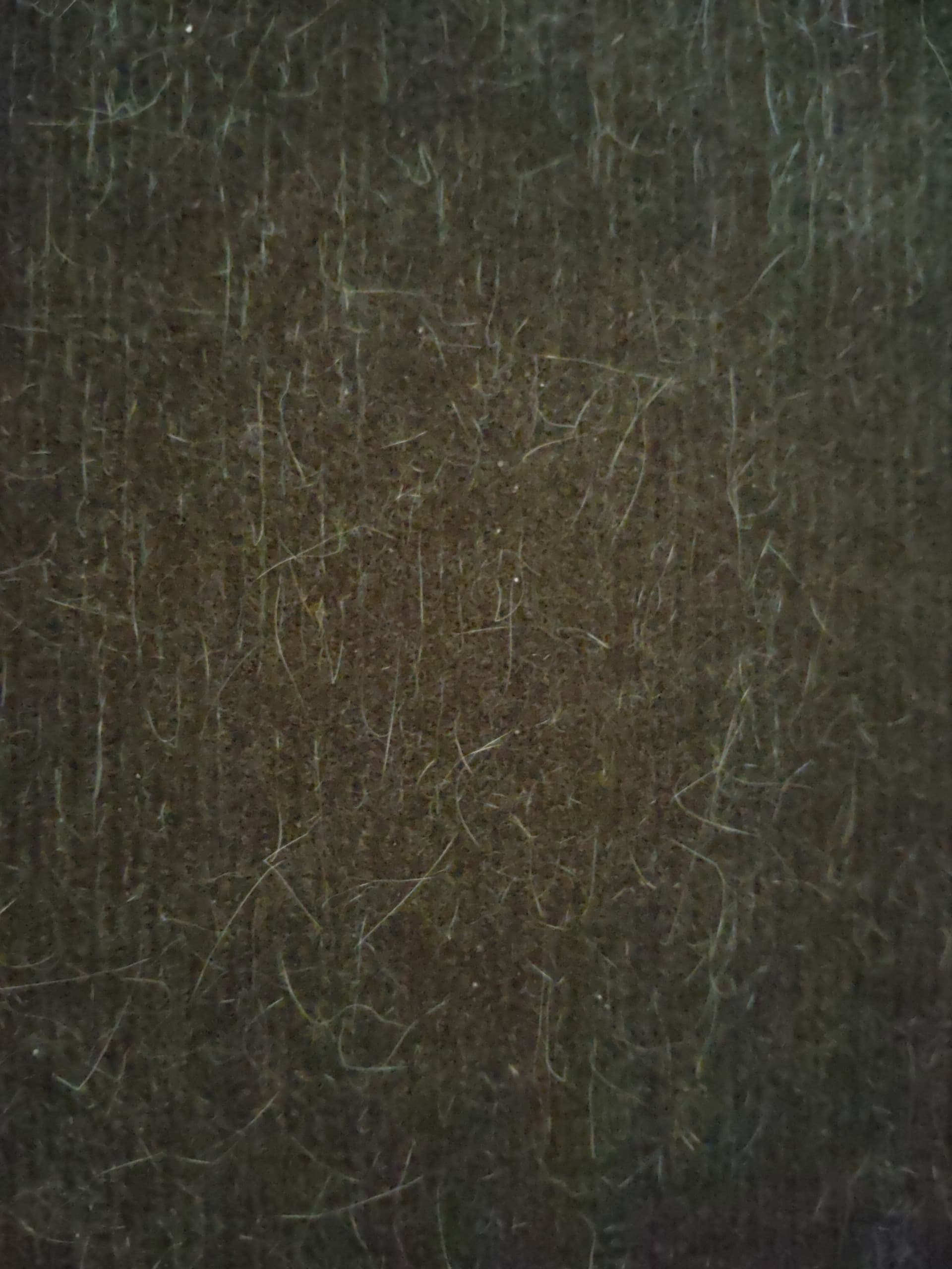

A brown carpet (with cat hair), low light.
The J2 shows a central area with a different color, which isn’t real. The carpet is uniformly brown.
10iii, from the same distance. It is not well focused here but the important point is the color gradient (not real) from center to edge is much less visible.

TOH is Inari Blue (not illuminated). The carpet is in the shadow of my own body (room light is behind me). Due to the shadow, the light is low and maybe the phone needs to amplify the signal quite a lot, therefore exhibiting what in better light conditions would be imperceptible differences.
